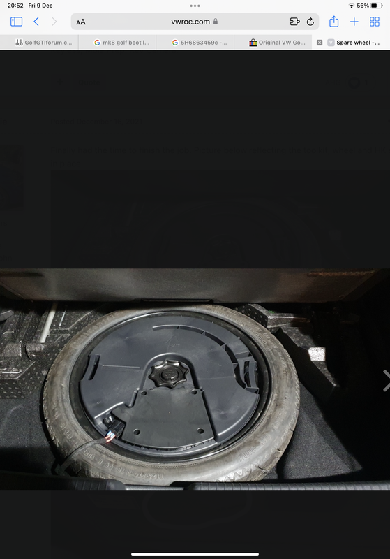

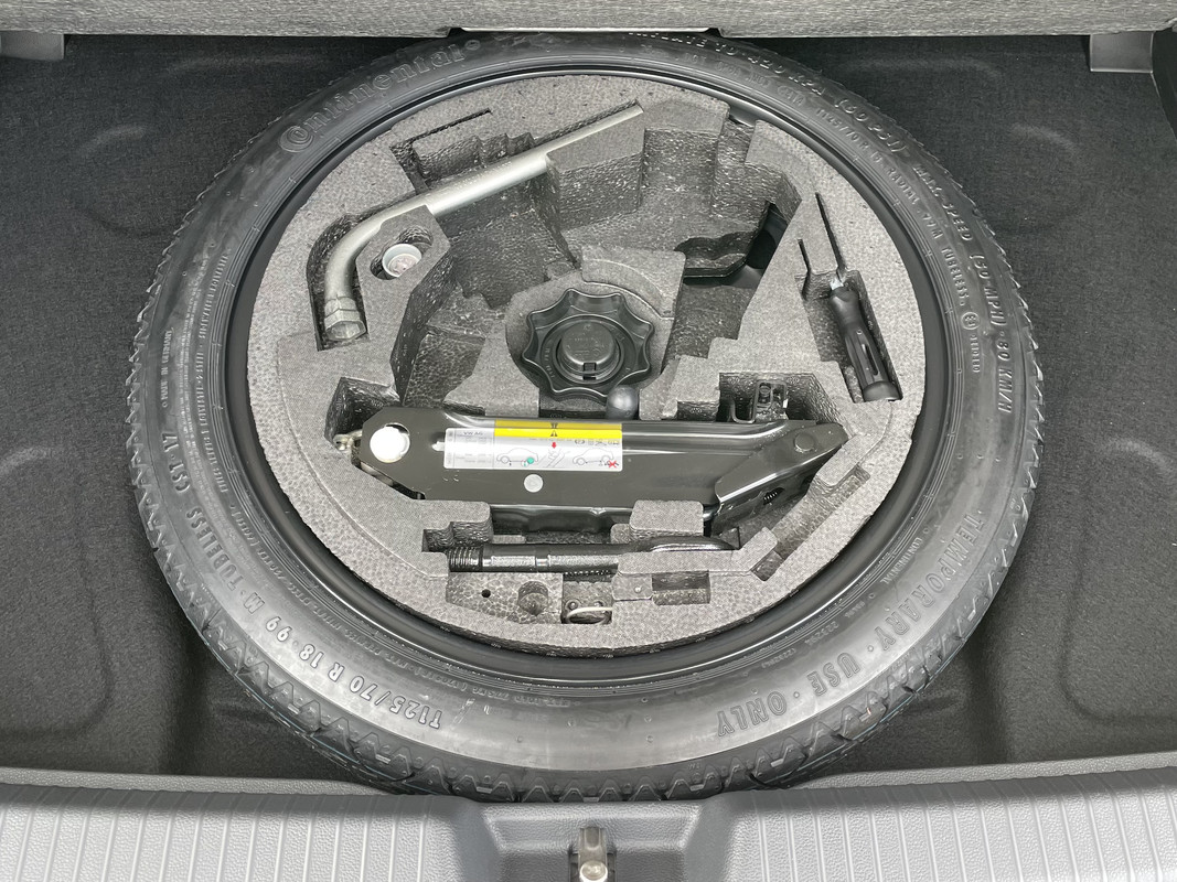

Some pics taken from the R Forum with spare wheels fitted in MK8 R’s
18” spare wheel saver
Shows with and without HK fitted
Also you can as suggested change the boot lock panel for one which has a cut out for the spare wheel
