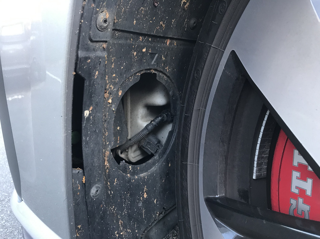

Re: Moisture in the headlight... IT'S BACK :-(
« Reply #23 on: 28 October 2019, 09:13 »
5 days after having a new headlight fitted, it's got water in again.
I drove in heavy rain on Friday and noticed on Saturday that its had steamed up again then Sunday it's as the picture.
So how is water getting in as drivers side is absolutely fine? I did a quick inspection and noticed that a round cover is missing - would this have any effect? Back to the dealer...  :angry:
This missing cover:
« Reply #24 on: 28 October 2019, 09:17 »
This missing cover:
I mean, that looks like it could be important....
« Reply #25 on: 28 October 2019, 09:37 »
Yes that is the headlight access panel... without there high speed water hits the back of the headlight mount and I'd imagine ingress is highly likely.
Nobody spotted that before???
I'd have thought to have changed the lamp unit out they would have used that panel?

« Reply #26 on: 28 October 2019, 09:45 »
Cheers Fred, I think that the panel might have been missing for some time. But they did not mention this last Tuesday.
« Reply #27 on: 28 October 2019, 09:54 »
How can a main dealer return a car to you like that, especially as it went in for the headlight?!?!? at the very least I'd have thought they'd try to charge YOU for a replacement! :laugh:
I've noticed on mine it is pretty quick to steam up along the bottom of both headlights but to be fair it dry's out after half an hour of the lights being on..... mind you I'm not driving around with a huge hole in my inner arch!! :grin:
hopefully that replaced fixes your issue, question is who does pay???

  • Posts: 2,388
« Reply #28 on: 28 October 2019, 10:01 »
Yes, can't believe they didn't mention it. You can only really see when the wheel is turned. But I've just checked some pictures a few days after the car was delivered and zooming in you can see that it was actually missing from new.
« Reply #29 on: 28 October 2019, 10:12 »
I have just experienced this, went to the dealer and they informed me that it is a “common” thing. They said if it gets substantially worse and actual drops of the water are forming and running down the inside of the headlight they would replace them. But at the current condition they won’t replace the, through warranty.
