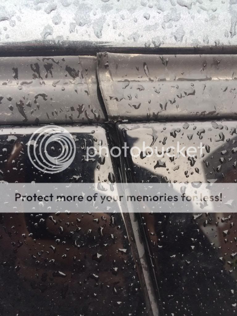

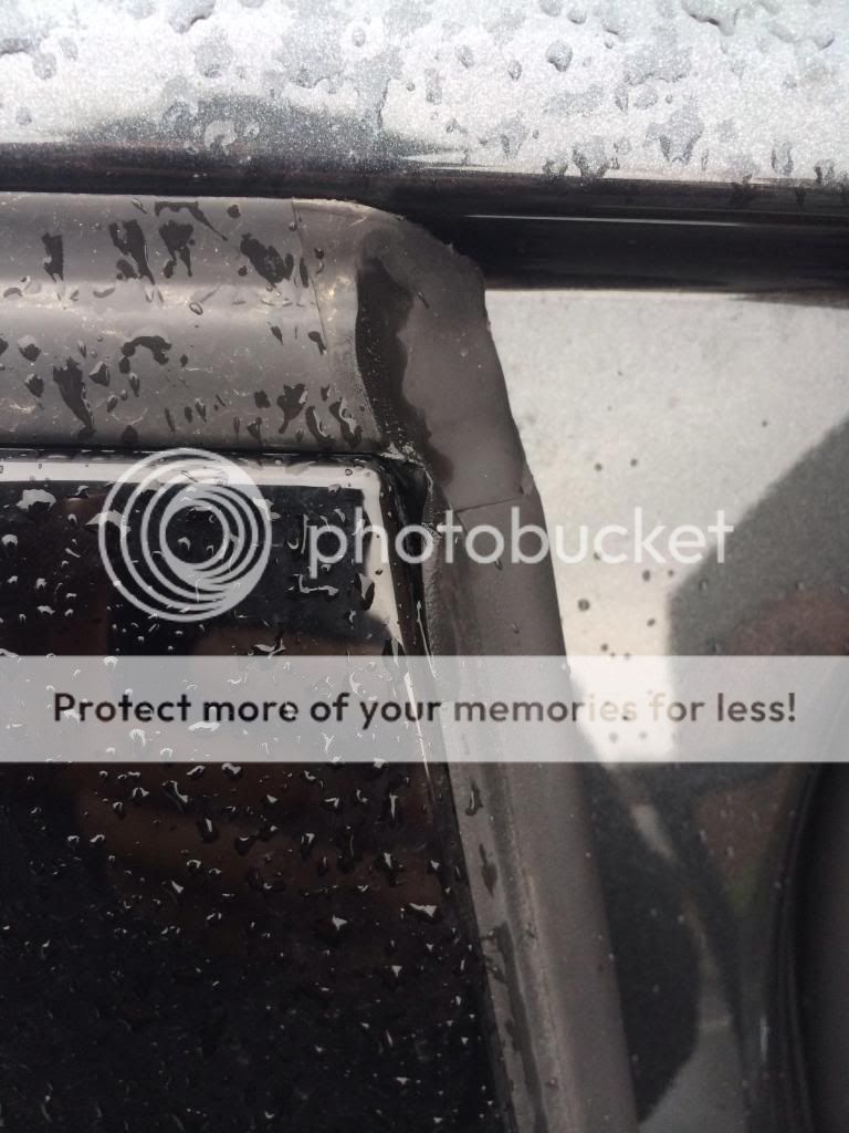

Going back in next week for rear door weather seal (photos below). The front door seal has been wearing the rear seal and now it is actually pulling it away and under the front door frame. Hopefully you can see from the photo where the seal is tucked under between the gloss facias.

Fabio: Looks like your front door has dropped back a bit on its hinges. I had the same thing which was fixed a few days ago. There was a tiny snagging of the rear rubber on the front door, and the front rubber on the back door, at the top of both doors. Your doors look much closer together than mine were, and my rubbers suffered no damage.

Yes, diagnosis is that drivers door has indeed moved back on its hinges. VW service can't do this as to undo the door bolts will crack the paint voiding the corrosion warranty, therefore the car has to go to an approved bodyshop for 2 days this week so they can do the whole job of re-aligning both doors, fitting seal and re-painting hinges and bolts etc...

Interesting - mine was in for 3 hours, but the rubber seal was undamaged on mine and it was a quick adjustment of the hinges - i'd better check the paint around there! My rubbers were only just catching, it was a tiny overlap, yours looked at lot worse on the above photos.
