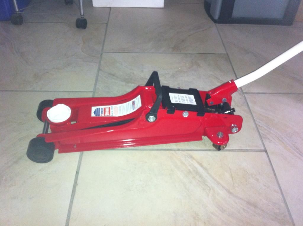

So now I can get under the car I can read the gearbox code.
Aug27081
