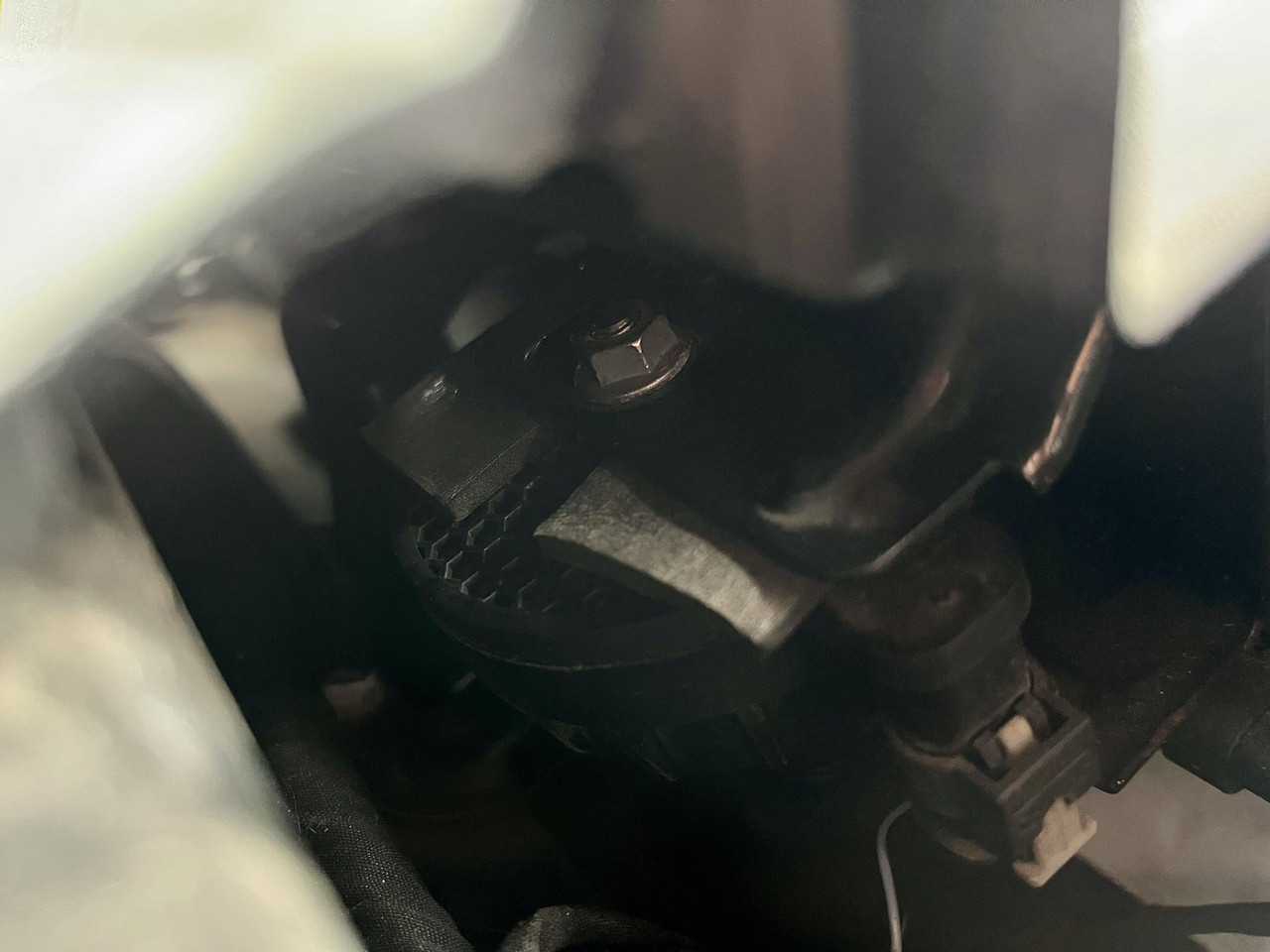

Soundaktor was rattling the dash like mad so wedged some foam under the bracket with the help of this forum and Youtube.
Just about managed to wrangle the bolt without removing wipers - fiddly! The bolt was also finger loose at first which explains the rattle  :shocked:
Controversially I like it on as with the music turned up to 11 at least I get some feedback.

Any links to the guides mentioned?
