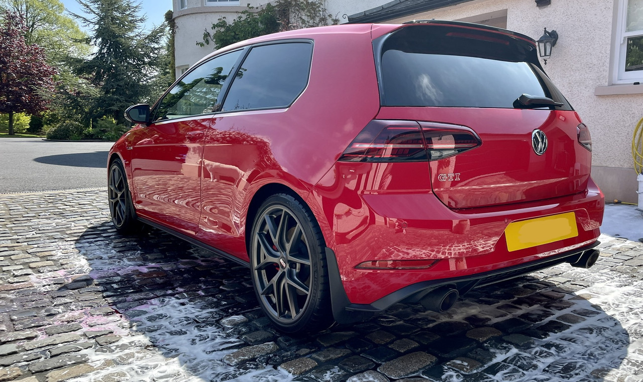

After 3 weeks and 1,000+ miles, I finally caved and washed the car as I've been too busy ceramic coating other cars to see to my own. The interior can wait for another while...
