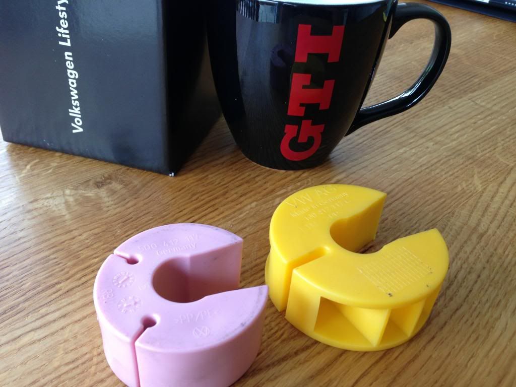

Been following this thread with great interest, but unfortunately haven't had time to do anything about it until yesterday.
As I'm sure a lot of you already know, I haven't been very complimentary about the the ride quality of the 19" Santiago's and DCC since picking up the car.  I even relayed my concerns with regards to the "Shocking" ride quality with the sales guy during his follow-up courtesy call, but he just put it down to the larger diameter alloys.
I wasn't convinced, so like a lot of you on here I jacked up the car to have a look see myself... And low and behold no surprises as to what I found?
To cut a long story short I was straight round the dealership to have a polite word with the Service Manager, who was "Horrified" to say the least and truly apologetic. They had a bit of Managers meeting in the service bay and within 15mins I was back on the road with a sincere apology and a promise that there would be an investigation as to why this should have happened. To be fair to the dealer the PDI was not done on site, but by another dealer in the area so they weren't entirely to blame.
Best excuse he had was that the design of the transportation blocks had recently changed. They were originally yellow and much larger in size and use to sit 'outside' the strut sleeve so were easy to spot. The good thing is, the car handles so much better now. The ride quality on the 19"s are no longer a problem.... in fact they feel no more different to the 18"s on my Mk6 and I don't have to negotiate speed bumps at a snails pace anymore.  I can also notice a 'Big' difference when switching modes on the DCC which I couldn't before... Now I can actually feel the DCC working I really think Its money worth spent and definitely work speccing if money is no object. It feels like a totally different car!!! To top it all, got given a nice GTi mug as a goodwill gesture and a note placed on my record for future warranty issues.

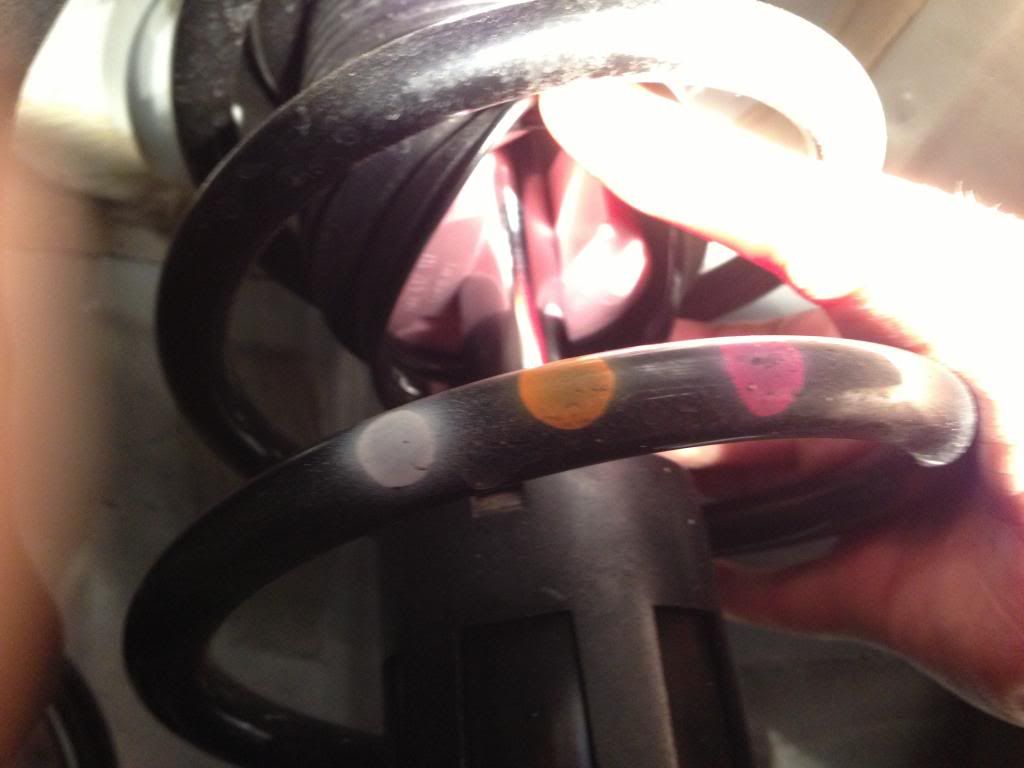

Three in both front springs none in the rears...
What are the three mate? The pink pucks, the ones in the springs and whats the other one?
Offline Sootchucker
  • Posts: 2,349
Re: Steering Rack / Suspension Squeak
« Reply #117 on: 28 September 2013, 11:47 »
Three pucks in each front strut Jimble, located in the shocks upper piston (behind the rubber boot), can be either pink or blue. Nothing else fitted at all -front or rear.
Apparently the top one is the hardest to get at and so easily missed. It seems to be a trend that two out if the three pucks are removed on PDI, but the third missed.
I guess with the other two out, the third top one gradually shakes its way down to the bottom of the piston to become more visible ?
