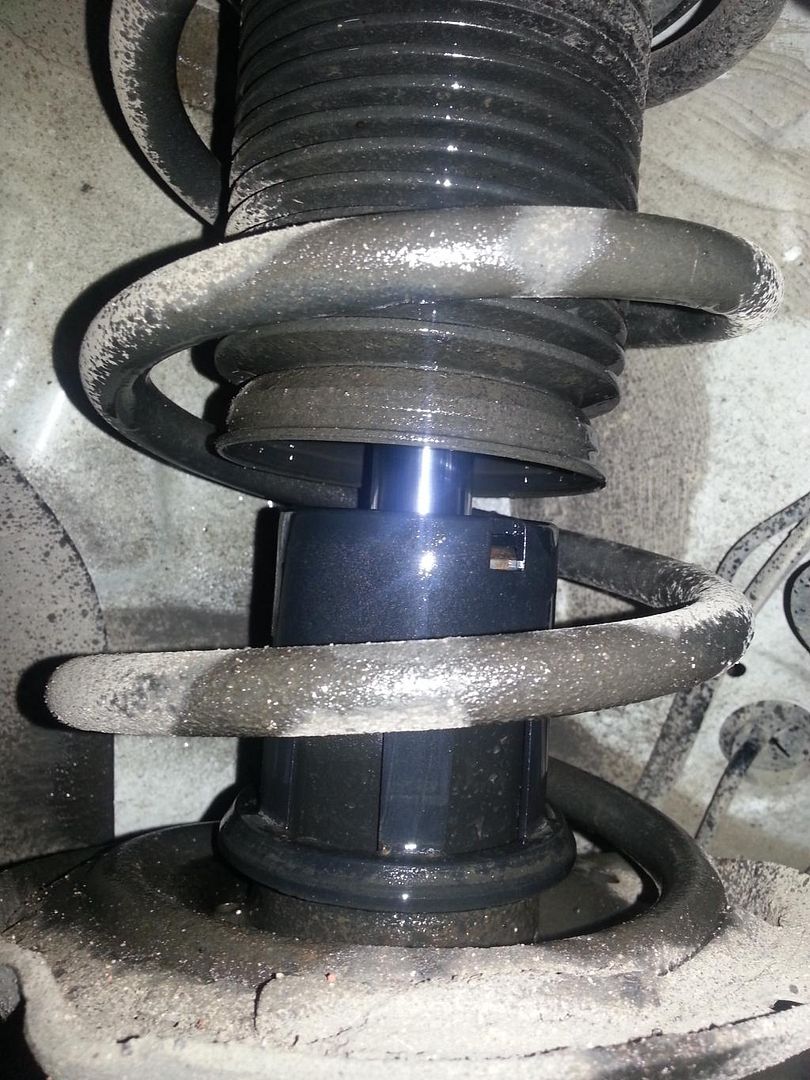

Suspension squeak now solved. Happy bunny.
Just wanted to share the TPI (Technical Product Information) code number for this fault:
2035958/4 (release date 15/4/2014)
This is the one where the shock absorber cover (aka gator) has come away thus causing squeaking/creaking/chafing noises from the front suspension at low speed and manovering.
If you're suffering the same problem get your car into the nearest dealer for warranty work.
Old subject I know but are my gators not supposed to look like this lol?

Yeah I think they look fine. It's when they come away from the top that's the issue.

Aw really :angry: there goes that theory
 I still have a squeak coming from my front right and I've already changed my top mount to no avail and I'm sure it's getting worse!

Have you tried greasing the CV boot rubbers? My car creaked until dealer greased mine. Noise hasn't returned since. Could be worth a try and at the very least it will eliminate them if yours still creaks afterwards.

I'll give it a go mc thanks
