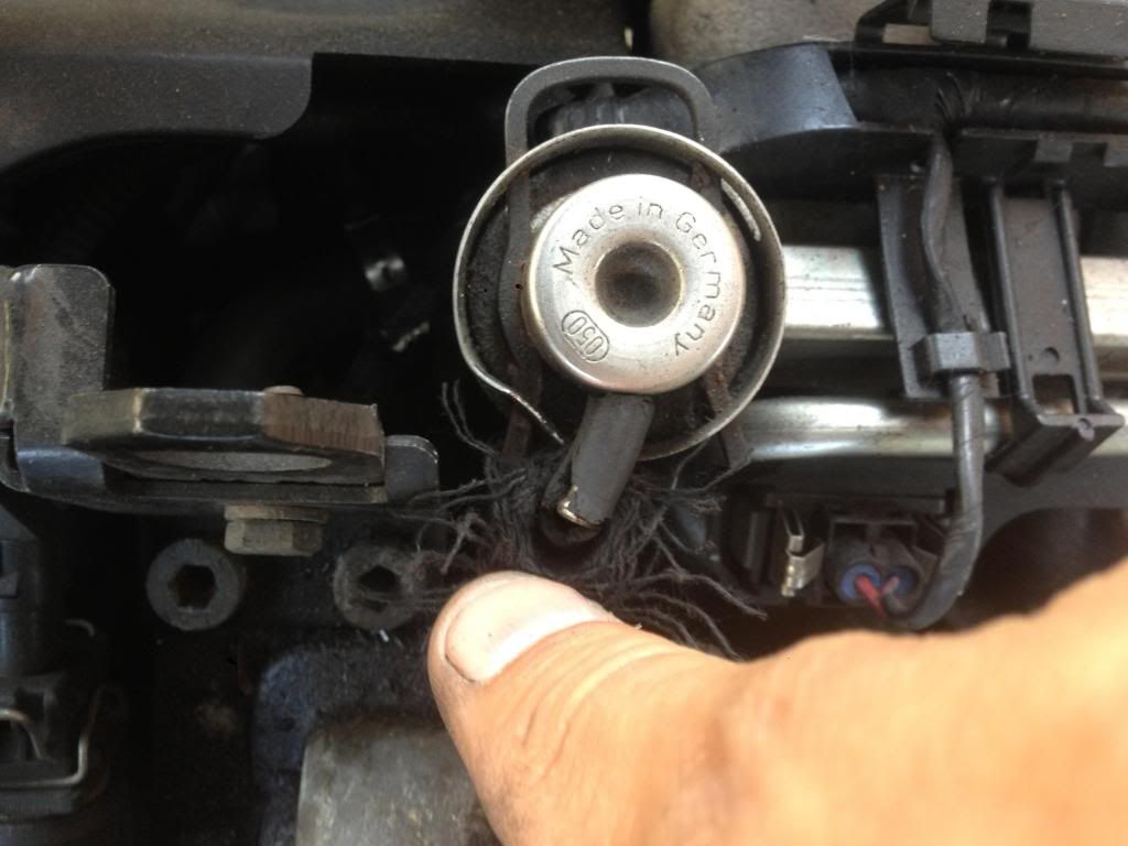

Just found a split in this pipe

Vac line for the Fuel pressure regulator
Change ASAP

Fuel pressure regulator, get the pipe replaced with 3mm silicone vac pipe along with the pipe going to your dv asap

When you say back to the DV!! I can only see it go to the bottom of the inlet?? It's about 6 inch long

yes, replace that, and the one from the dv to the metal pipe too.. the matal pipe should have two rubber pipes on each end, one to the dv and one to the manifold

So 2 bits about 6inch long

What would it have done if I hadn't have spotted it

Just buy a meter of it of the bay
Will be messing up your fueling and causing a vacuum/boost leak
