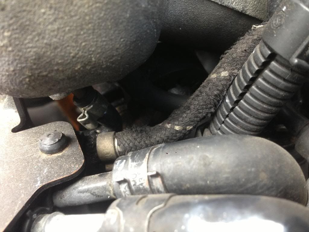

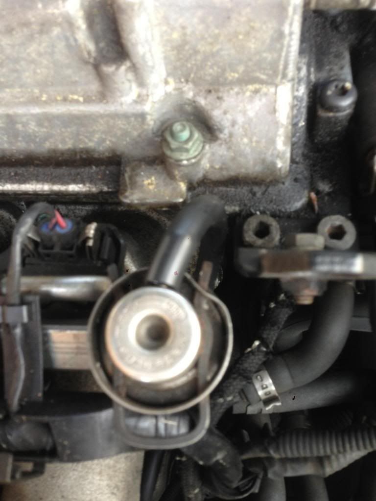

Right changed the regulator pipe
Jamie is this the other pipe your on about
jamie16v
Guest
Re: Can you tell me what this is/what it does
Reply #11 on:
30 June 2013, 16:22 »
Bloody hell that was fast, yes, that pipe and the one next to the one you changed for the fpr ( under the inlet mani)
jamie16v
Guest
Reply #12 on:
30 June 2013, 16:24 »
Follow the metal pipe you took the dv hose from and it'll lead you to the pipe I'm talking about!
150+
GTI forum regular
Posts: 186
Reply #13 on:
30 June 2013, 16:31 »
Ok...it's abut hot under there ATM
Is it the one with the material round it or the on beyond that, that u can just see the one time clip thing??
I have a motor spares shop open 7 days a week
2 mins from me
150+
GTI forum regular
Posts: 186
Reply #14 on:
30 June 2013, 16:33 »
The one from the DVD seems good plus the pipe I just got wont fit over the metal pipe!!
And the other 2 seem ok as well
jamie16v
Guest
Reply #15 on:
30 June 2013, 16:36 »
It will if you stretch it!
150+
GTI forum regular
Posts: 186
Reply #16 on:
30 June 2013, 17:02 »
Fooking hell!! That was a hard pipe to stretch!! I've only been able to get it on about 8-10mm Over the metal pipe do you think it will hold??
Last Edit: 30 June 2013, 17:06 by 150+
jamie16v
Guest
Reply #17 on:
30 June 2013, 17:38 »
10mm should be plenty, as long as it passes the barb. A bit of spit would have made it easier to slip on.
150+
GTI forum regular
Posts: 186
Reply #18 on:
30 June 2013, 17:44 »
Cool
