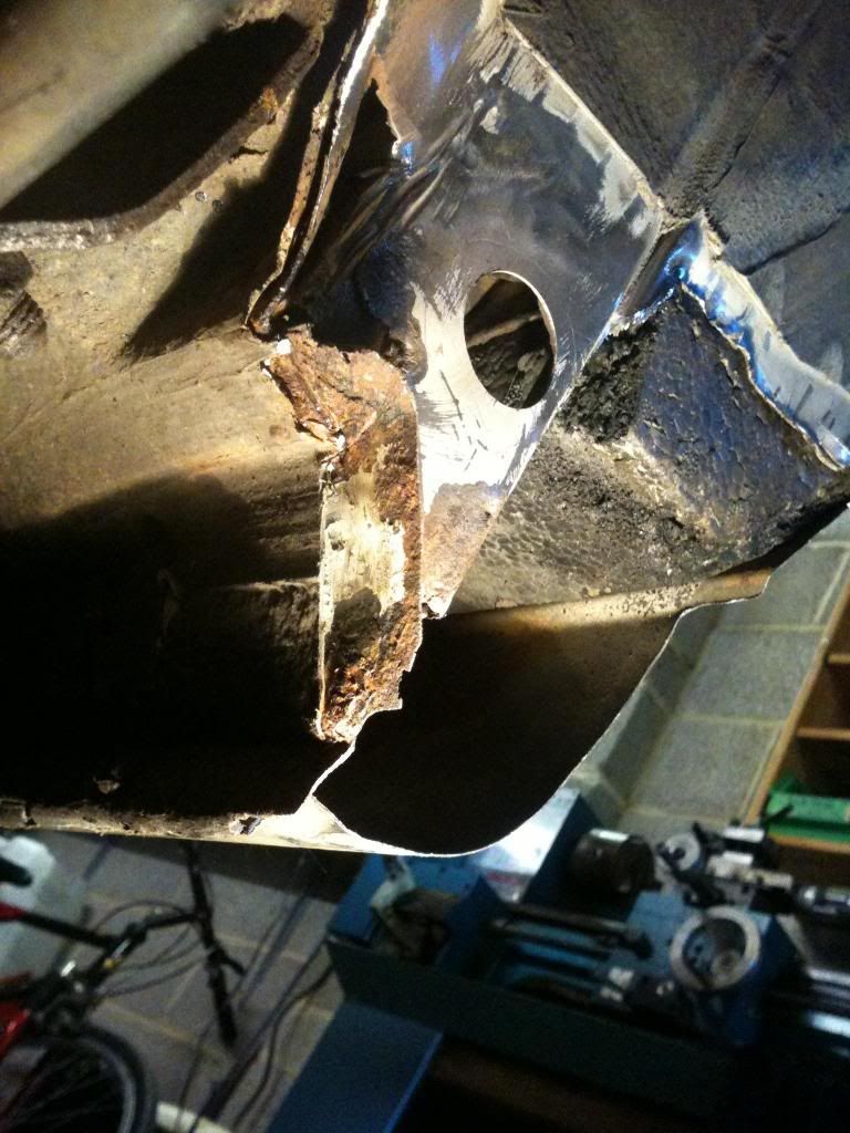

So this weekend I've been sorting the ol' worms out.
After taking the metal back further I ended up with this

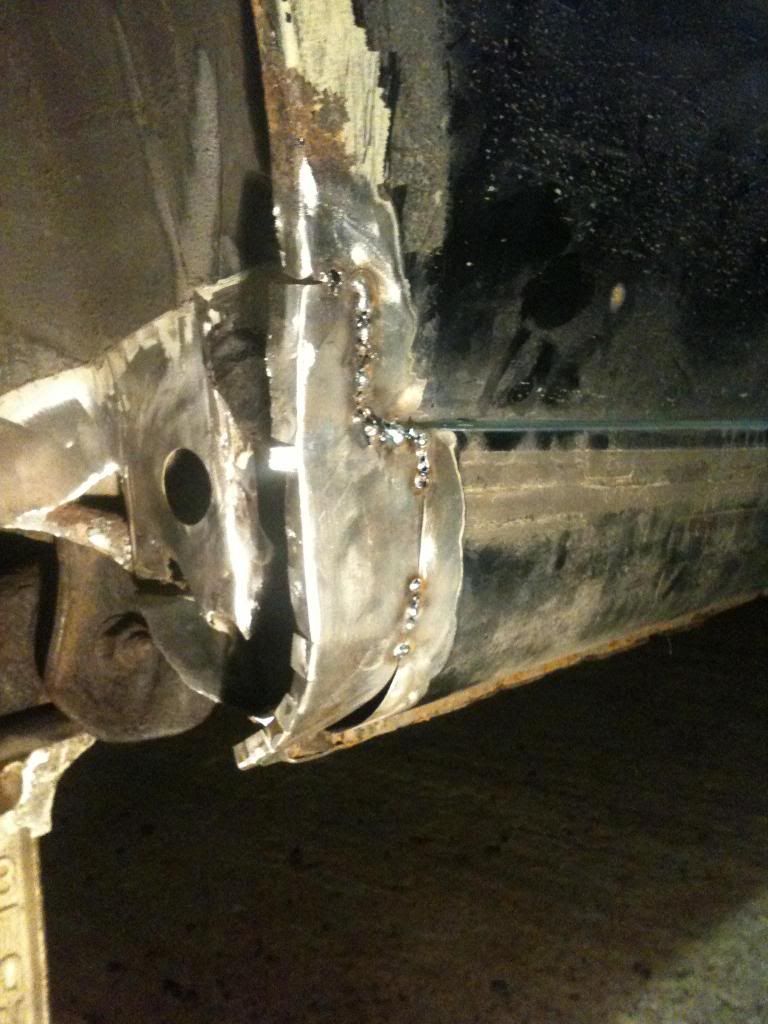

and the back of the sill was shagged so I decided to cut part of the sill back
and welded in a new section I made up (partly tacked on in the picture)

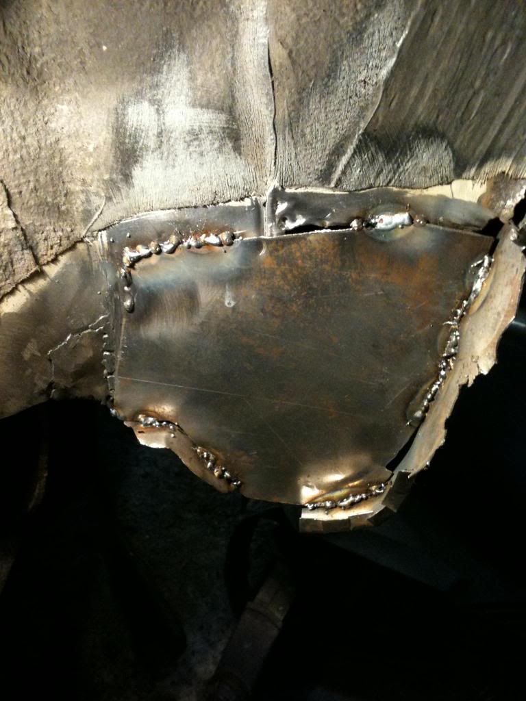

I made up and tacked in the new section in the wheel arch
and have finished welding it in, treated it and am letting the treatment dry so I can paint it and waxoyl it tomorrow.

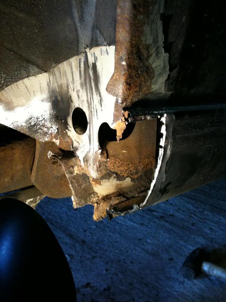

When taking the sill trim off I also found this (just below the back of the driver's door)
so I'm going to cut that out and weld a new section in.

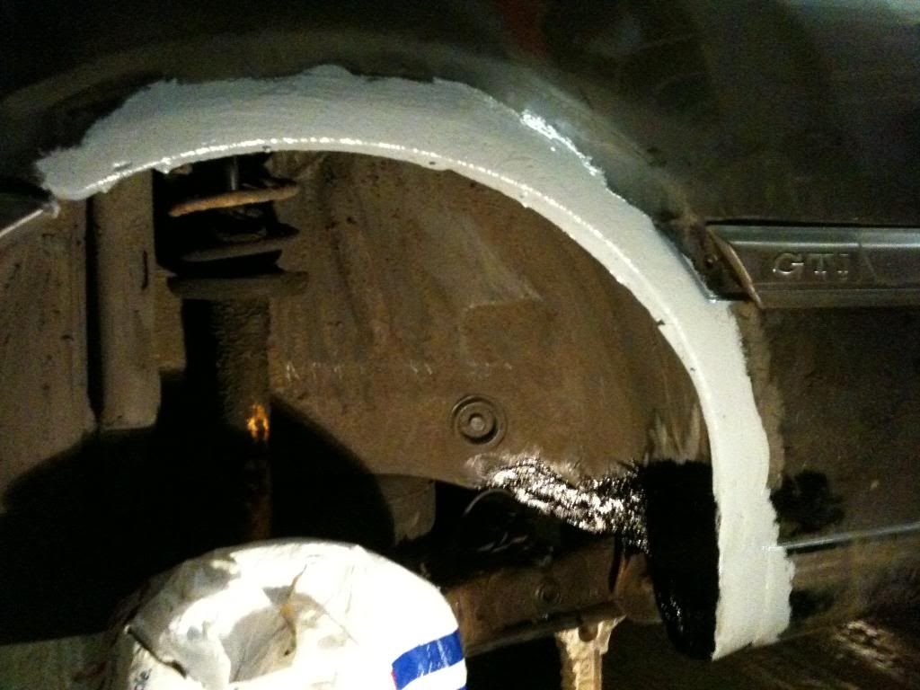

Stripped some paint back on the wheel arch and chucked some Kurust on it.

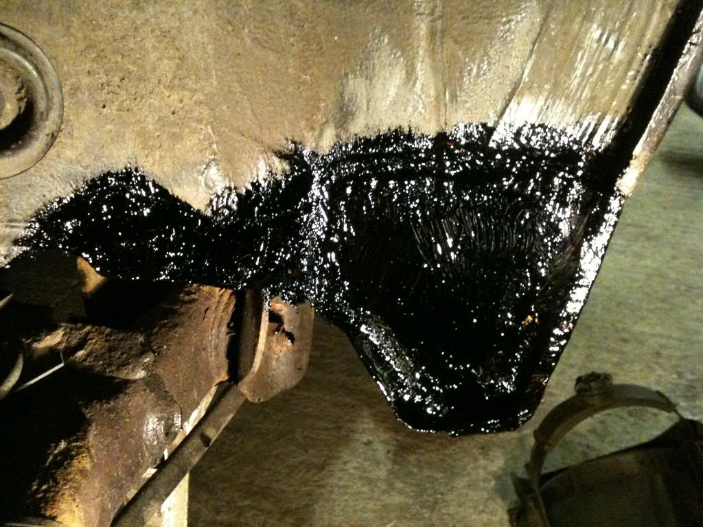

« Reply #29 on: 14 May 2013, 12:12 »
All welded in and sealed!
Put some anti-rust primer on the external metal and arch so I'll rub that down later and spray it.
My shocks turned up today too so I'll get those swapped over tonight/tomorrow, then it's just the ABS to do!
