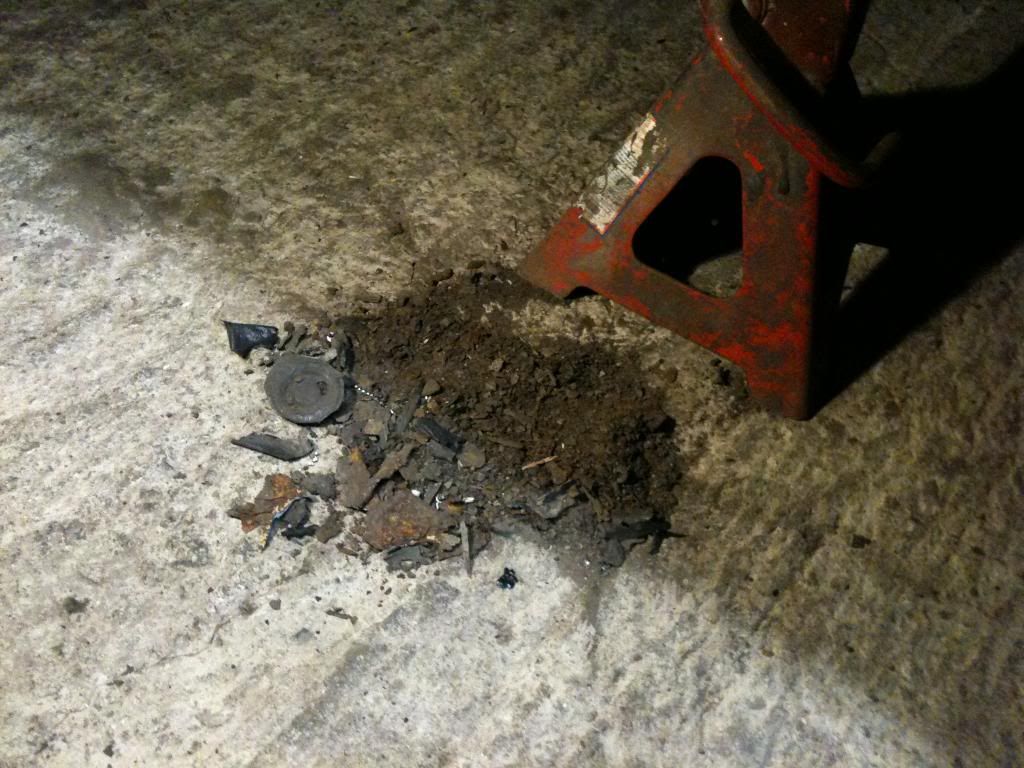

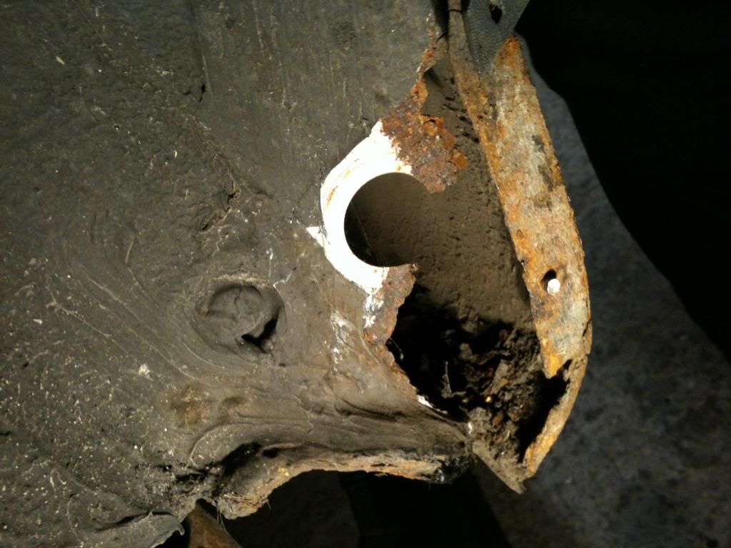

Had a good old poke about this evening. On first inspection it didn't look too bad, but then I removed the sill trim and some of the waxoyl and starting poking some more and found this...
..then I removed the arch trim and found this...
...and this is what came off of the car...
So I'll cut it back and weld some new steel in there over the next few evenings. Fun.
