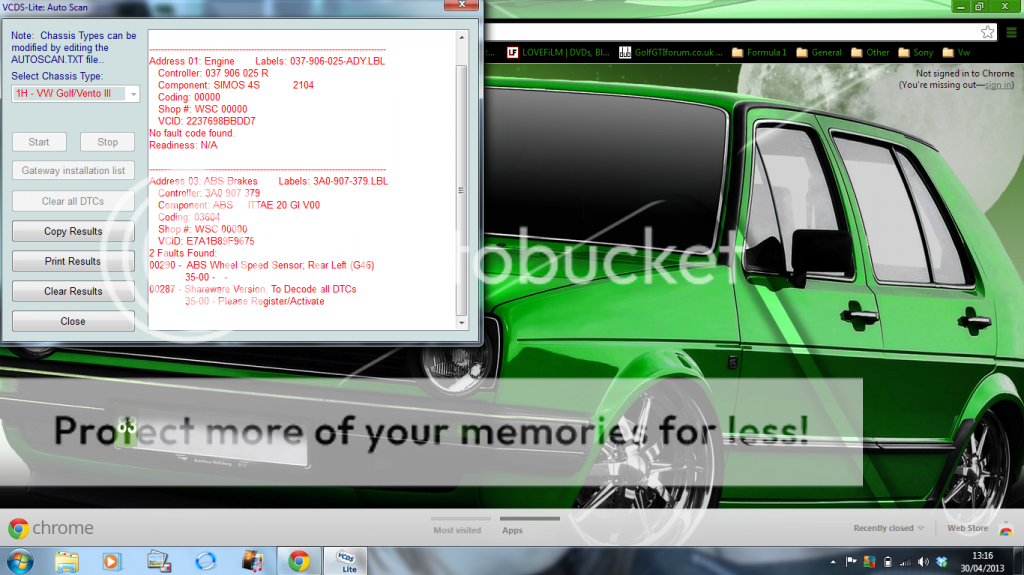

Unit i ordered saturday turned up earlier  :smiley: just fitted it and suprise suprise abs light and handbrake light still on quick scan and Now this
i give up!!

might sound stupid but did you clear all the codes after fitting the new stuff??

You dont even need to clear the codes i didnt need to but i scanned with vagcom all codes dissapeard im sorry to hear about the abs ecu i hope you get it sorted mate
Cheers mate another one turned up too so two spares  :grin: going to take the original fitted one apart i think and have a look got until july for the mot to sort this  :grin: :whistle:

You do need to clear codes. Even once repaired the codes stay on. They may clear after a drive but initially, code will still be there.
