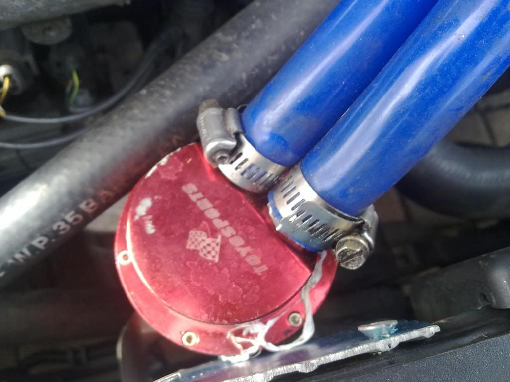

so how do i get it to work
all you can do really is cut it open and stuff it full of wire mesh and wire wool although you need to be careful of the woll beings sucked into the intake
the bottom of it screws open so do in put the mesh in fist then wool

whats that disc thing? prety sure i dont have it..

I haven't done it before so you will have to have a look and figure it out but i would think that you want to put some mesh in first and then some wool and the mash will act as a filter to stop the wool going into the intake. (Depending how course they are)

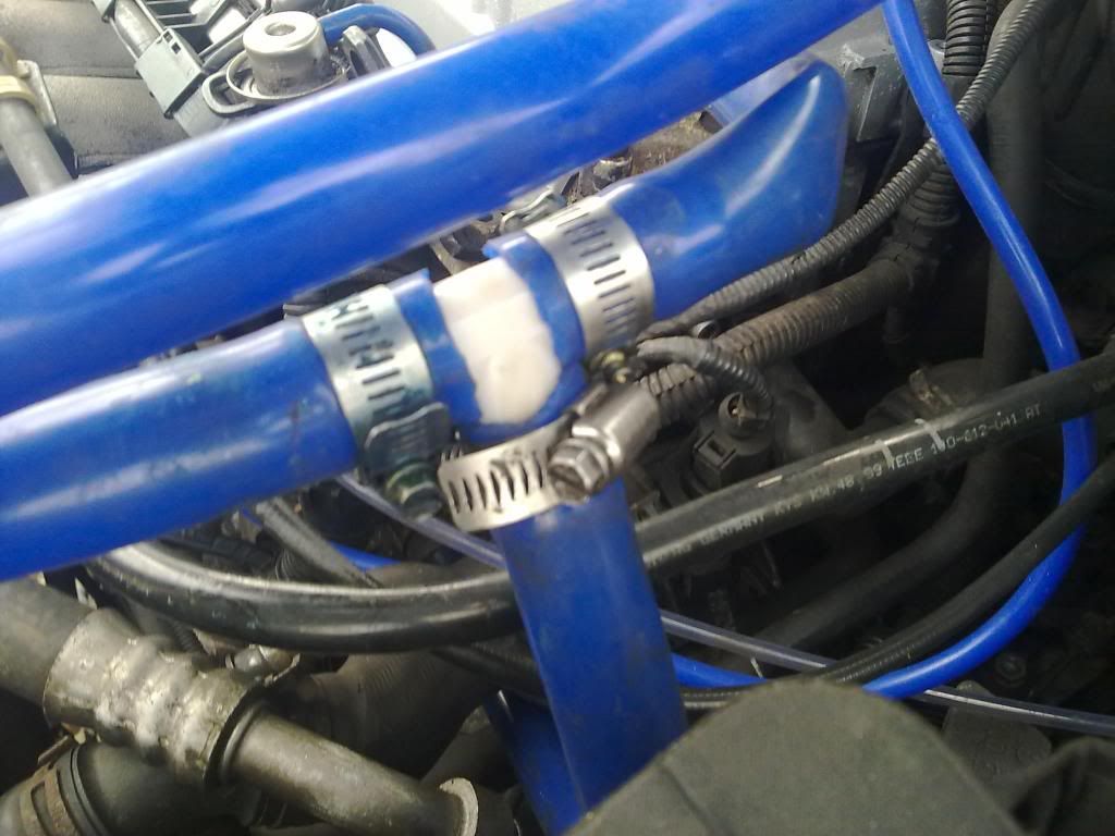

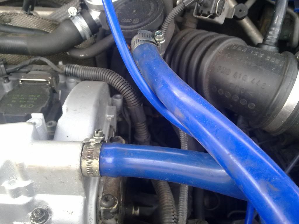

Prob doesn't help that
1) there as a massive kink in one of the pipes
2) you left the pcv valve in there
Or am I imagining things  :undecided:
there is in the pic but i have fixed it what do you mean by the pvc valve

This part should be removed and the pipe goes straight into the elbow

« Reply #19 on: 14 April 2013, 20:59 »
And then block the vacuum pipe off (top one that goes to the mani)
