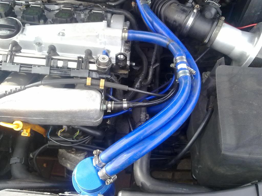

And then block the vacuum pipe off (top one that goes to the mani)
like this

top one get blanked and the blue hose goes straight in

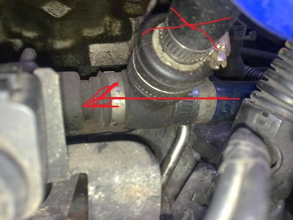

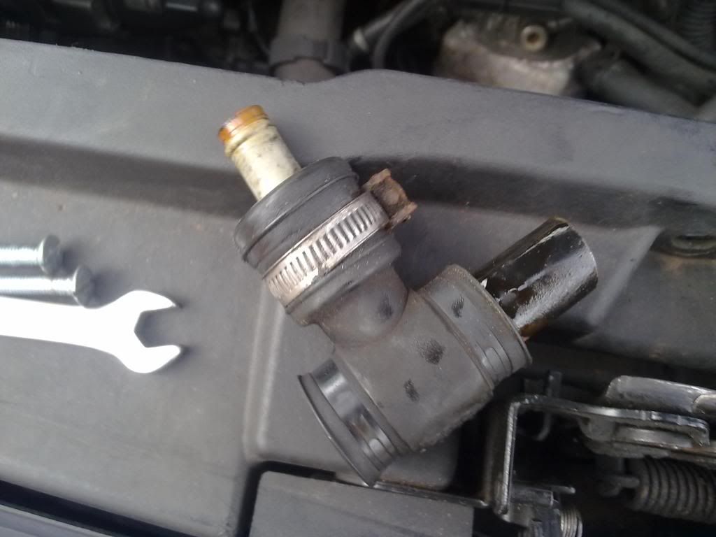

Yeah but be very careful with the bit you push the blue pipe onto, because it'll be brittle and probably fall apart in your hands

I was going to say its plumbed up wrong!
like this
how did people delete the top pipe going in to the inlet manifold

well thats it fixed
