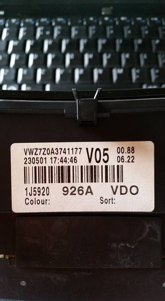

Can you post a photo of the part number sticker here?
Depending on who manufactured them you can retrieve the SKC. It also depends on what immo version your car is wrt also needing other codes and new transponders.

Please give me some good news lol

They are immo3 clocks, good news is they will work on immo2 and immo3 cars.
Other bit of good news is that they are ones made by VDO, so SKC can be retrieved via OBD. I can do this but am nowhere near you and don't have jobs near Dartford for a while.
Do you know what you have in your car at the moment?
If you have an immo3 car then you will also need to know PIN of that car and also you will need new transponders.
2019 Seat Leon ST FR DSG 135kW - eclipse orange - 23k miles
