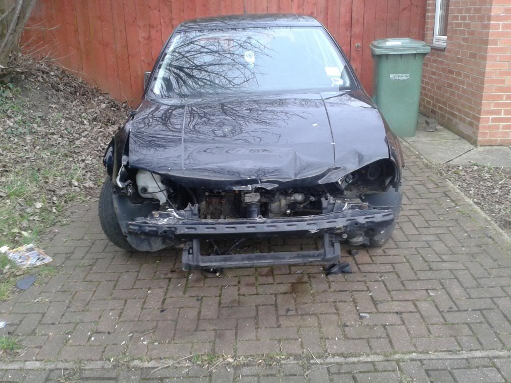

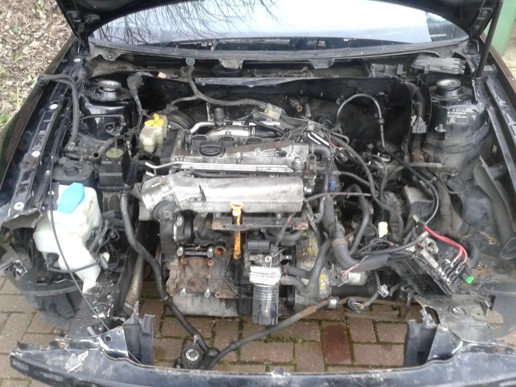

Offline bikemach
  • Posts: 33
the donor, engine almost out
« Reply #8 on: 04 February 2013, 20:11 »
« Last Edit: 04 February 2013, 20:13 by bikemach »

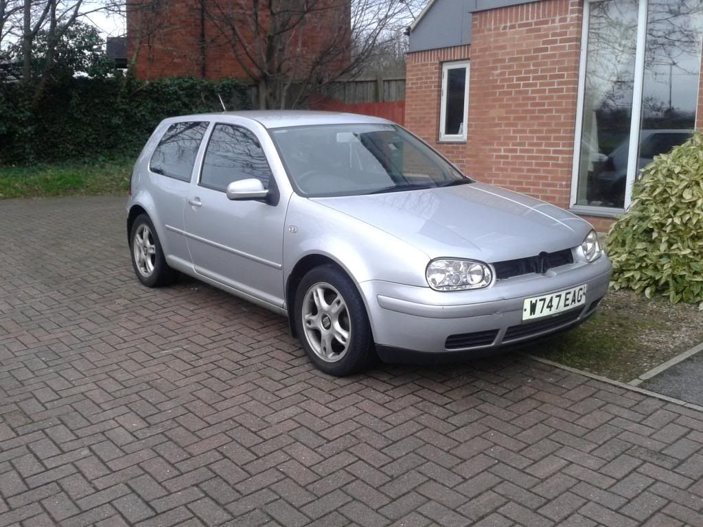

Offline bikemach
  • Posts: 33
the recipient
« Reply #9 on: 04 February 2013, 20:15 »
