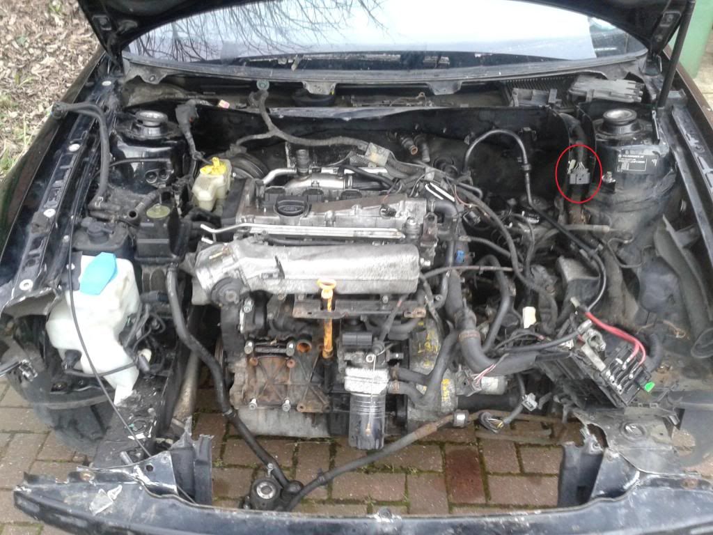

ok so took the engine out the 2.0 8v today and started stripping out the engine loom for the 1.8 20v t loom to go in, but now av hit a couple of problems, after starting to put the new loom in i noticed there is a few differances, the 3 plugs that plug in under the wiper motor, 3 colours were brown orange and green originally, but the new one is brown orange and white, ( the white one dont fit and has less wires in it) and also the 1.8 loom has a connector plug on the right side under the plastic covering as it enters the engine bay, that now has nowhere to plug into, please can anyone help, i need to get this sorted asap,
thanks in advance if anyone can hep point me in the right direction.
Offline bikemach
  • Posts: 33
this is missing on the 2.0 loom

Offline javalin
  • Posts: 1,457
its probably just the angle, but that head doesn't look wide enough for a twin cam / 20v?

Offline bikemach
  • Posts: 33
nightmare wiring
« Reply #19 on: 04 March 2013, 18:22 »
i see what you mean from the pick but it is, its AGU  engine code,
has anyone got any info on the wiring issue?
