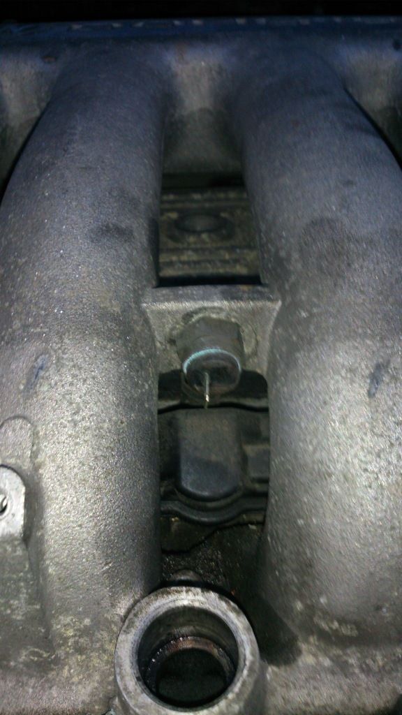

What's this on my inlet manifold? It was plugged in
My other manifold doesn't have the bracket for it
Cheers
Josh

Didn't have that on mine  :huh: guess its a latter manifold some sort of sensor. Inlet temp to help with fuelling? As a guess
Nope.
It's the engine bay temperature sensor for the run-on fans as fitted to cars with Air Con (cars with the twin fans set-up).
..but gaining motorcycles.
Nope.
Ah bugger, so I can't use my other manifold then
You could...
But you'll never have the fan cut in to cool things down.
This may not bother you...as not all 16vs have the functionality anyway.

I had this on mine 97 with aircon, allways wondered what it was,fans would sometimes kick in 20mins after switch off.
You could...
Does it take the reading from the manifold itself or from the engine bay? If its the later I could try find somewhere to put it. I'm guessing its the first tho  :undecided:
