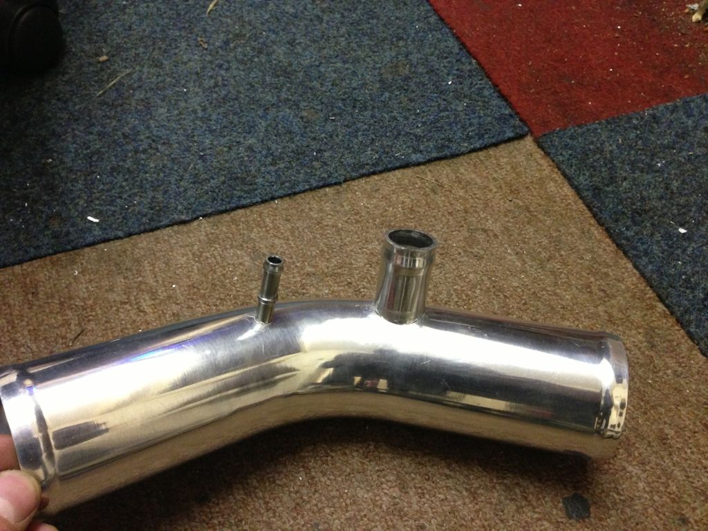

I had my take offs welded
Drilled 2 holes close then filed hem out to a very tight fit
now thats exactly what im on about, is that a 63mm 45 degree bend. i take it any decent welding place should be able to kknock this up eh?

Yeah and a 8mm connector and a 25mm connector just gotta find somewhere that does alloy welding

Very smart Rio, lovely work.
