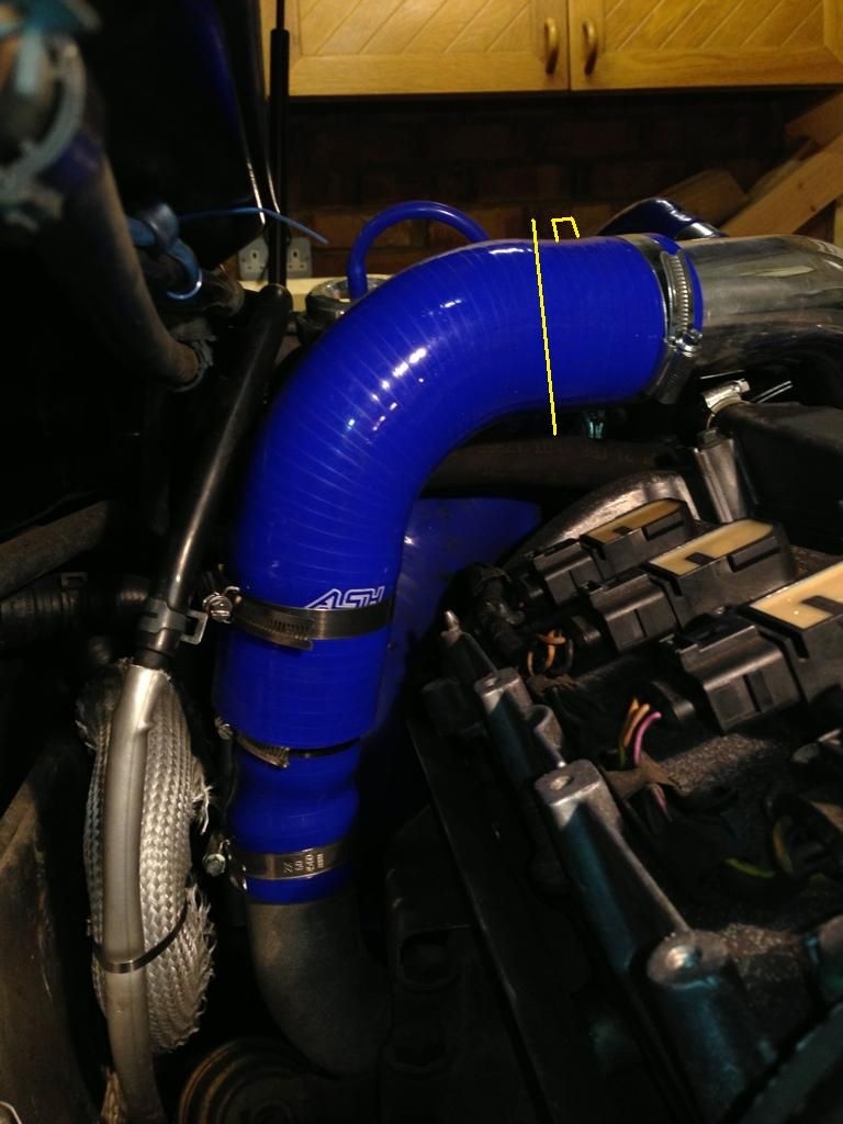

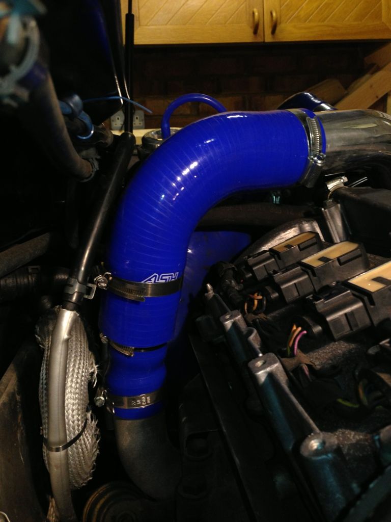

just  thinking tho, the 63mm alloy joiner used to connect the turbo hose to charge pipe , is this not the same as the alloy T piece but without the stub ?, couldnt i just trim a bit off the silicon hose in this pic to get it to sit futher down.

The reducer goes to just above the jubilee clip so toy would have to cut it into the horizontal part
now you dont get much clearer than that, thanks a bunch :)

Offline pickles
  • Posts: 769
  • Next!!!
Re: wellycooler - N75 + DV take offs
« Reply #39 on: 23 January 2013, 23:06 »
cut in here perhaps ?
