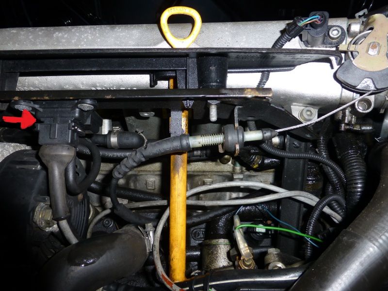

quick question what does this sensor do it has a pipe that runs into the underside of the inlet manifold, the wiring looks aftermarket and was wondering if this could be the relocated map sensor??

I wonder if this installation runs a lambda sensor and Cat?
no lambda and no cat  :laugh:
So it's running with no protection...and no means of measuring and compensating for mixture. Odd...and risky.
It must have an external MAP sensor as the Emerald ECU needs one to run a turbo application properly.
I know the Emerald ECU will let you tun a lambda sensor.
But assuming it's mapped open loop and Alpha-n...it still needs a MAP...unless its running on wastegate pressure only  :rolleyes:
I'd give your installation a good dose of looking at before you go much further...or it could be costly.
I saw that previously and wondered the same.
My guess it yeah.
Is there a flexible hose that goes from it to the inlet manifold somewhere?
Or the pipework?

 the sensor in the pic on mine is a EGT probe and a must have item (at least o factory ECU)
thats only sensor i have in that area it has a braided line coming from it, does yours ? i say this because yours looks different to mine
here is what mine is like (off the car)

The sensor in question has a rubber hose connected to it...and looks like a Marelli MAP sensor to me.
95 octane is fine if you map accordingly...I had a 265 BHP/305 lb-ft 95 octane map on my S3 and it was just fine.
With a decent IC set up you can still get decent numbers safely on a K04 1.8T.
gold star to that man  :wink: http://www.emeraldm3d.com/map-sensors.html
