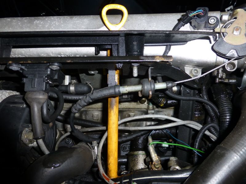

google suggests that its an early 1.8t throttle body as the older ones were cable operated, possibly the whole inlet is from a transverse mounted 1.8t as it has a oem looking bracket under the manifold to hold the cable

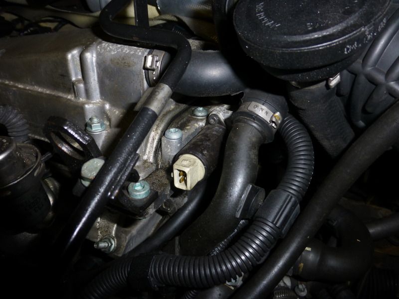

is this the water temprature sensor? if so its not connected  :rolleyes:
and heres the cable throttle bracket with what i think could be the map sensor to the left, there is a pipe going from this sensor to the bottom of the inlet manifold
Thats a TT/S3 inlet manifold...transverse mount. The longitudinal inlet manifolds are very different.
It could be an early 1.8T TB...but the cable TBs were mounted on the 150/180 inlets with the TB on the left.
RHS mounted TBs (TT/S3) were only ever DBW as far as I know.

Thats the sensor for the VVT Tensioner, really should be plugged in, although if you are running Emerald then only they know what needs to be plugged in or not.
I would entirely re-pipe the intercooler, same diameter pipe throughout will aid in air flow.
The MAP sensor should definitely be on the pipe that runs up to the TB, but again, Emerald may not need it as the early engines didn't have em anyways.
And yes, Ess_Three is correct in saying that RHS mounted TB's were all DBW from factory, not sure if Emerald sell the TB's with there kit like Qpeng do

^^ it was a barometric pressure sensor integrated into the ecu.... so they did have a map sensor, just not one you could see lol

a bam engine with a throttle cable?
im beginning to think that might be an aum (?) with a s3/tt manifold!
Why would you think that? AUM was DBW too.
