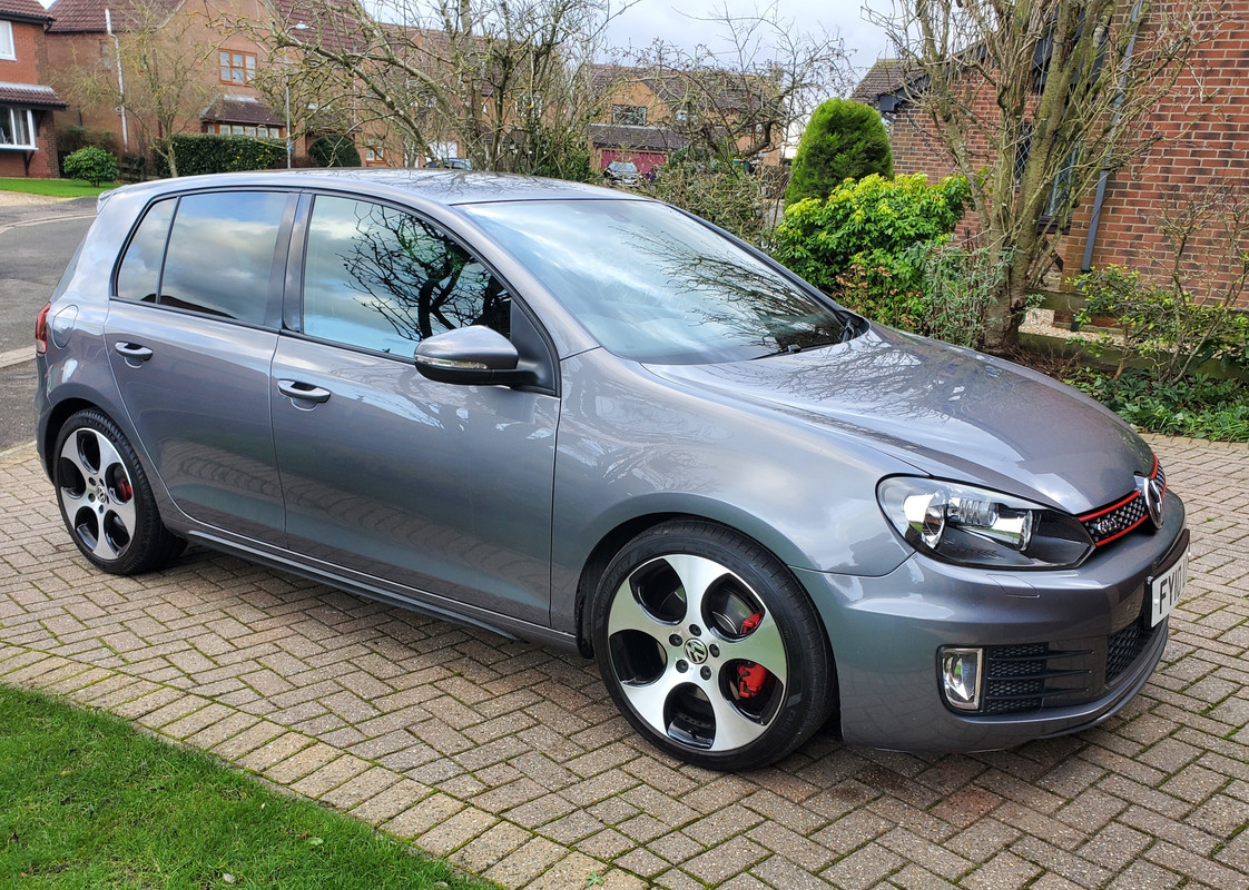

« Reply #3250 on: 21 December 2024, 13:36 »
Given the car a Christmas present - wash and wax. Nearly 15 years old now!

« Reply #3251 on: 26 December 2024, 18:47 »
Still looks good.  :smiley:
