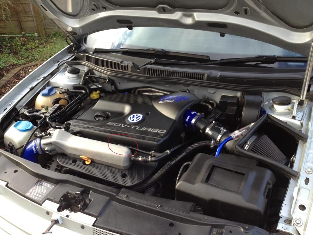

Offline Rob Zombie
  • Posts: 177
Re: Loss of PSI
« Reply #27 on: 27 December 2012, 15:15 »
i like that - i would have chosen black pipes if i did the work after i purchased it.
this is mine at the moment (excuse the circle) - will look nice with an OEM style can in there.. and if i take of the dam forge sticker :P ... i do need a strut brace :undecided:

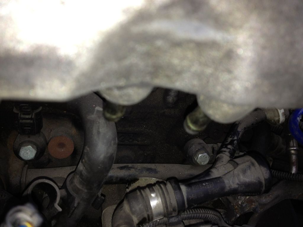

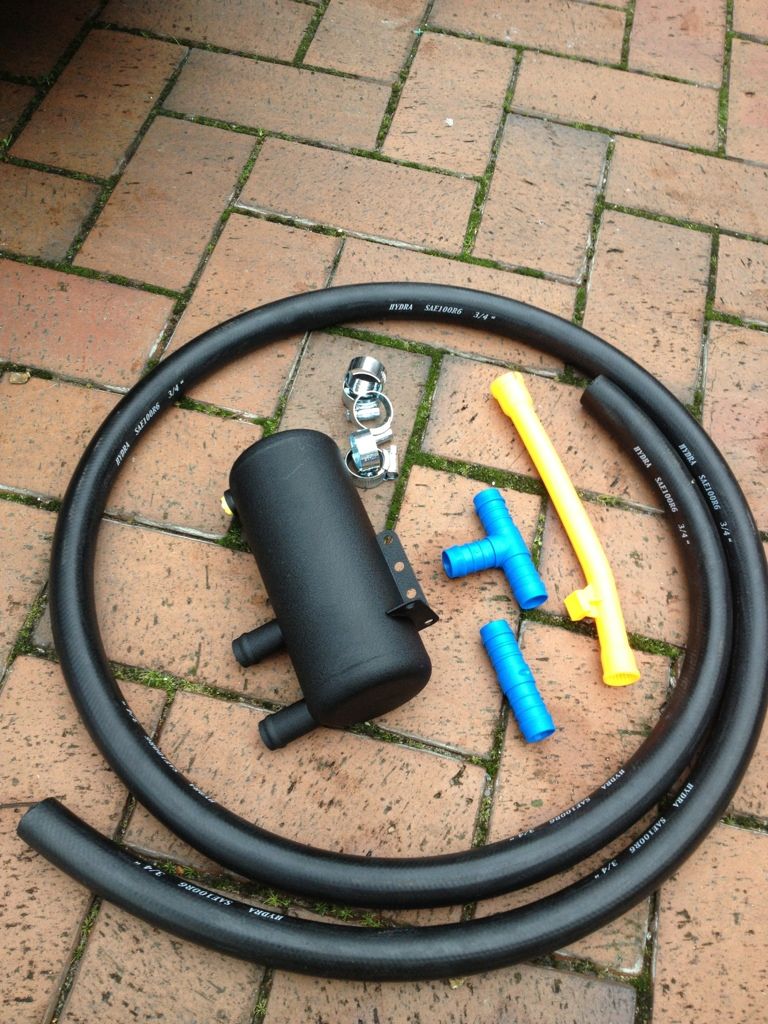

So this is what I ordered. Stealth catch can, 19mm ID oil resistant hose, 19mm barbed T piece and some new clips

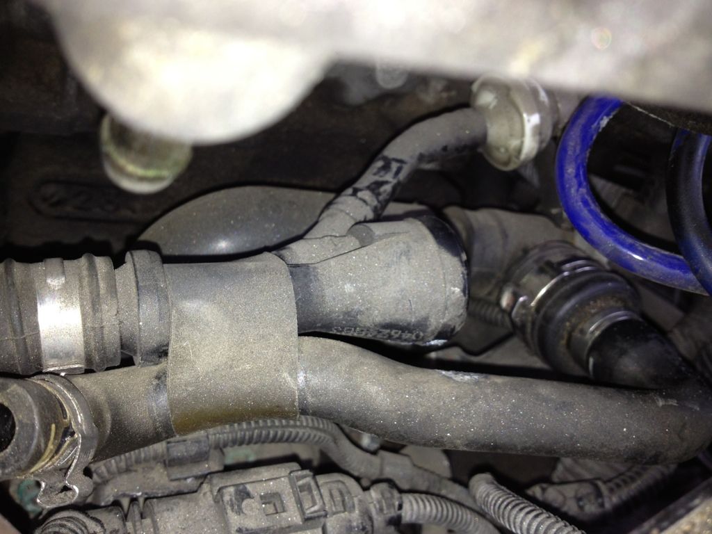

So took out the bracket and started moving the pipes out - Pcv valve was completely clogged up with pure filth! So was the upper breather etc. as I expected its was a newer AUM than pats guide so it also had this vac pipe leading from the jet suction pump to the TIP
Also I had 2 vac intake nipples under the mani
So I decided to block of both and remove the vac line from SAP to TIP. I left the line installed incase it didn't go to plan .... Will fully remove tomorrow while detailing the engine bay!

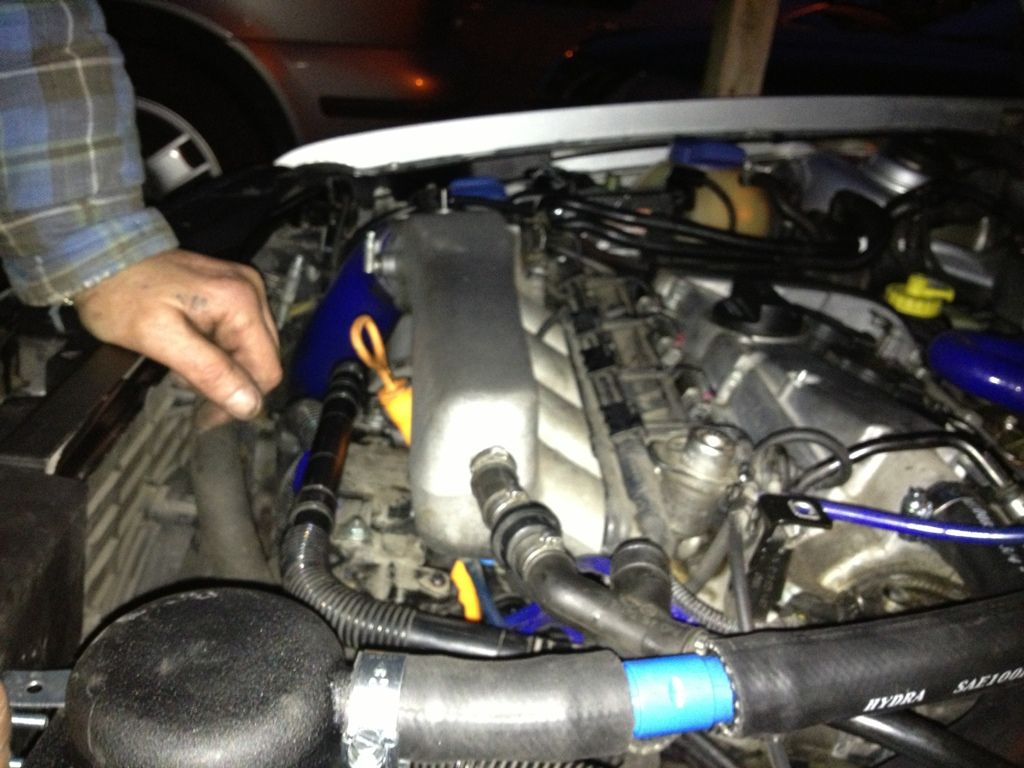

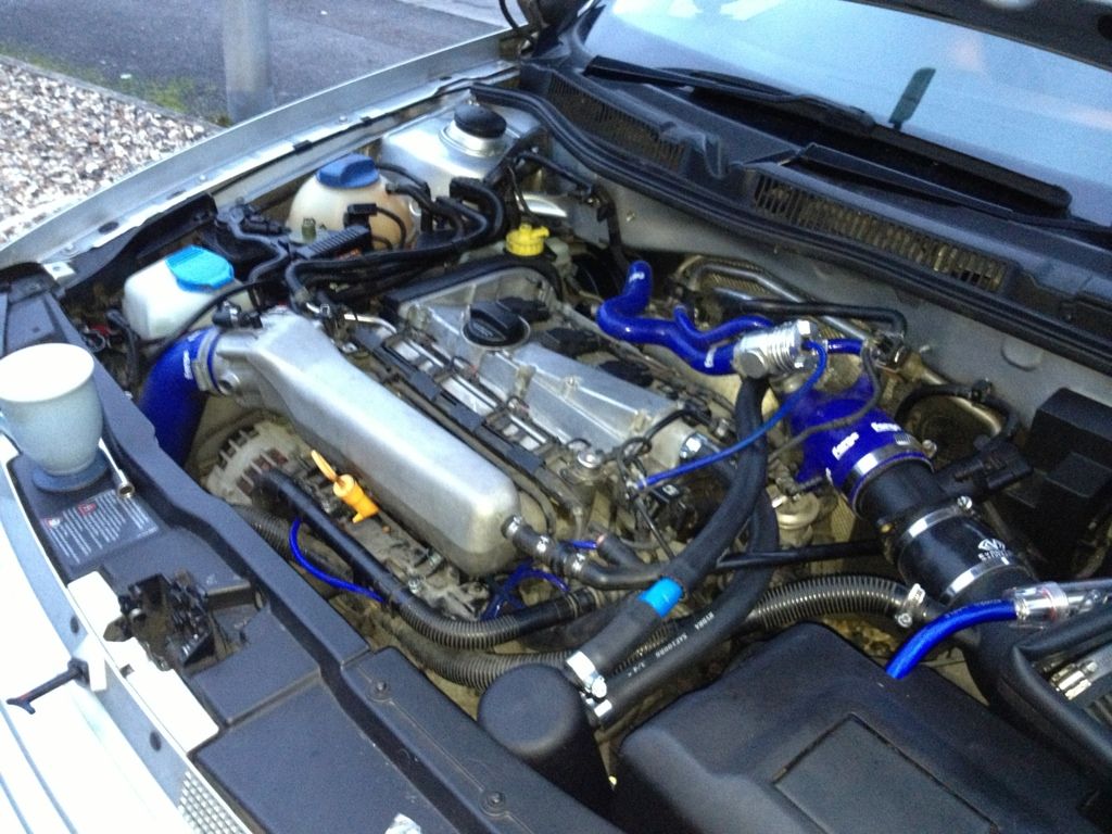

So next I added the vac lines and happy days! Nice snug fit ! Now need to fix a bracket to the front!
Bracket fitted . Gunna spray it black! Need to give the bay a clean tomorrow and order more pipe to sort out the blanked off booster pipe... Engine cover is to be trimmed down on the morning as it was getting dark!
So I now she idles lovely! Better mpg ,and hold full boost longer! Very happy with the results!
Will upload some decent pics tomorrow showing full result :)
