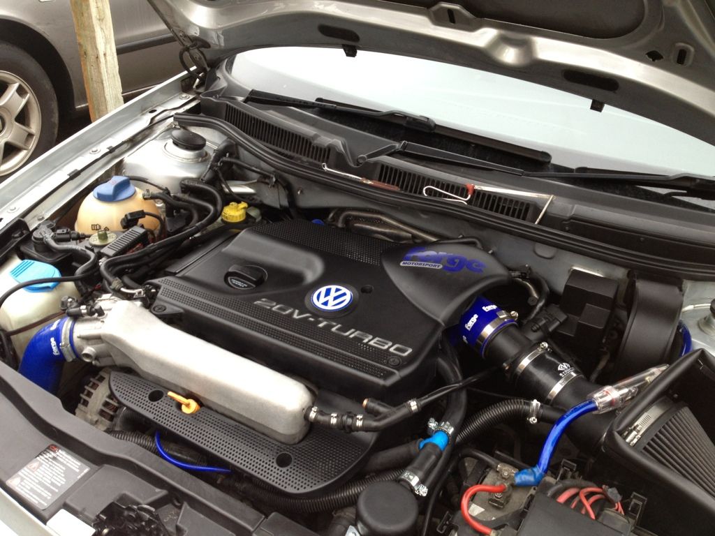

When I blocked off both of the vacuum lines under the manifold when fitting the catch can, I did about 10-20 miles then white smoke was poring out the exhaust when I came off boost, so I connected the line going from the manifold to the TIP and no more white smoke, saying that mine is an AUQ so yours might be different

The problem I have is the mani to te tip seems to be connected by the suction jet pump valve - which keeps falling apart. :/ ill keep an eye on it .
When you say pouring out - do you mean literlly thick white smoke / plumes etc?

All cleaned up and looking good

Nice job mate, just need to get rid of that brake booster Y piece now

Yea in ordering some more pipe this week - that y piece just looks nasty now  :sick:
