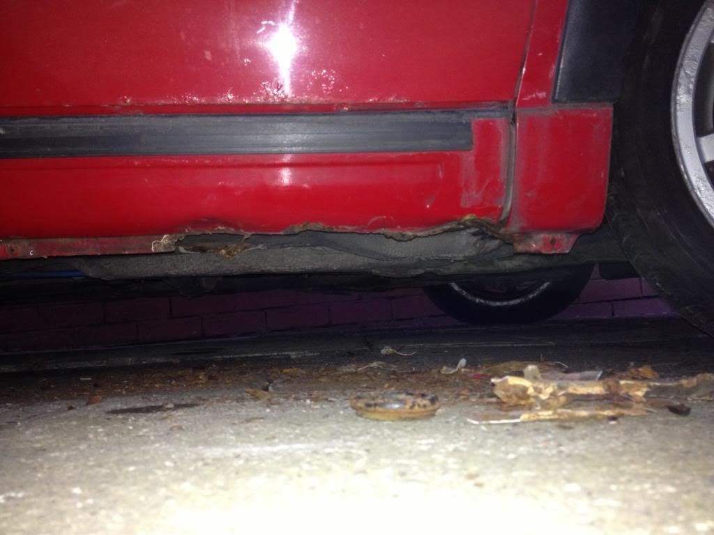

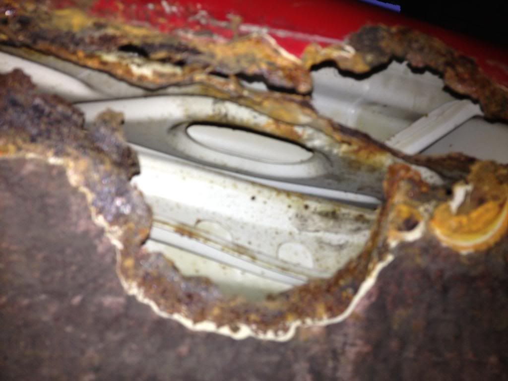

As you can see the lip is totally rotted away, got some good thick steel to plate over now, just unsure on how to build the middle bit of the inner sill, to give it strength to jack from.
Suppose i am just gonna make it up as i go

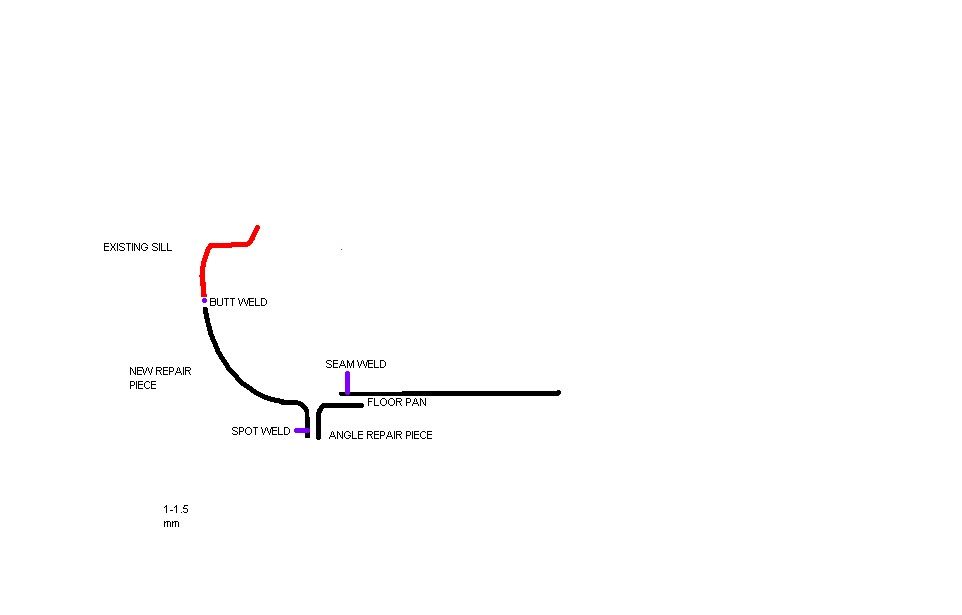

35x 5  :undecided: mk3 is heavy enough  :laugh: , i would probably do something like this
« Last Edit: 05 November 2012, 23:32 by Screech16v »
Great diagram, makes it look so easy!!, on my pictures, no2, you can see a central strengthen piece that comes down vertical to make the lip three pieces of steel, do you follow me?? Hard to describe
That's the bit that's worrying me
