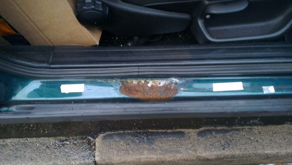

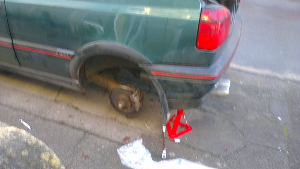

Washing my car today and the kickplate came off revealing this  :undecided:
Looks like someone even tried bodging it with filler with the kick plate still on! Anyway had a good poke around and its still completely solid so just going to grind out the rust, treat it, seal it, and paint it. Just stuck the plate back on for now and will deal with it next week!

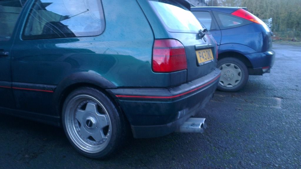

Started to put my wheels on yesterday, but the spokes foul on the brake calipers on the front. Only very very slightly, have ordered some 5mm flat spacers which should be here tomorrow then can get all the wheels on. Can't be bothered to wait til my springs show up even if it does look a little funky with a bit of stretch at standard height!

Spacers arrived today  :grin: Had originally ordered some universal jobbies for £5 but upon recieving them thought better of it, as they were shockingly bad. So bought some decent quality TPI 5mm spacers with the correct centre bore. Going to fit my wheels if the rain holds off for the next few hours!

Well started putting the interior in, removing the rear door cards meant removing the door sill trim, had a good look at the rust on the inner sill and it looks to be very minor and just surface rust. The bodge job of covering it has made it look a lot worse than it really is. Ran out of light yesterday so going to spend my lunch hour today getting the front seats in.
A few bits of bad news though....5mm spacers didn't cut it. So have bought some 8mm. This will give me an ET of 17 on the front so expecting to have to massage the arches slightly with a hammer lol.

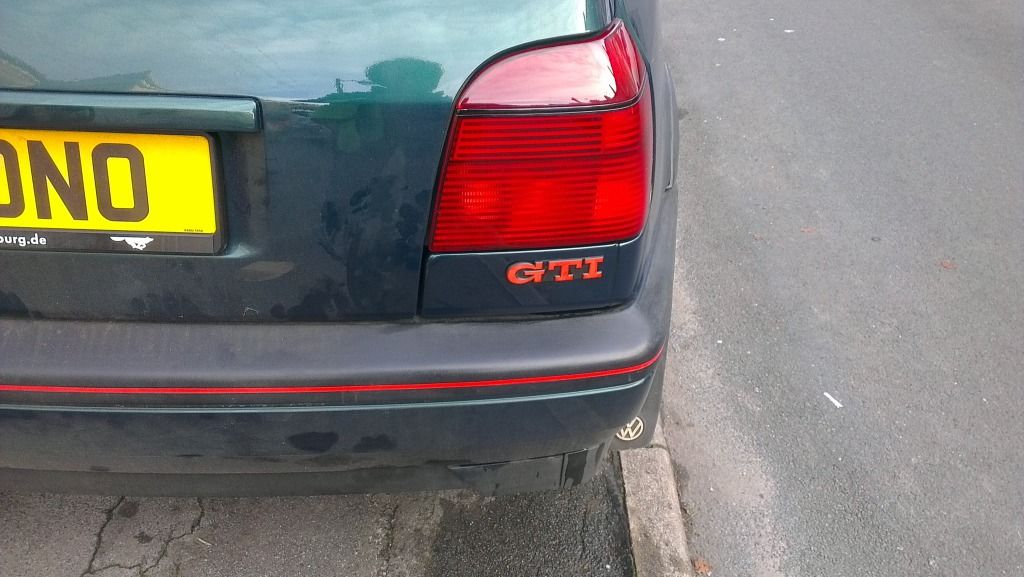

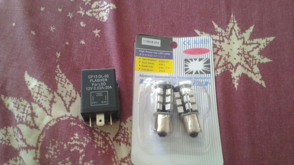

Finally got around to ordering some amber LED indicator bulbs and a new flasher relay so they don't flash fast, so installed my new all red rear lights.  :smiley:
Also took off the rear "Golf GTI" badge ans replaced with an Anniversary red one.

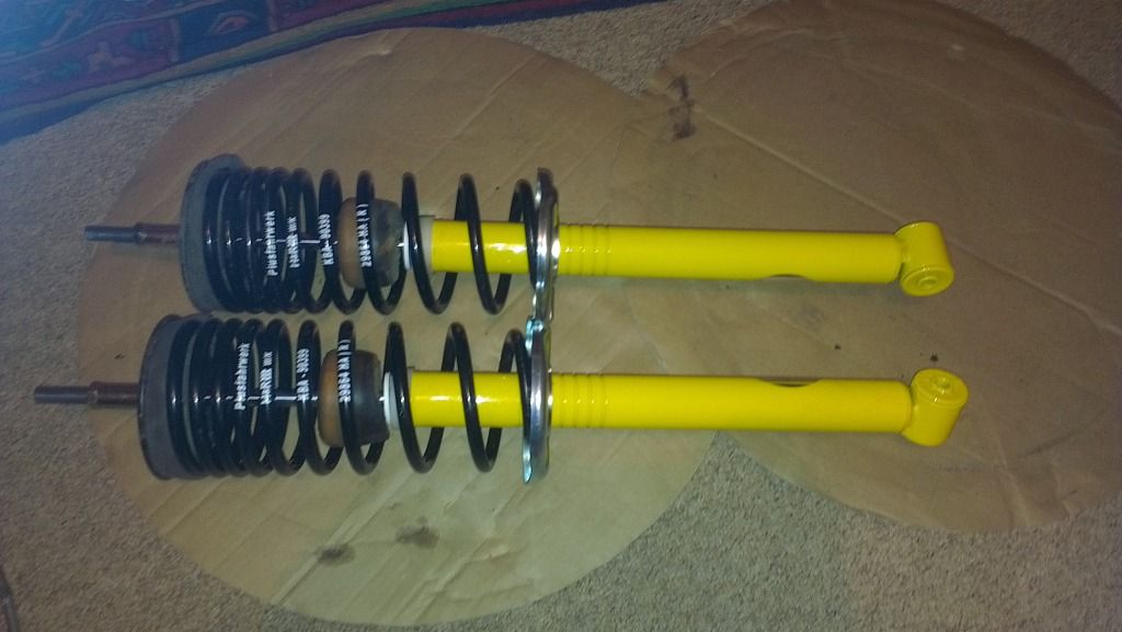

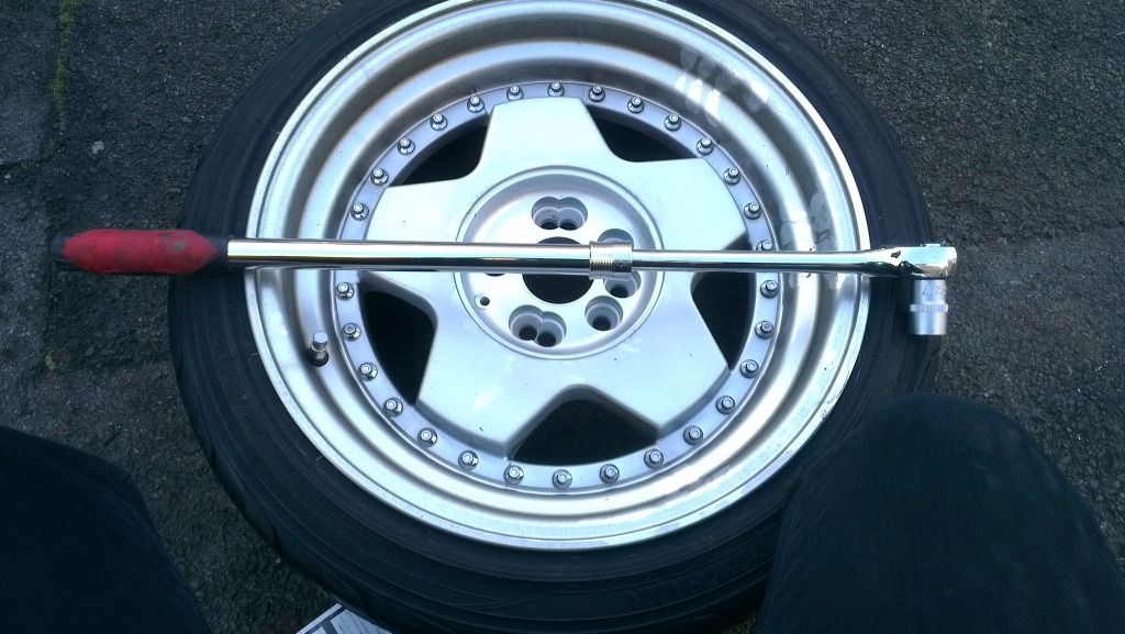

Fitted my rear shocks yesterday, still waiting on the front spring caps from VW. Everything went nice and smoothly, thanks to my £10 eBay 1/2" drive extendable ratchet handle lol!
Old shocks off.
New shocks built up. Had to drill out the spring cap and also the top retaining washer as the threaded shaft is larger on the FK shocks.

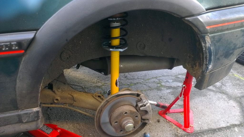

Shocks on.

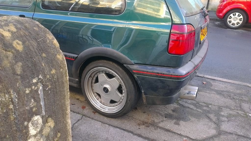

This is how it sat just after lowering back down to the ground.
And finally after a little drive around. This is with nothing in the boot except the spare wheel and I think it sits pretty nicely. Tyre is ever so close to scrubbing so arches will need to be rolled only very slightly.
