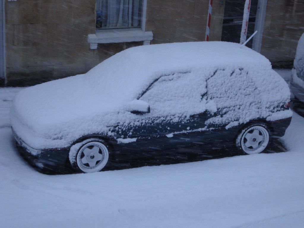

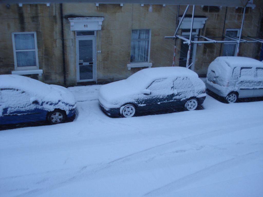

Obligatory pics of my car in the snow.  :smiley:

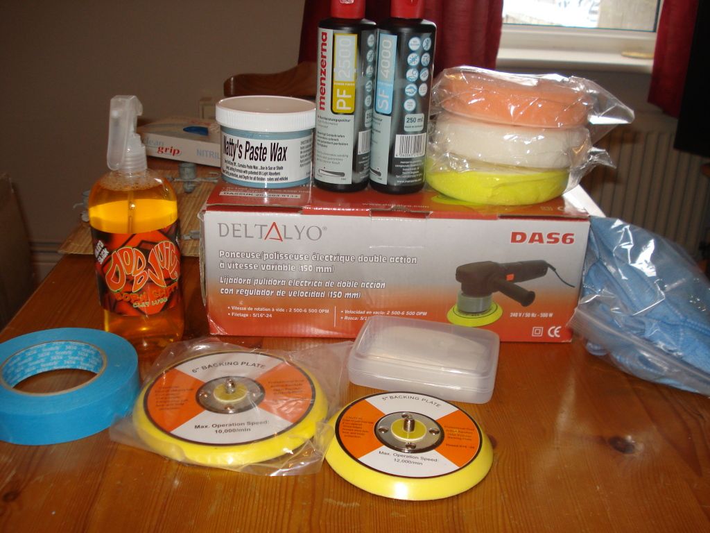

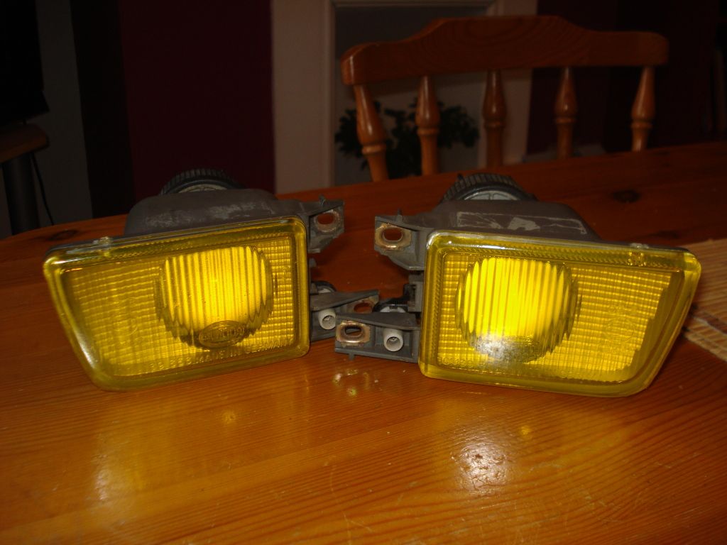

Got a few new bits to go on soon too. Scoured eBay over the course of a few weeks to make up a set of OEM Hella fog lights,then ttinted these with some cheap yellow tint film.
Also treated myself to a DA polisher to correct my paintwork. Got a Menzerna polish/pad kit, clay bar and lube, and some Nattys blue wax. Going to add some 4" spot pads and get some Poorboys blackhole glaze over the coming weeks/ weather is too crap to start detailing anytime soon!

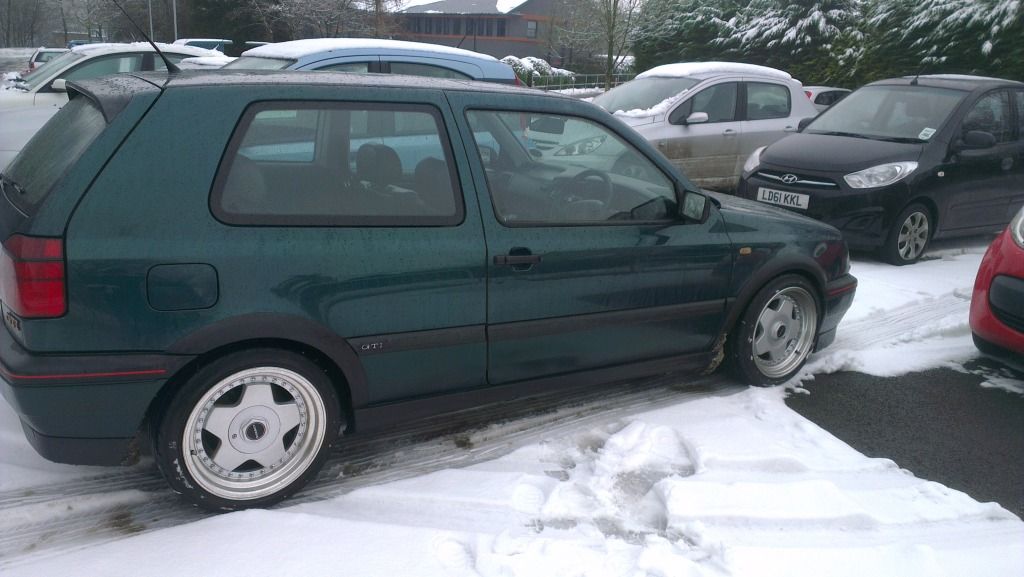

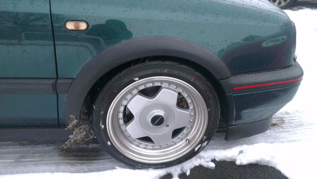

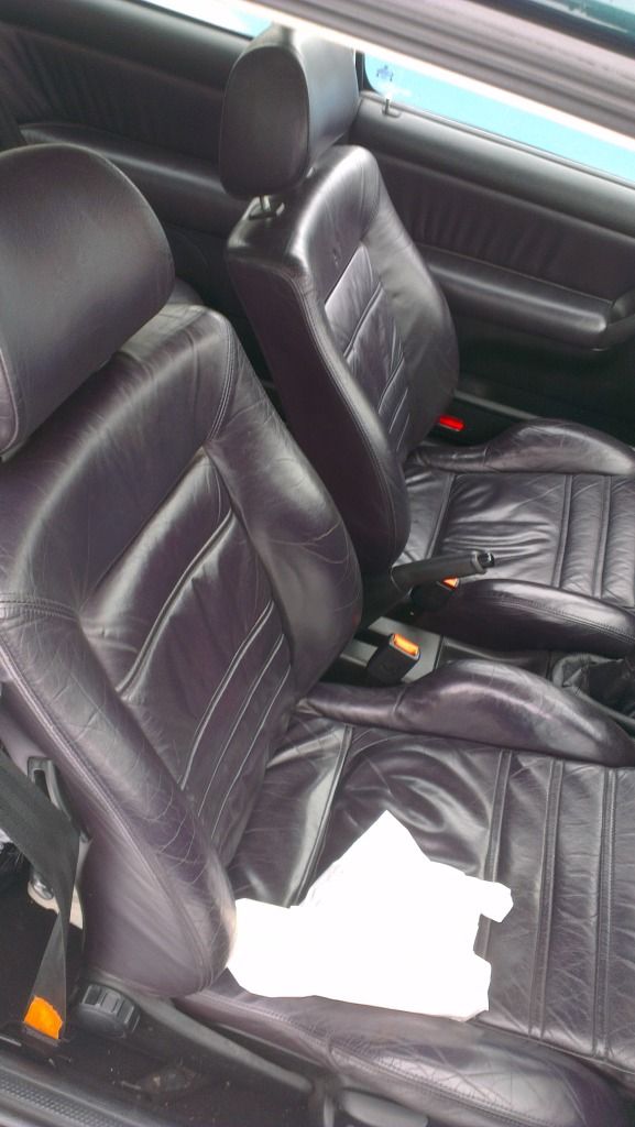

Couple of pics as I realise I didn't have any showing how it sits at the moment!
The highline interior
