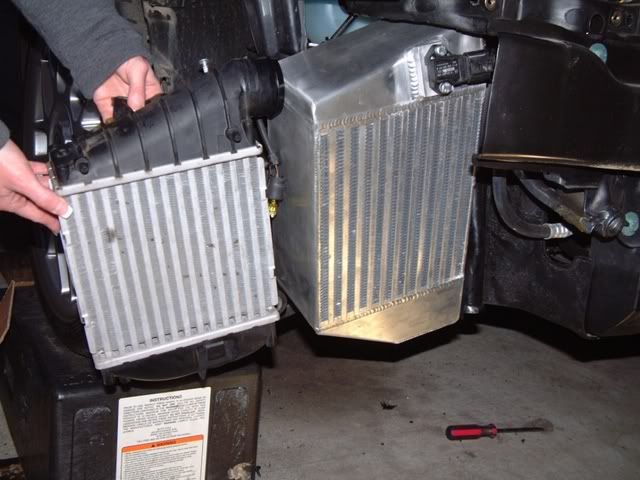

Could run monster sized smic like tyrolsport one good for 350whp cost £700 and only from the states, quality 2nd to non. Mine up for sale pretty soon :grin:

Don't get confused with turborev rubbish smic, these biggest and best smic avaliable.
