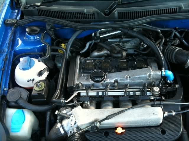

as with other threads, you need to remove the pcv valve under the inlet manifold and block up the pipe attached to the inlet itself. i used a 30mm piece 0f 19mm hose from the block breather outlet to the metal block PCV pipe, and put a bolt and jubilee on the inlet manifold pipe.

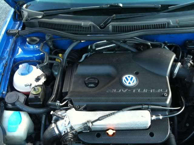

what i have done here is remove the hockey puck and blocked the TIP with a wine cork and mikalor clamp  :grin: this will be replaced when my forge 20mm bung arrived from the bay.

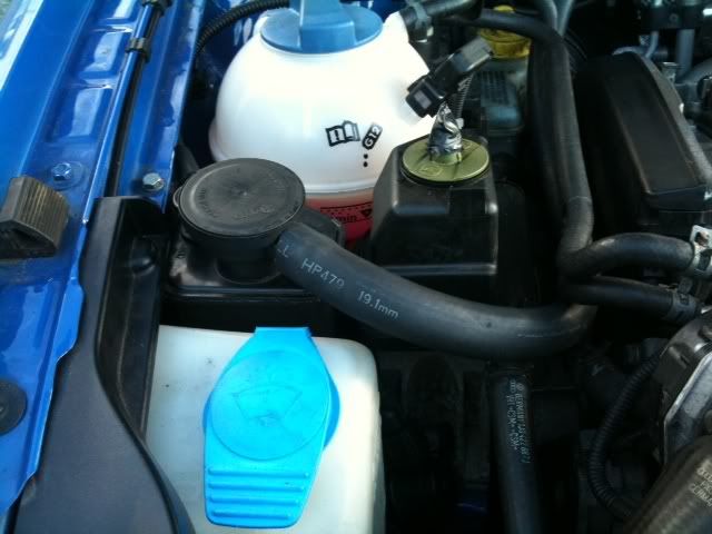

on the other side i took out the carbon canister, prised open the lid, and removed all the crap. i have just pulled out the solenoid and tucked it under the header tank, this has thrown up no fault codes after 100 miles.  of course, i blocked off the inlet on the throttle body.
as you can see, i have re used the hockey puck valve. under this is 5cm of 19mm hose, bulked up with tape. this secures the valve in the canister.
the canister also has a handy pipe on the bottom that can be used as a drain plug!
and then....
i just ran 19mm pipe from the metal block breather pipe, round the bulkhead, and in the the newly used carbon catch canister.
as you can see, its looks almost OEM
