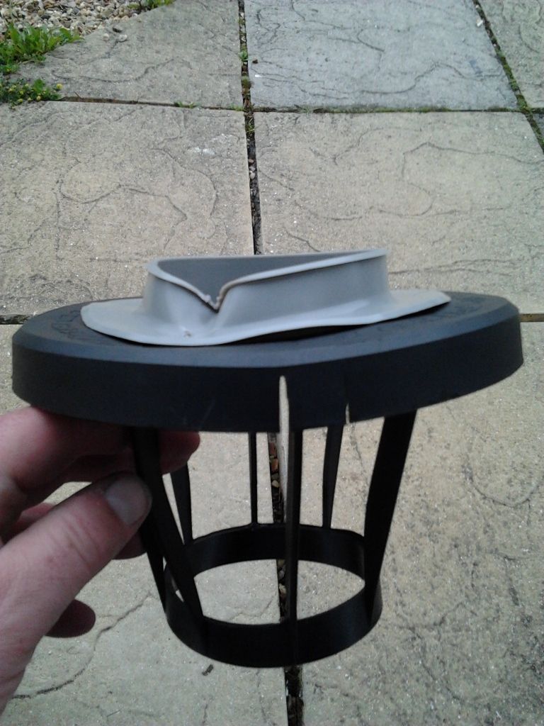

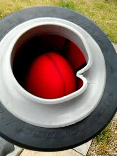

I over tightened the hose clip that feeds through the bracket holder, and look what I did  :cry: I have since ordered a replacement part from Pipercross which will be with me monday, but will this cause a boost leak as it is at the moment? Does anyone know because today I fitted a catch can, and although the power is up a bit and is better, it is still not as good as it should be for a stage one remap

I put the oem air box with a piper cross panel filter back on today, and there is a definite improvement in performance. So the venom filter that I over tightened and broke, did cause a boost leak. It is still not quite a 100% performance yet, but certainly better.
I am not sure if I have the wrong hose clip holder or not that fits on to the bracket, but I can't really tighten up the hose clamp much or else it just bends the silicone pipe and squashes the grey bit, as shown in the picture.
Has anyone else noticed this on the Venom induction kit?
