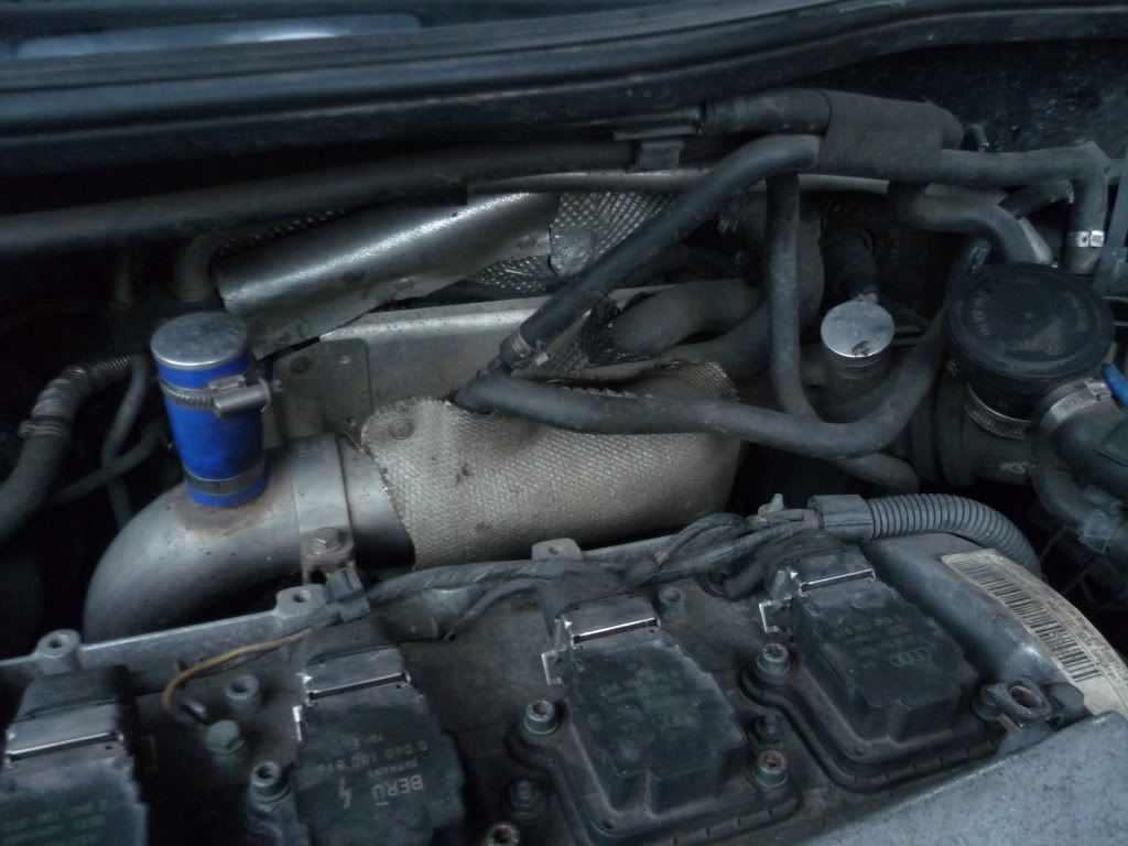

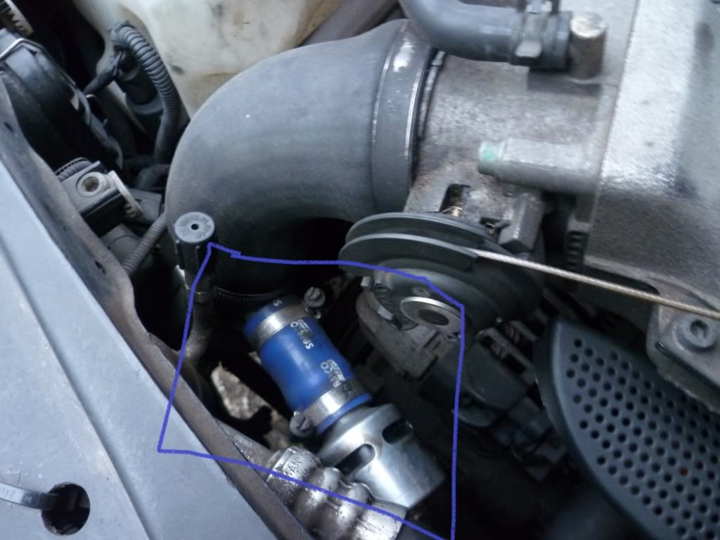

the car has just been serviced oil,filter,plugs,cambelt, heres the pic's on how the pipes look now
the big question is would i really lose 20+hp with the dump vavle??

If its not a twin piston dv it deffo won't work well, get a recirc valve and take the recirced side back to the tip (r/h/s plugged pipe) with a long pipe

well first off im getting rid of that dump valve hoping to buy 007p or 008 not sure which is the best of the two??
see in my picture the two blanking caps do i just put the dv in the tip and then the long pipe from that to the other blanking cap?? where does the small hose go from the top of the 007p go??
thats if all i have missing i.e one pipe and dv?

Get the 008 as its newer and put it where it is now and take a pipe to the tip leaving the blank in the charge pipe is

so leave blanked the cycle in red and then run pipe from cycle blue to where my dump valve is now put replace it with 007p or 008
and this will work fine??
or am i just better off setting it back to stock but using the forge 007 or 008
