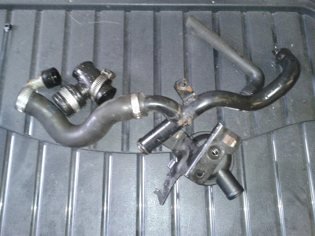

Out with the old
In with the new  :smiley:
All DIY using basic tools, The engine cover needs modding now so I can run that.
Will check next week if iv caught anything  :laugh:
