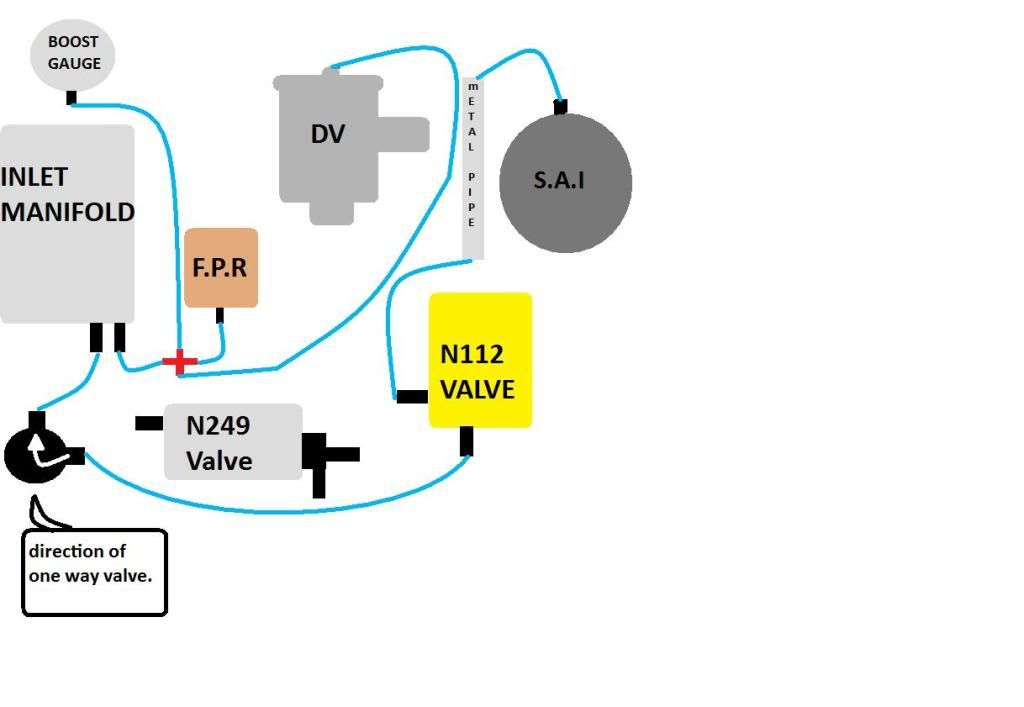

Instead of making another topic thought id do a bit of recyling :grin:
I did the N249 bypass at the weekend and just want clarrification that Ive did it right.
here's what ive done
Ever since doing this, under load im getting turbo flutter/stall  :huh: ive checked for split hoses loose connections and cant find anything, how ever this has only started happening since doing the bypass. If revving in neutral it 'blows off' as normal ie not flutter/stall.
bit baffled really, can anyone shed any light??
VIDEO

I did the bypass and then after a week or so it annoyed me, so just scrapped the N249 and N112 delete with the resistors and forge blanking plate and made a massive difference, bay looks much neater.
as for the fluttering, what size tubing did you use and have you cable tied them all on / checked them all ?
