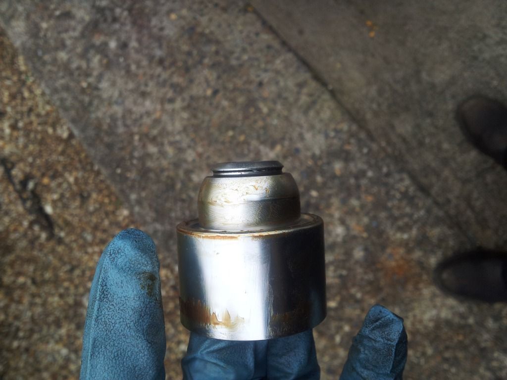

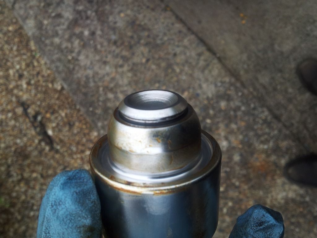

I think I may have found the problem  :undecided:
Had another look at the diverter valve and on second look I think I may have found the problem. (probably didnt help the first time i took it apart I was hanging out my arse)
Am I right in thinking theres supposed to be an o-ring in that groove?  :undecided:
My gauge at idle sits at -22hg !? although Im sure it has always sat this low prior to this flutter situation!?
can anyone comfirm?  :smiley:
thanks

http://uk-mkivs.net/forums/t/433829.aspx
doesnt look like it should be raised  :undecided:

Mines not a 007p I dont think. how ever I would say that groove has been machined out on mine ?? :undecided:
