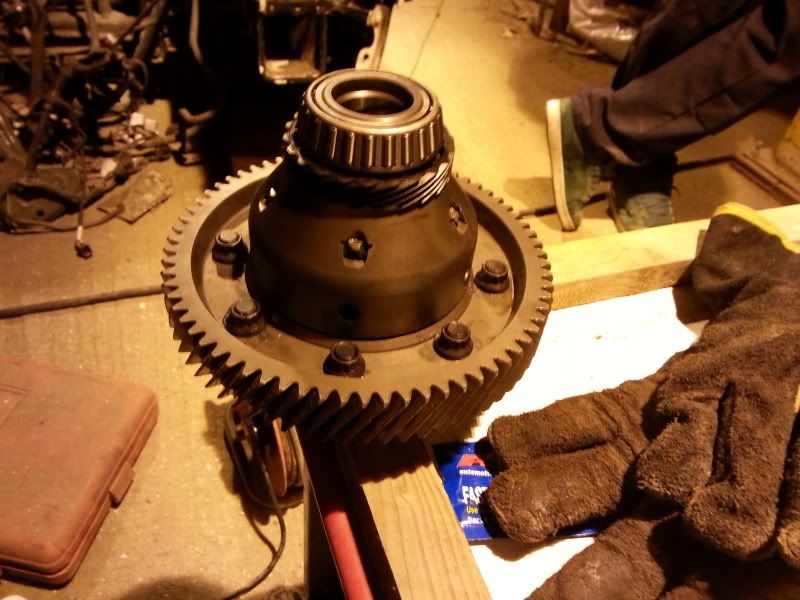

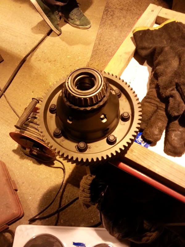

« Reply #549 on: 24 May 2013, 00:30 »
Crazy Old night but a very significant outcome.
The Quaife diff is in and the gearbox is back together.
Not many pictures as the focus was more on getting it in there rather than playing photographer.
Crown wheel bolted to diff with the proper ARP bolts, diff preloaded by 0.3mm.
All went back together rather swimmingly after we had decided on shim size.
Heated the new bearings on and they slipped on perfectly with no need to press them, helped by an official Volkswagen electric hob :grin:
Also the crown wheel was heated up on it to persuade it onto the diff.
Now back together, new bolts, new speed gear, new bearings, new diff seals, just need new O rings And some oil now.
All genuine bits, including the casing sealant :shocked:, complete peace of mind that it's going to be good for another 90k and beyond, which is all the box has actually covered.
Didn't get to paint the cars floor which has now had all the underseal scraped/wire wheeled off, but it has had a generous lashing of brake fluid to make sure it's ready for the first coat.
