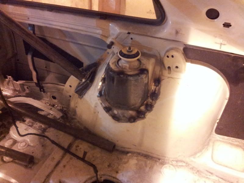

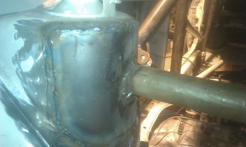

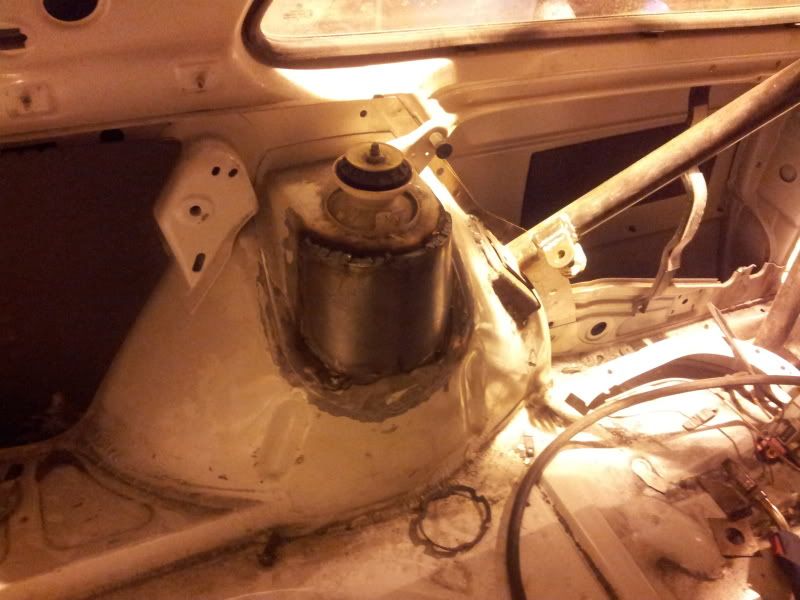

« Reply #525 on: 10 May 2013, 23:15 »

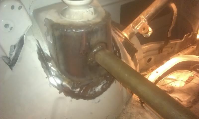

Rear strut brace spreader plates made and welded onto turrets nicely tonight.
Just need to cut CDS to length and profile ends and we will have substantial/correct bar to mount harnesses on.
Also rear turrets were seam welded to strengthen things up abit.

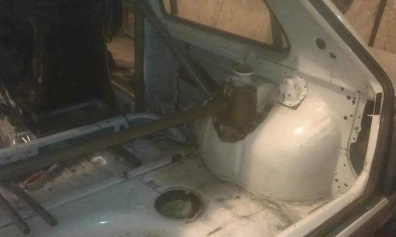

« Reply #526 on: 11 May 2013, 00:41 »
One side:
t'other side:
I stopped seam welding after the first turret, as the seams need cleaning really aggressively, as there's still paint in there after they've been scurfed up and it flares up and contaminates the weld - really not happy with the finish.  The steel of the arches under the turrets is also bloody thin, too.  Not a happy welding combination.

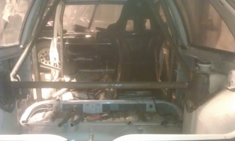

Tonight, disassembled the door bars to cut and re-weld at the right length to suit me. Bit of a battle between access to the car vs room with seat but think we've got it, hampered by the fact the brackets that connect set subframe to the bars that attach them to car are NOWHERE TO BE BLOODY SEEN! :sad:
Sure they will be in the last place we look DH, just we haven't found that 'last place' yet :grin:
Rear strut brace / harness mounting bar has been profiled, fitted and welded in.
