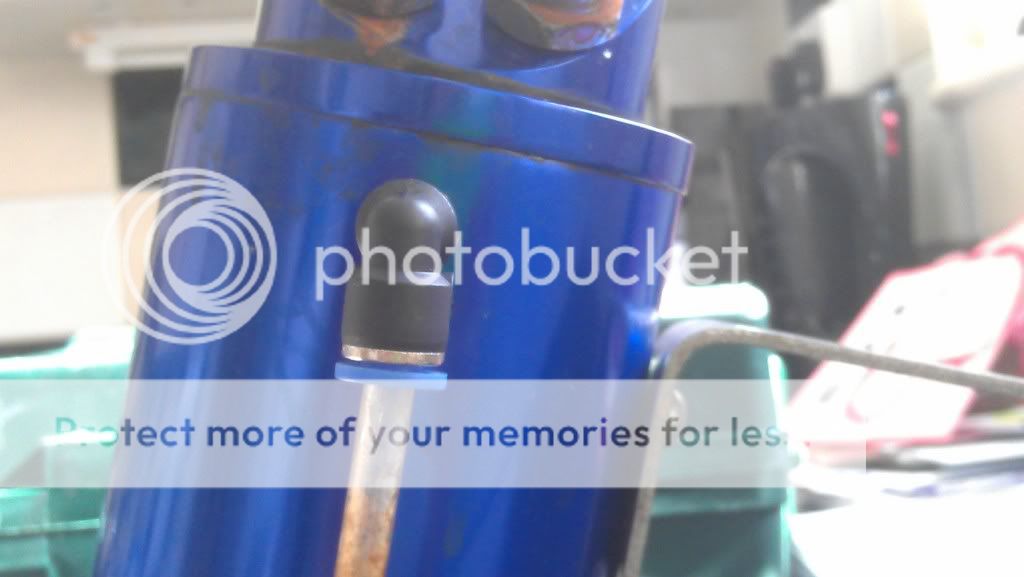

first up got an ebay can and had some stainless 19mm fittings custom made as it only came with 9mm and 15mm and wanted to use all 19mm pipe just want to point out that this is not a how to but feel free to use at your own risk  :grin:
the new fittings along with ebay jobby

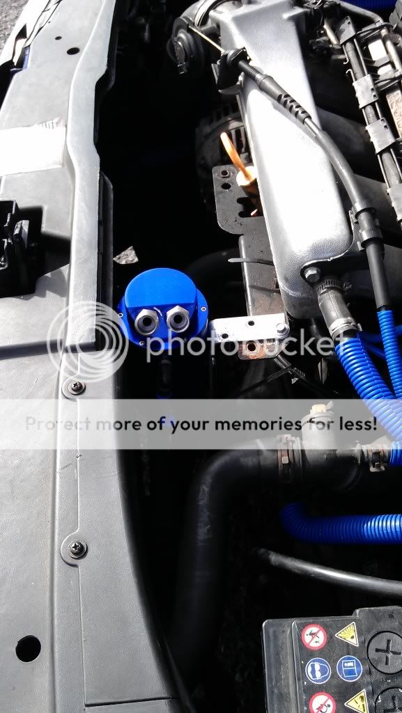

decided to mount at front as it seemed to make the pipe work sits best there

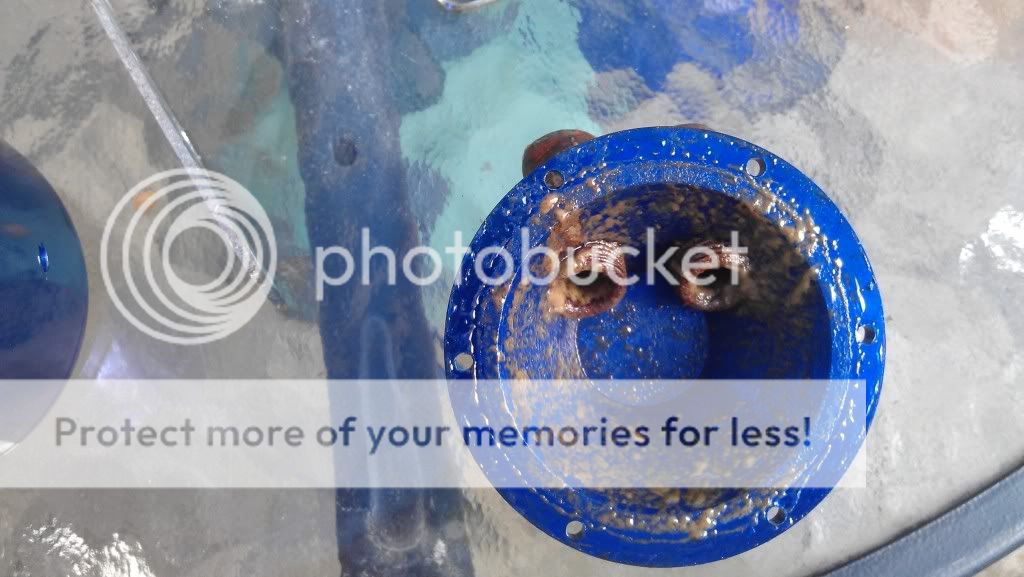

after 9 days i noticed it was starting to get quite a bit of gunk in there and what appeared to be my can leaking

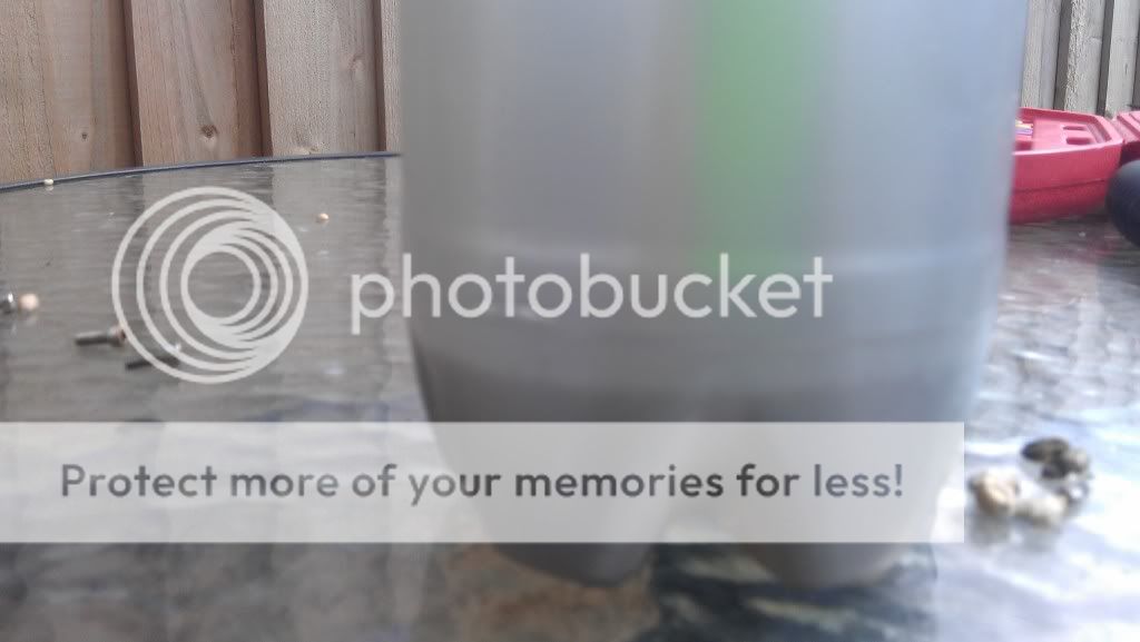

where the top of the can bolts to the bottom was metal to metal so in my knowledge there was no seal so decided to take apart and use some gasket seal to bond top to the bottom of can and then tighten it back down with the bolts that were in there reason for doing this in first place was i noticed oil seaping through as in the pics
gasket seal on
and fitted back together hopefully there will be no more leaks through the seal not saying this will happen to everyones but my luck is poo and if summat can go wrong then it does for me  :grin:
all finished and back together

looks good mate,bit of a kink in the pipe coming off the rocker cover

Looks tidy pal..
Paint the 20v - Turbo on engine cover same blue as pipes!

Need a battery cover too

cheers guys yes i got to take off and trim down a lil bit to pull kink out
and dave was thinking of it but cba  :laugh:

I have an eBay catch can too and I also dismantled it to apply some clear silicon gasket but I used braided hoses instead, unfortunately those hoses you used aren't intended for use with oil and won't last too long.
So far it's not leaked at all, can't complain given how cheap these catch cans are.
