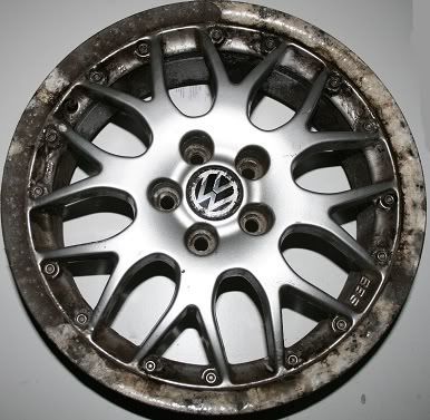

« Reply #7 on: 02 February 2012, 18:17 »
Yeah they go proper manky dont they
This is what mine used to look like
Offline Leon27
  • Posts: 398
Re: BBS RX11 and Spacer advice
« Reply #8 on: 02 February 2012, 18:28 »
 :shocked:
That's quite a transformation?! Who did that for you? Looks like a great job
Offline Screech16v
  • Posts: 2,432
  • MK3 20vt AGU
« Reply #9 on: 02 February 2012, 18:49 »
Me and a bit of elbow grease  :smiley:
