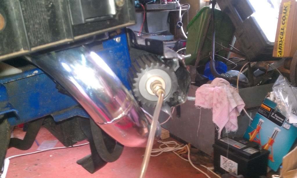

Yeah i wont be going crazy with it, just a bit more power but mainly its for safety.
Not sure whether to keep jet there or further back up the system like tapping the jet into the silicone intercooler - TB hose.
Arrived today;
Fitting mine soon going to put my jets one in intake hose, poss one spraying cooler itself. Not sure where to fit bottle, if under bonnet and using only water in this weather freeze so boot's looking more likely. Not sure is will freeze with 25% meth/75% water, not sure on freezing point of meth will have to investigate.
They put methanol in antifreeze to lower its freezing point so it shouldnt freeze with the mix.
Mine fitted using the washer bottle for now will see how quickly it goes through that and see if I have to get a bigger bottle.

Do you think it would be an advantage to tap into a boost pipe after IC then for meth?
Unsure if the manifold i have got will distribute it evenly enough?

Look in the pic, its in manifold atm..
Thinking of going when jon has.
