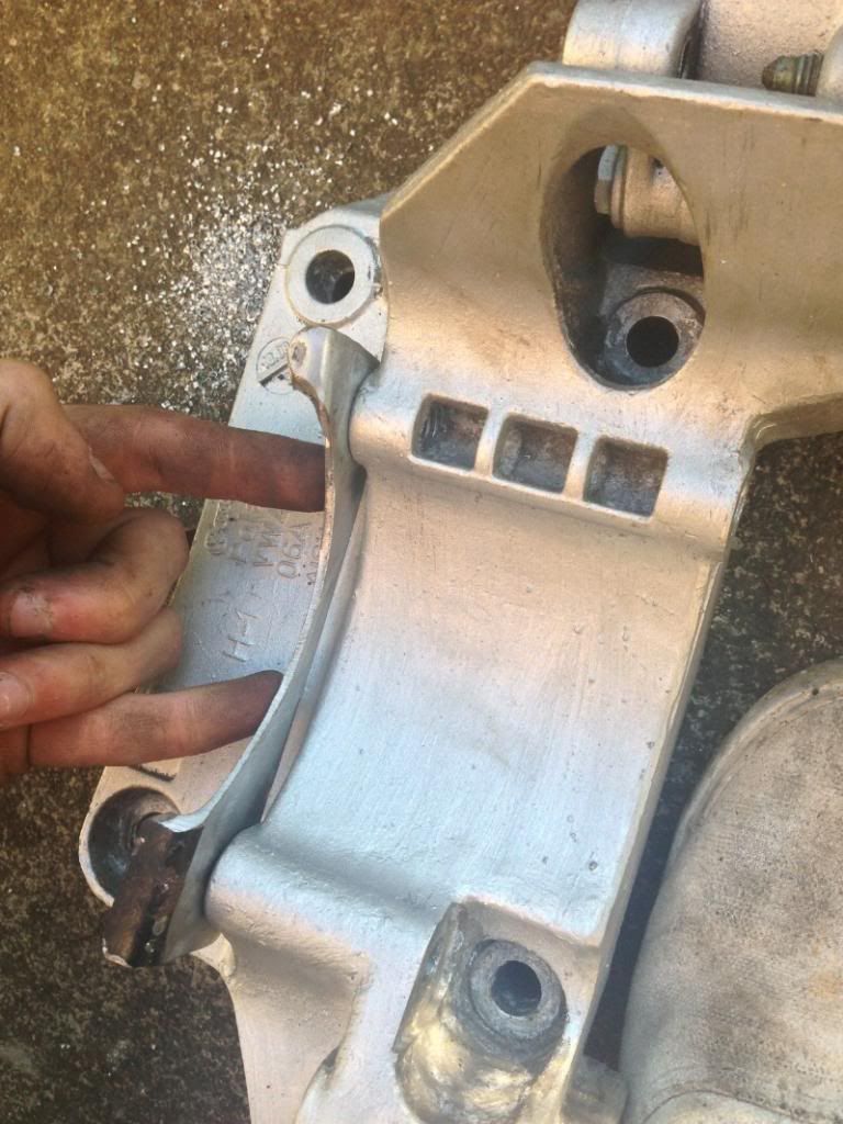

next step was making braked up for catch can.
4" pipe held into location.
Chopped and brackets made to bolt to 1.8T engine bracket.
just need to grab a welder and tack them on now :D
