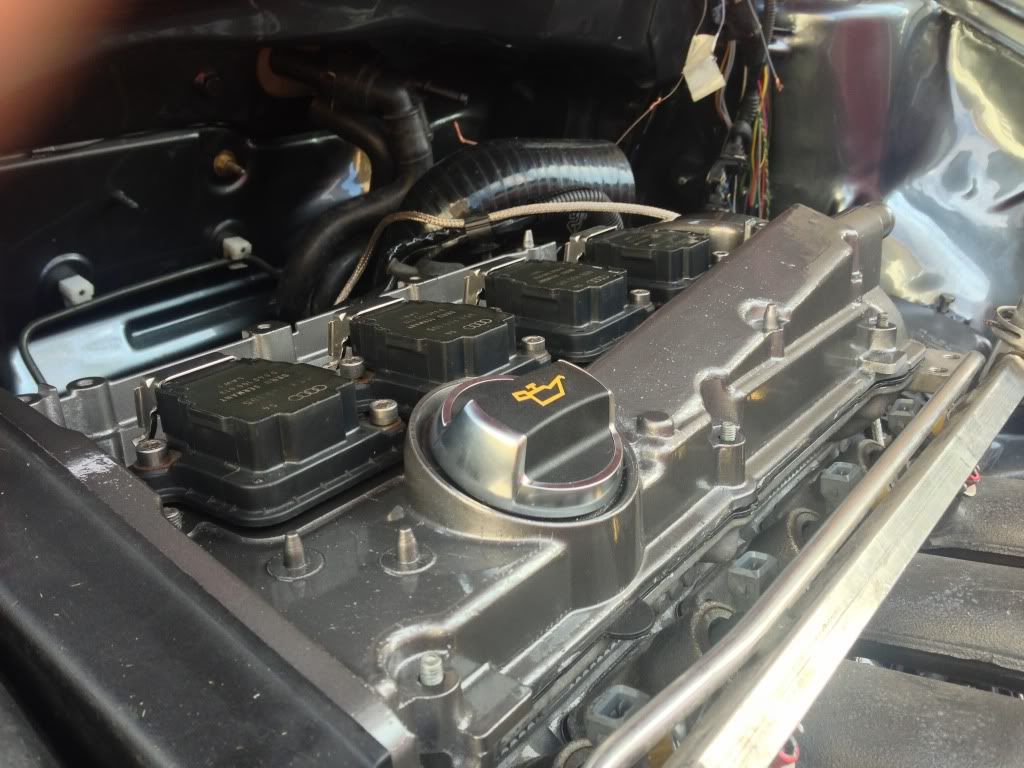

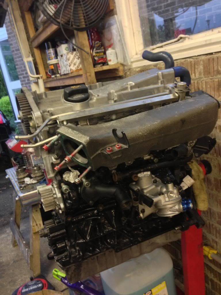

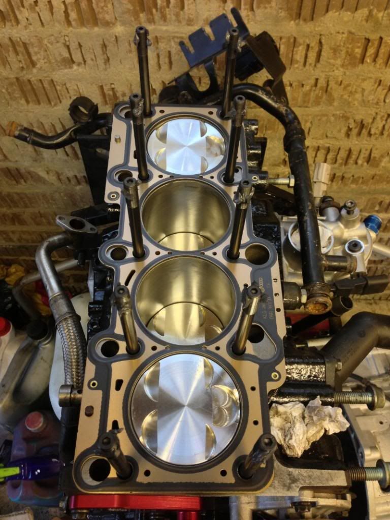

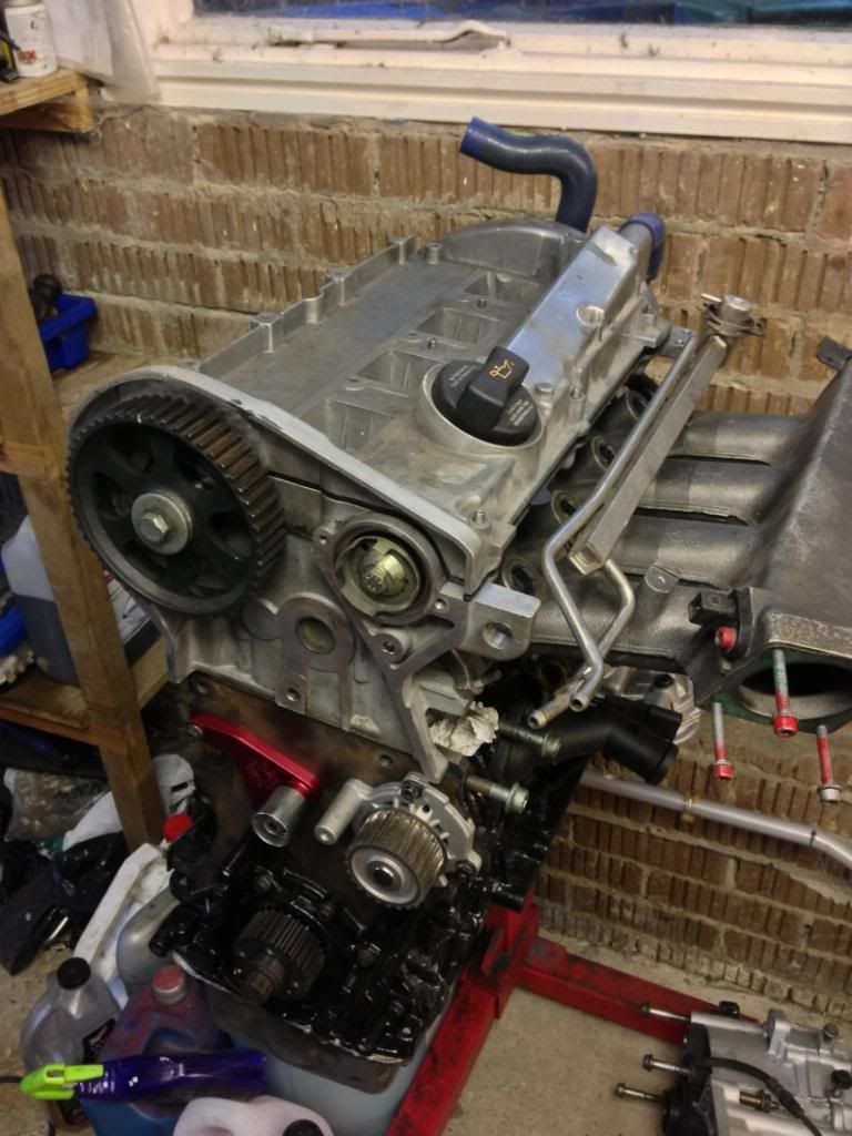

Got head back and flywheel after being balanced yesterday.   Cracked on getting the cams in temporarily as need a half moon gasket.  But got head on the car.
Goodbye shininess :(
And torqued head down...

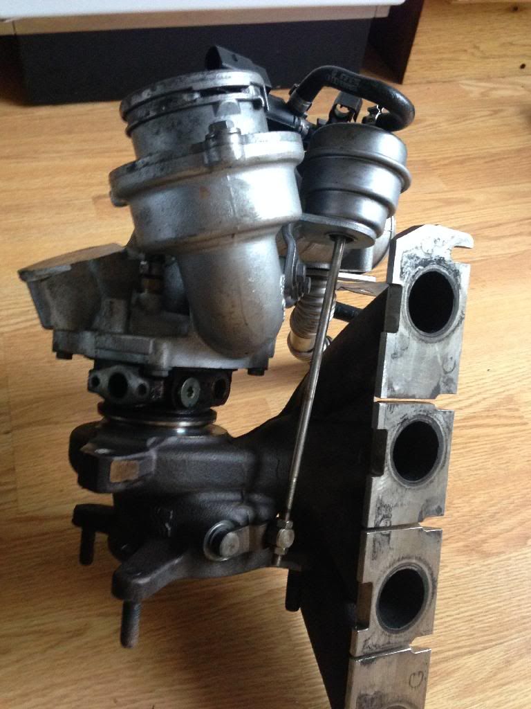

Got manifold back today from Bill @ Badger 5.  Done a excellent job of porting it for me.

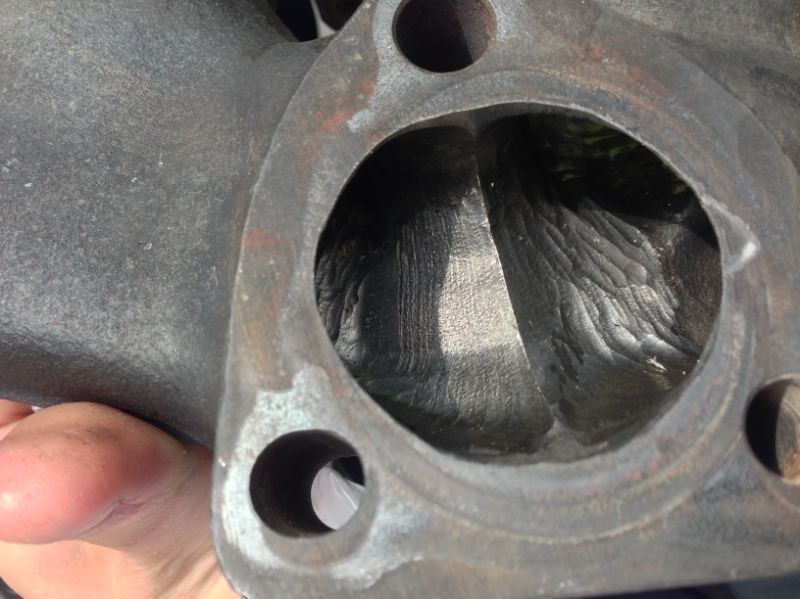

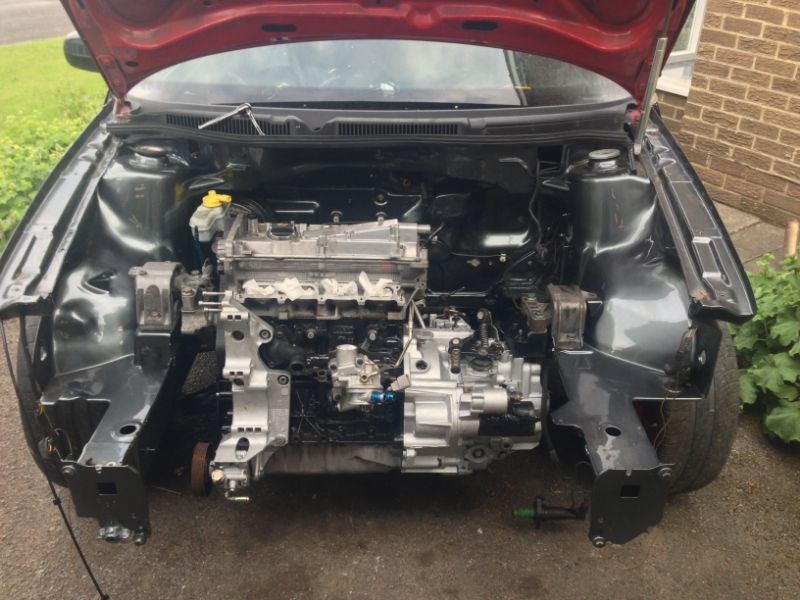

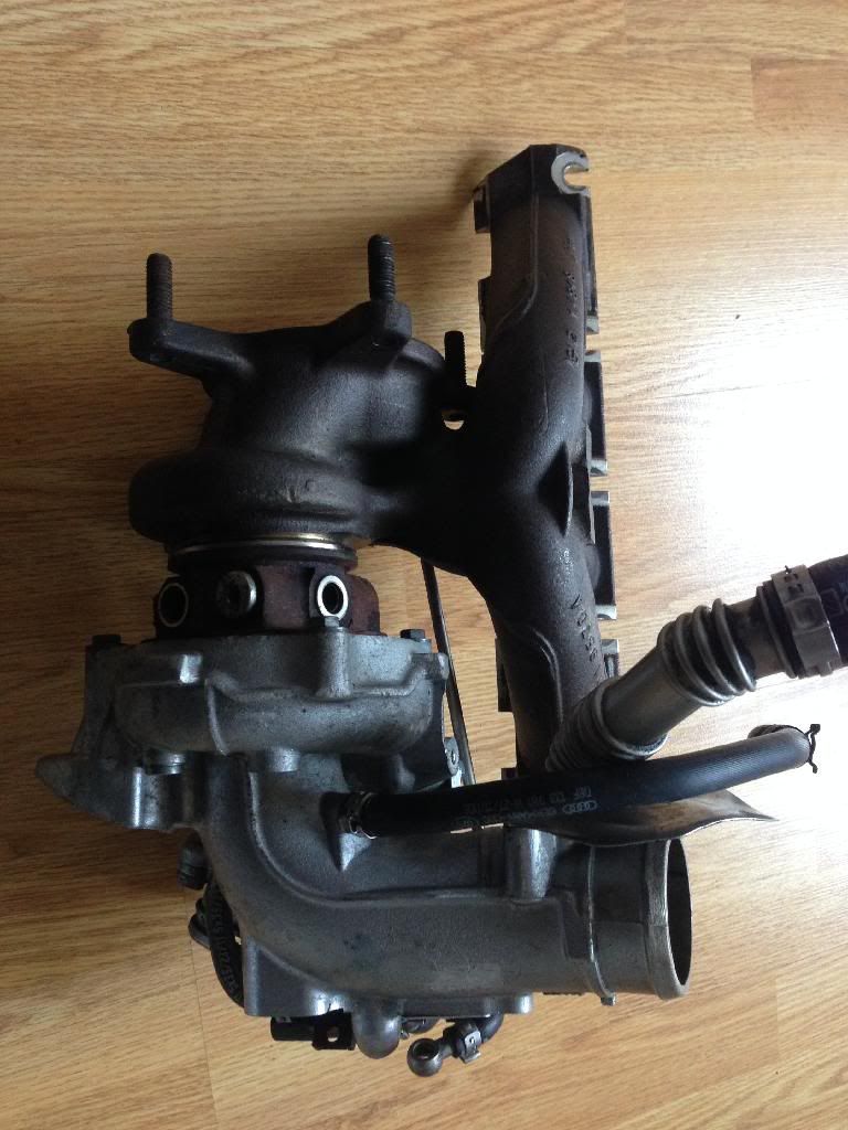

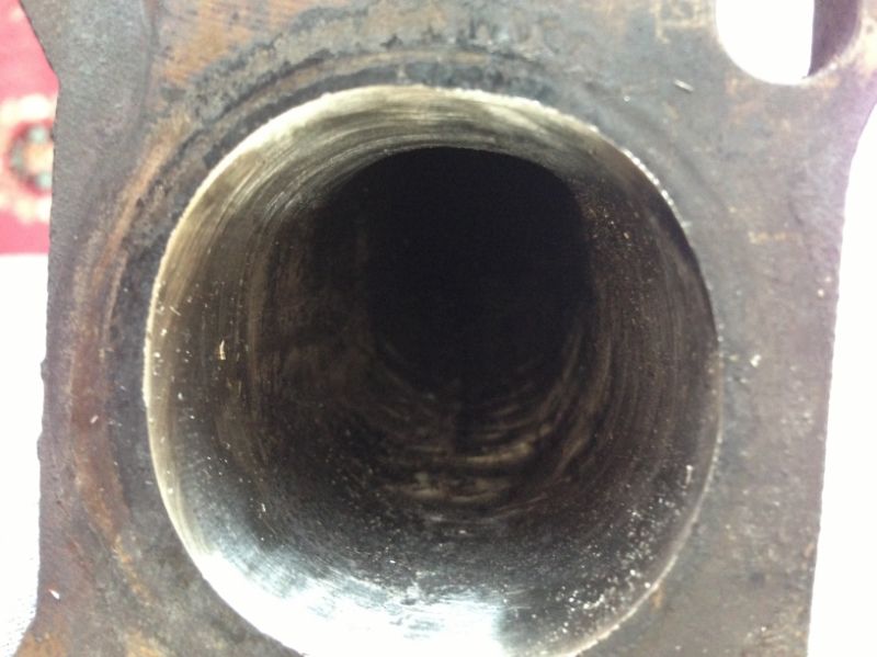

So put turbo on with manifold (still awaiting gaskets) and set about lifting engine in.
Damn it was a heavy one....but looks really well.  First time car had a heart for around 18months!

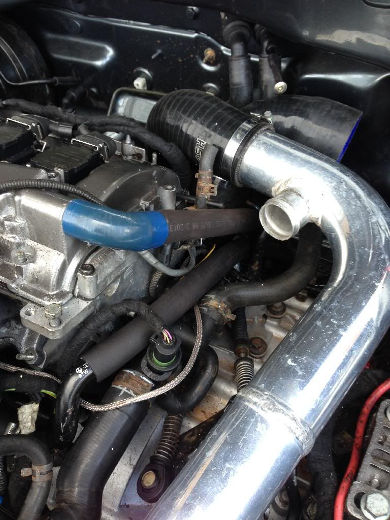

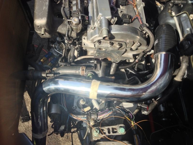

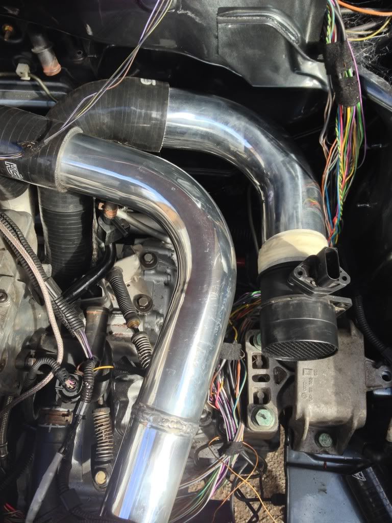

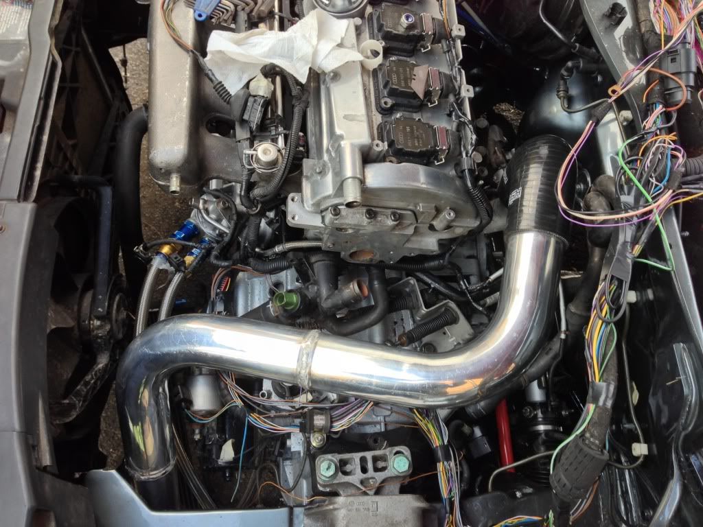

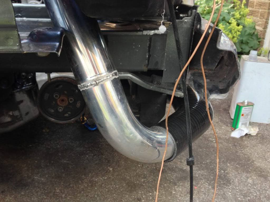

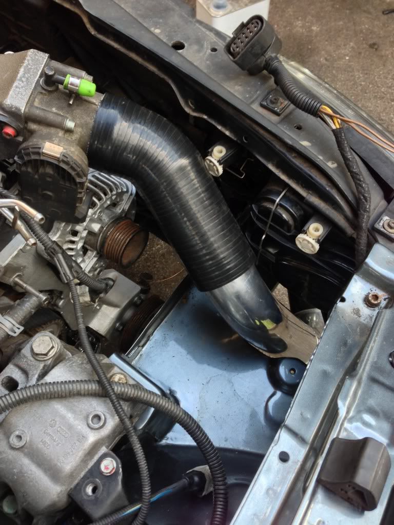

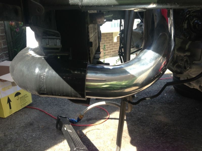

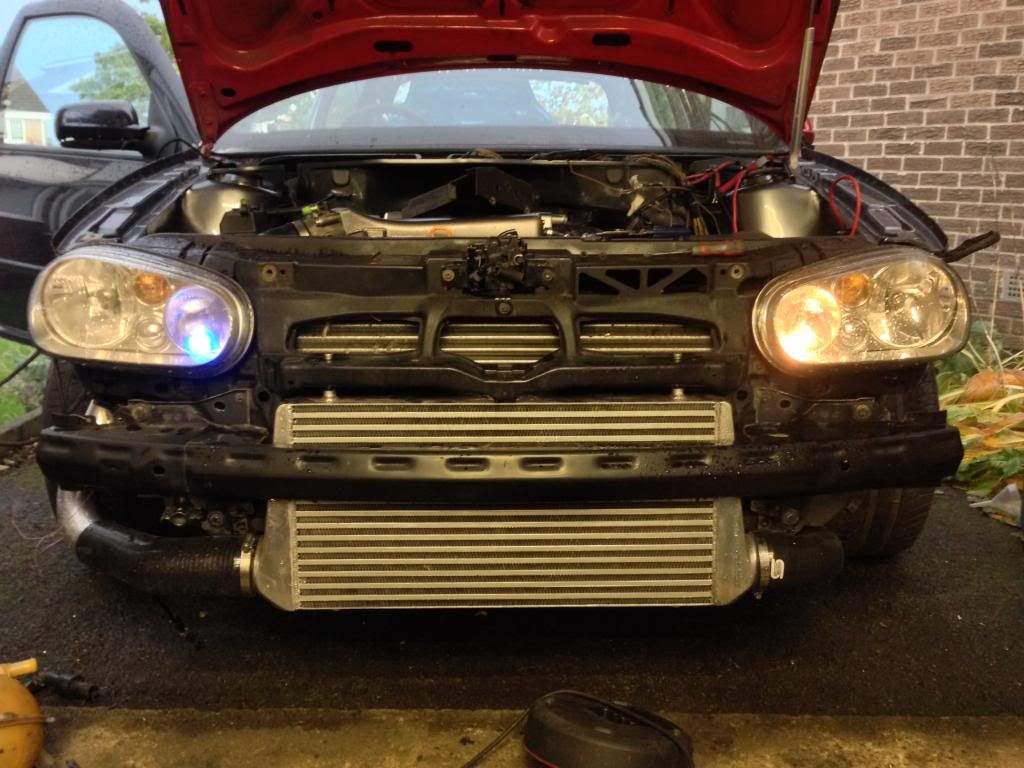

Mocked the intercooler piping up.

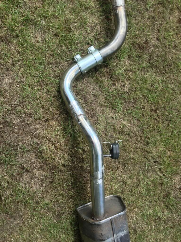

Well ordered a couple more bends for the intercooler cold side and got that mocked up and dropped off at the welders today.  Should have that back sometime next week.

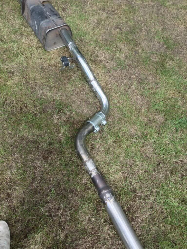

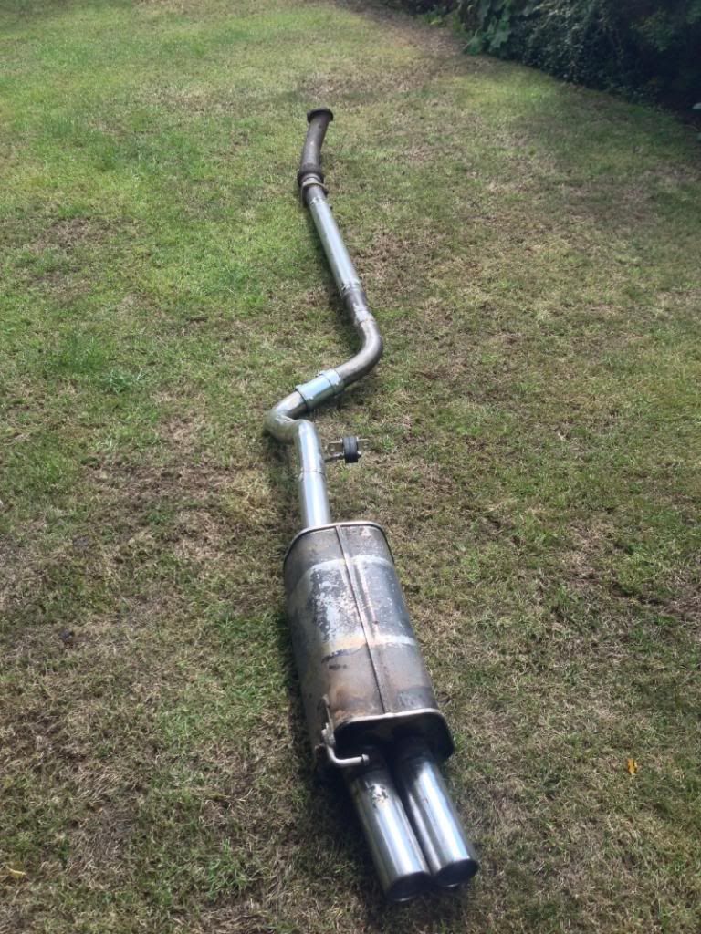

In the meantime, had a right battle with the exhaust... but got there in the end, hopefully it doesnt hang too low or knock off axle or tank but it shouldnt do!
Couple pics:

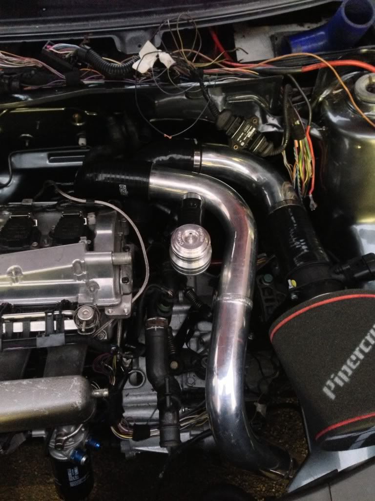

Welded boost piping
made myself a custom TIP

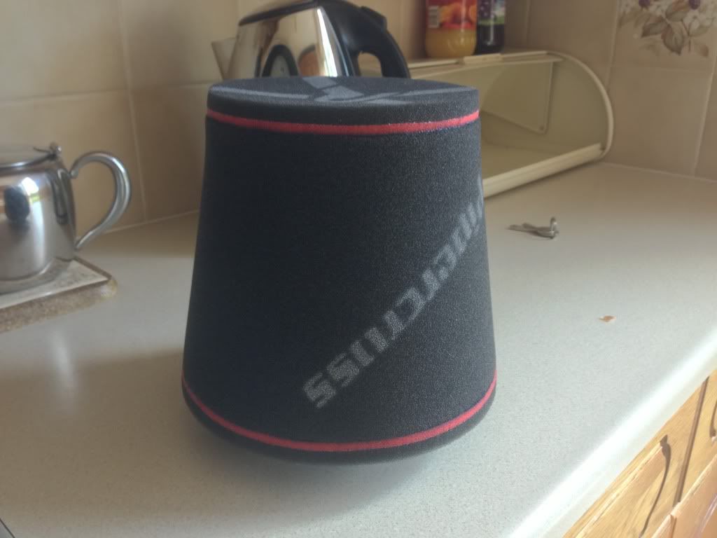

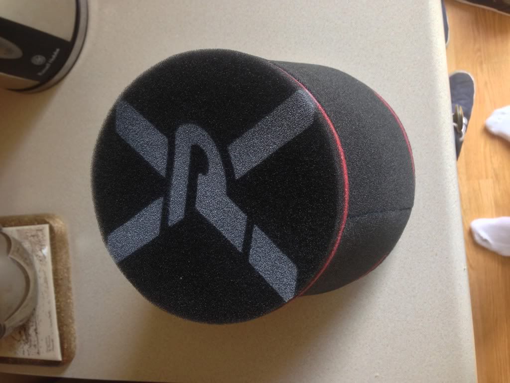

Pipercross filter from Awesome GTI
Mocked the DV return up

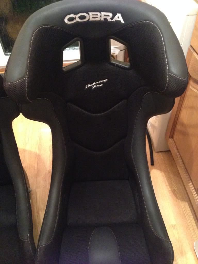

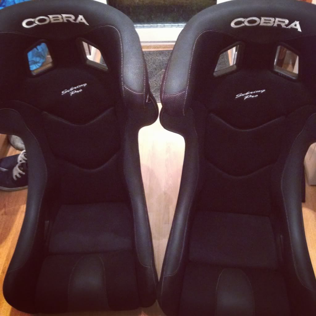

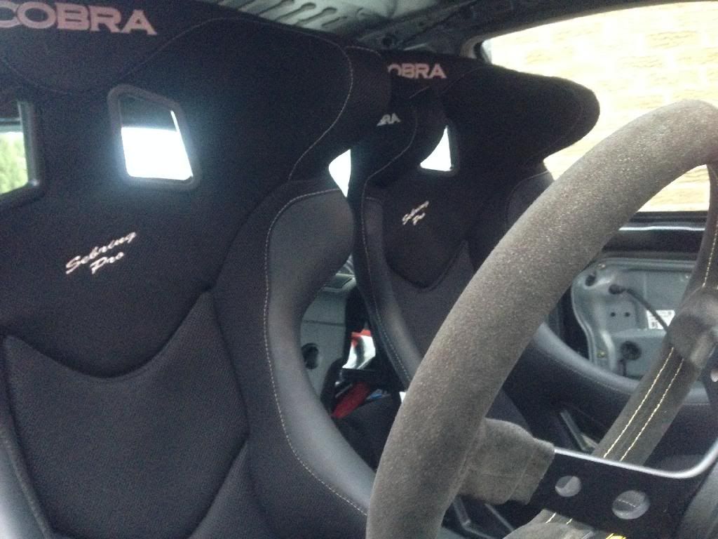

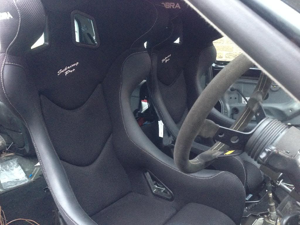

And today (sunday) ive picked some new seats up.  Sooo comfy :)
Worlds comfiest bucket seats!
Cant wait to get some harnesses and seat frames and get them in now :P

Love the pic with the intercooler
Good work.

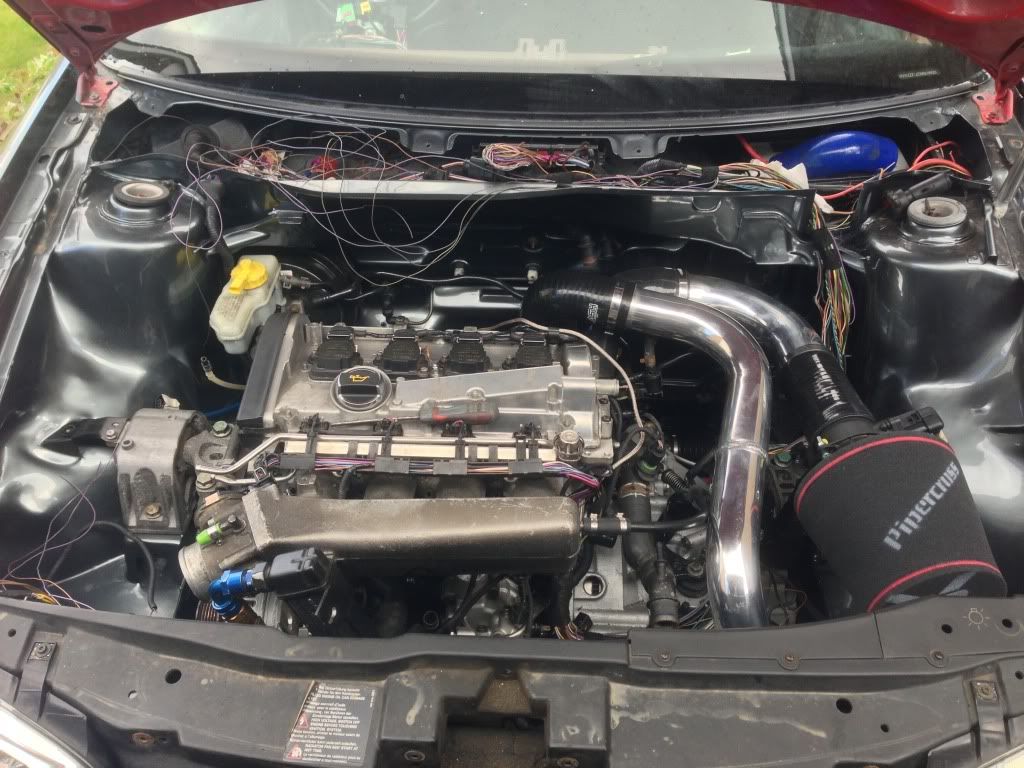

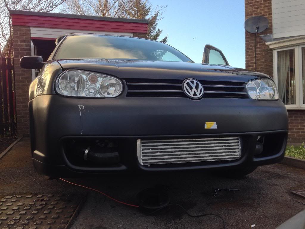

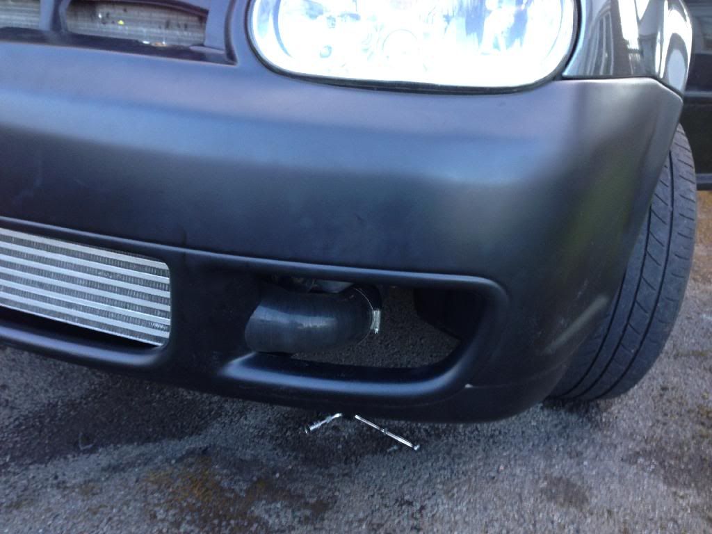

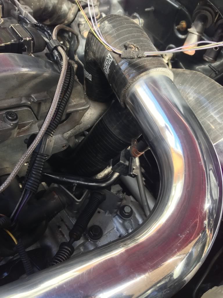

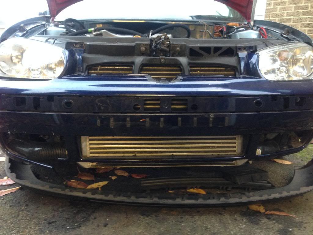

Better pics for you.  Cant get a good angle to take the pics unfortunately.

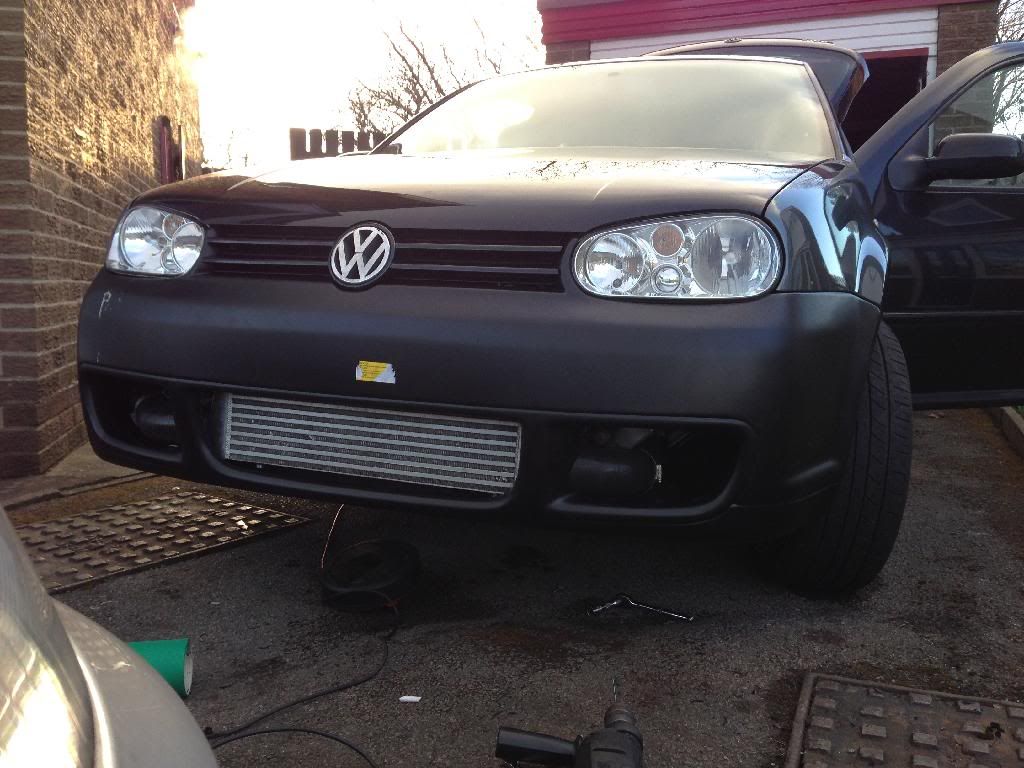

Also started to fit bumper behind the wellycooler.... Generally says you cant fit a big intercooler behind a stock bumper....however.....
TBH, with tight pipework off the intercooler you would probably get away with it.   it'll do me until I get a R32 bumper.

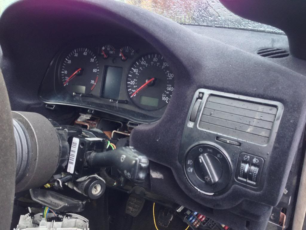

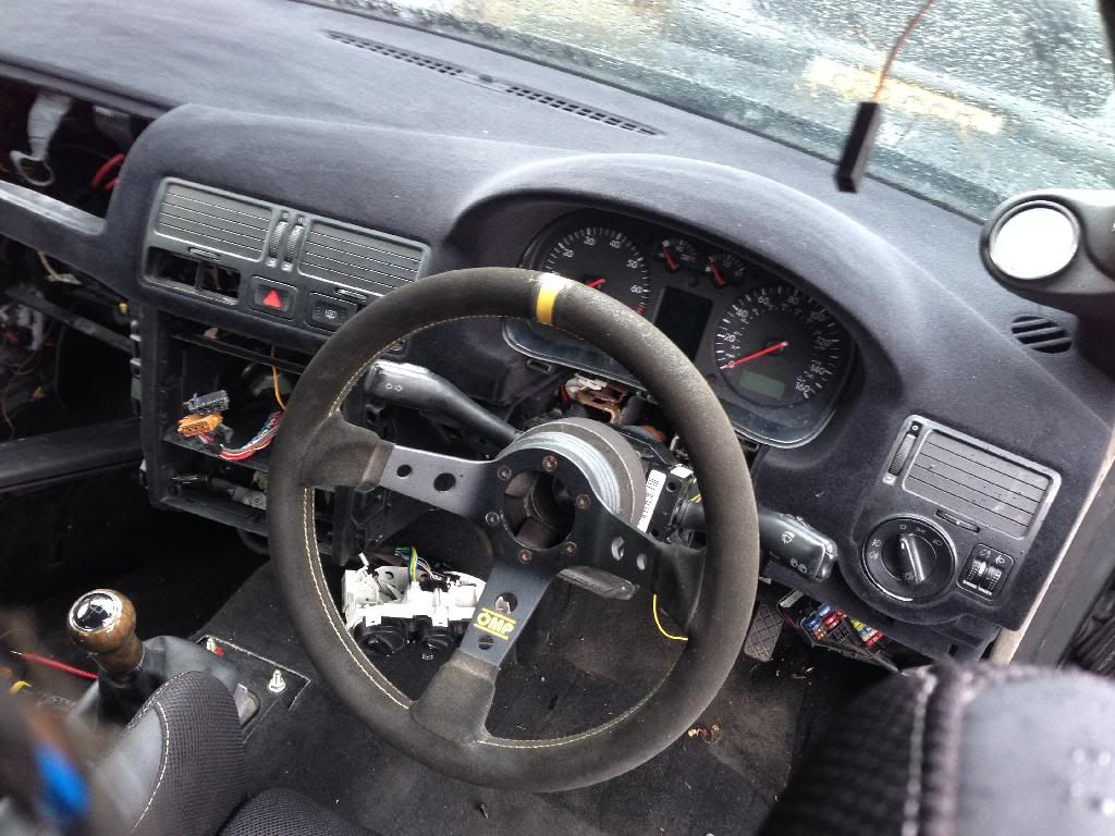

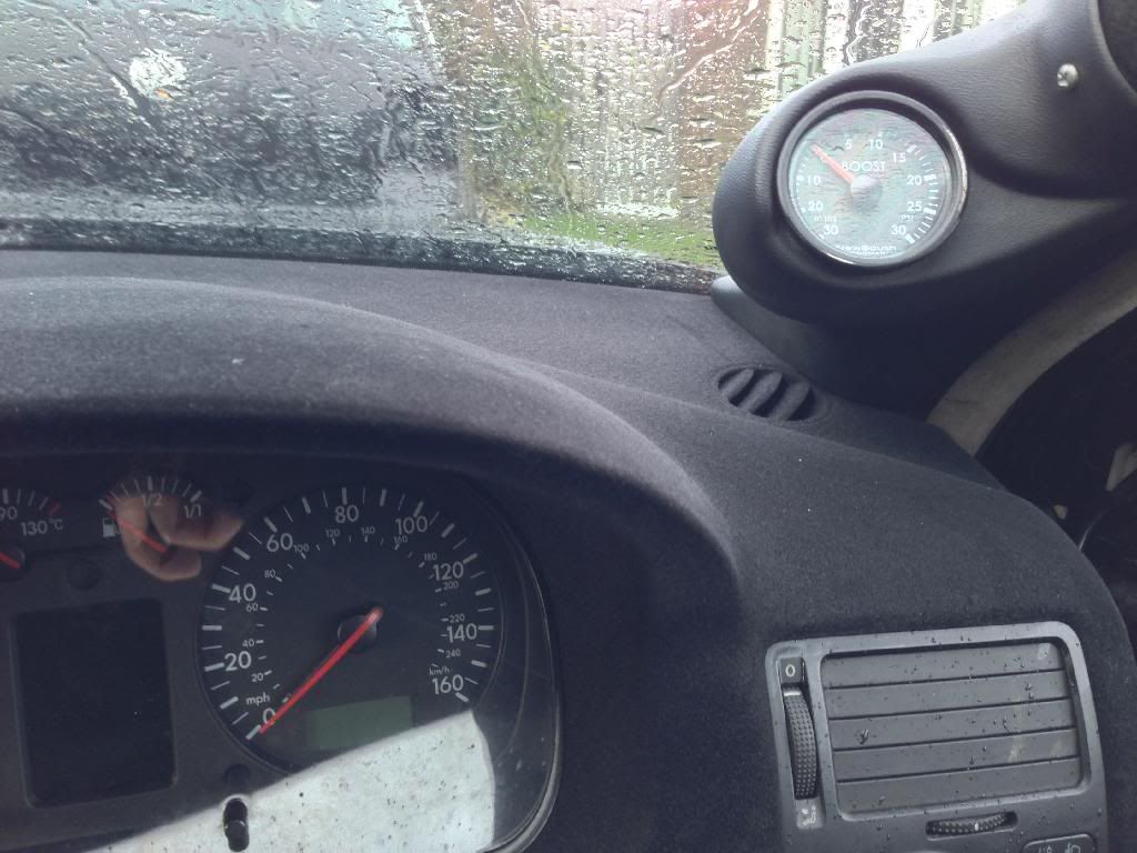

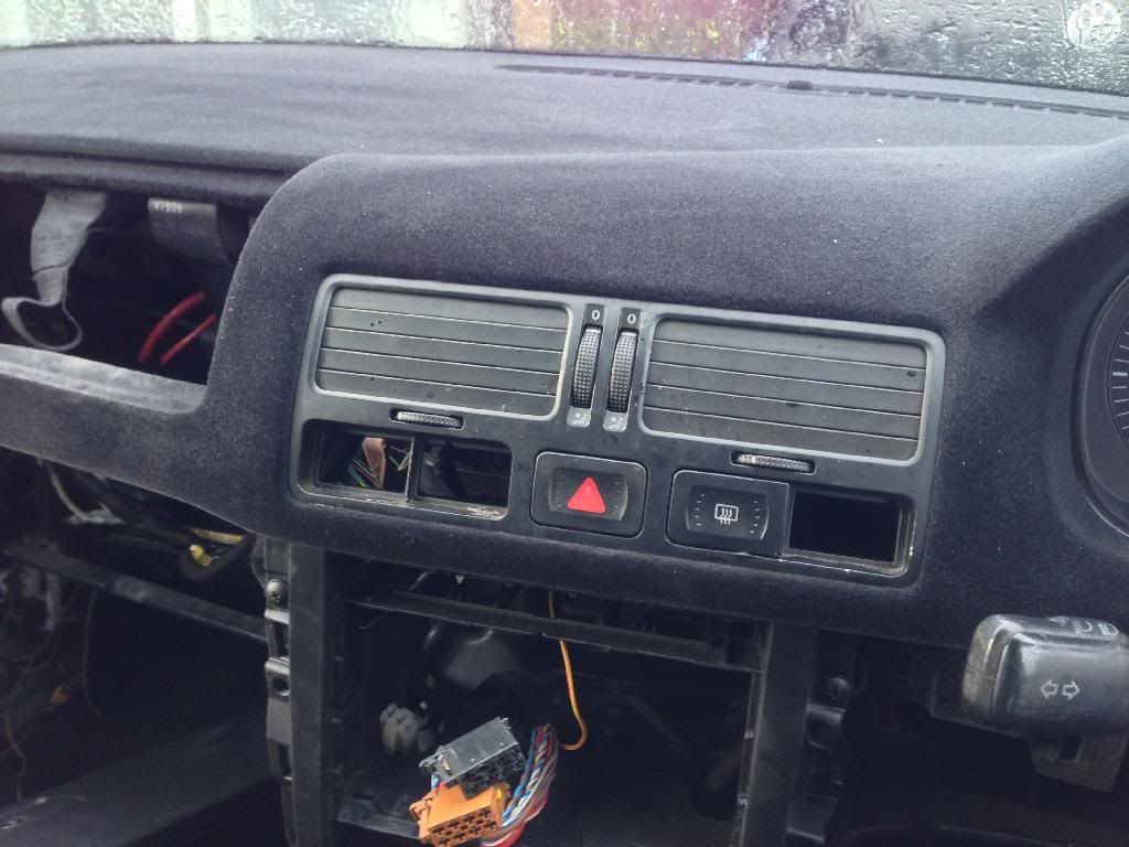

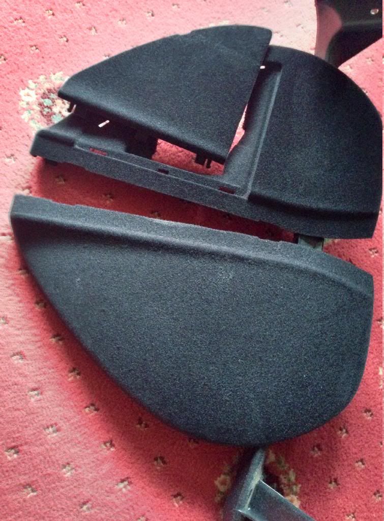

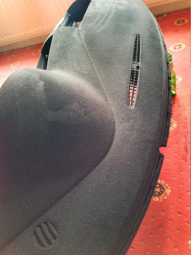

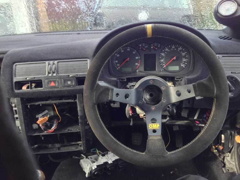

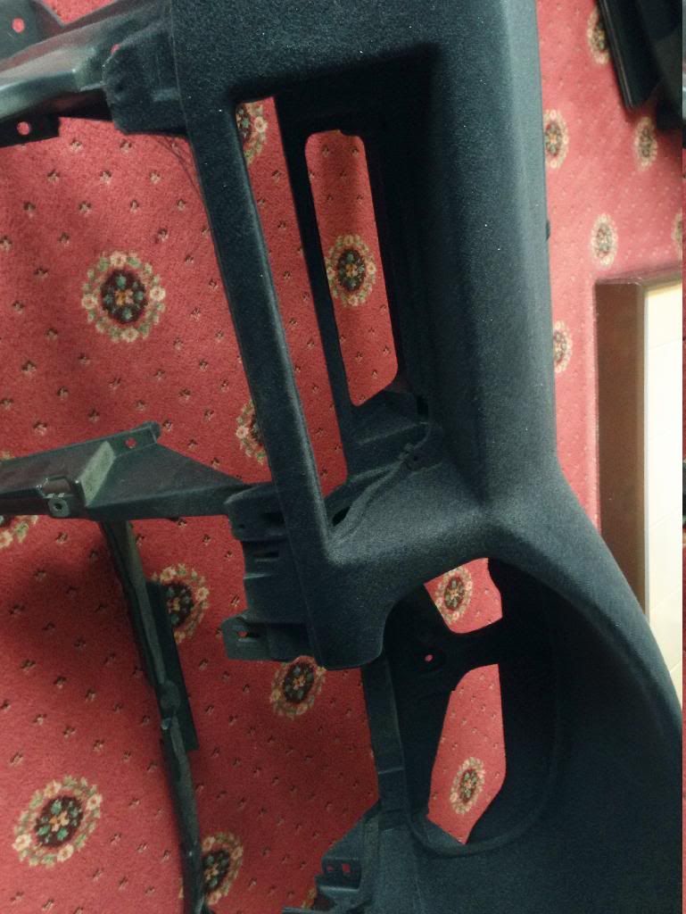

Got my dash flocked at a local place for a very good price:
The lower 1/2 still needs doing when I drop the piece off....but looks the part!
Put dash in since old one was out routing a washer tube for wipers, would be harsh not to put flocked one in.
Not completed yet, but get the general picture.   Think it could be the favourite part of the build!

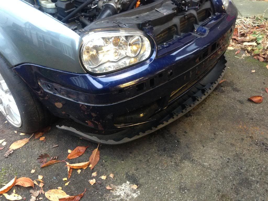

Tried to fit stock bumper today...but realised that its never going to fit....looks like I need to get a R32 bumper rather sharp :(

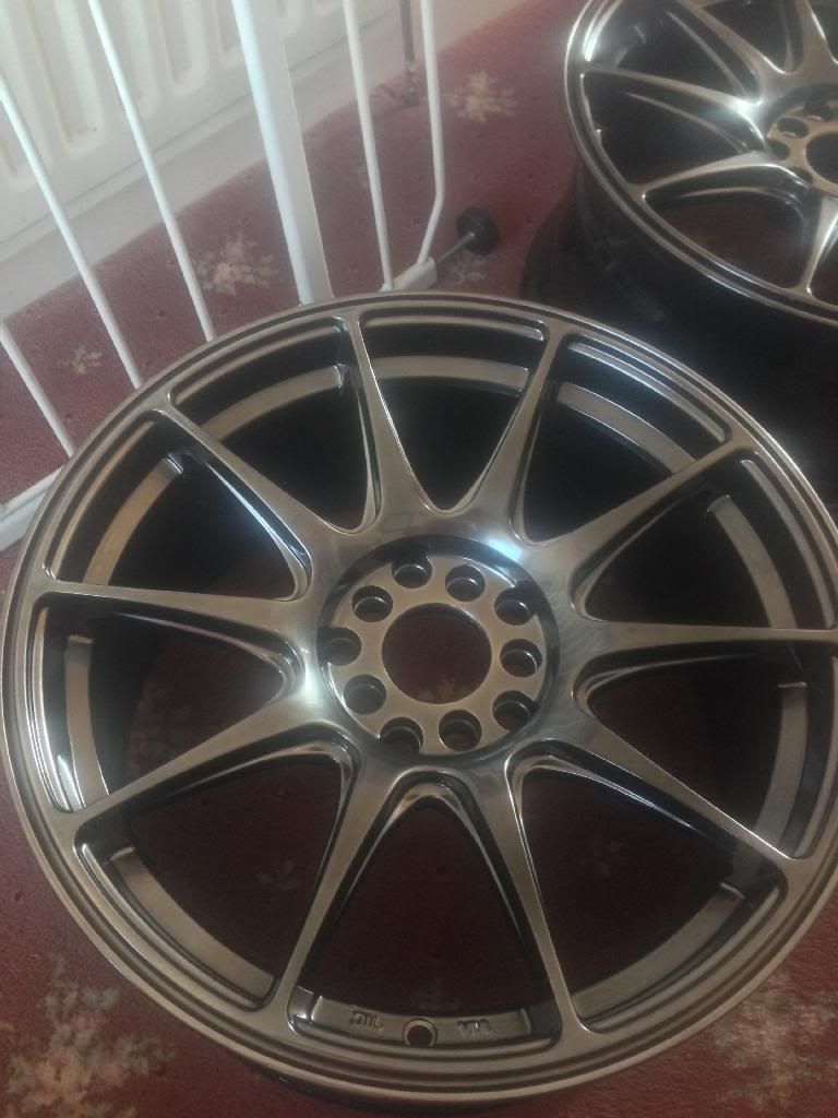

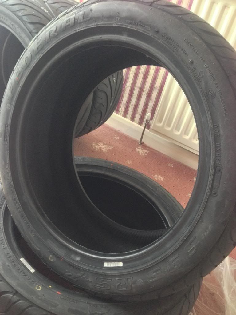

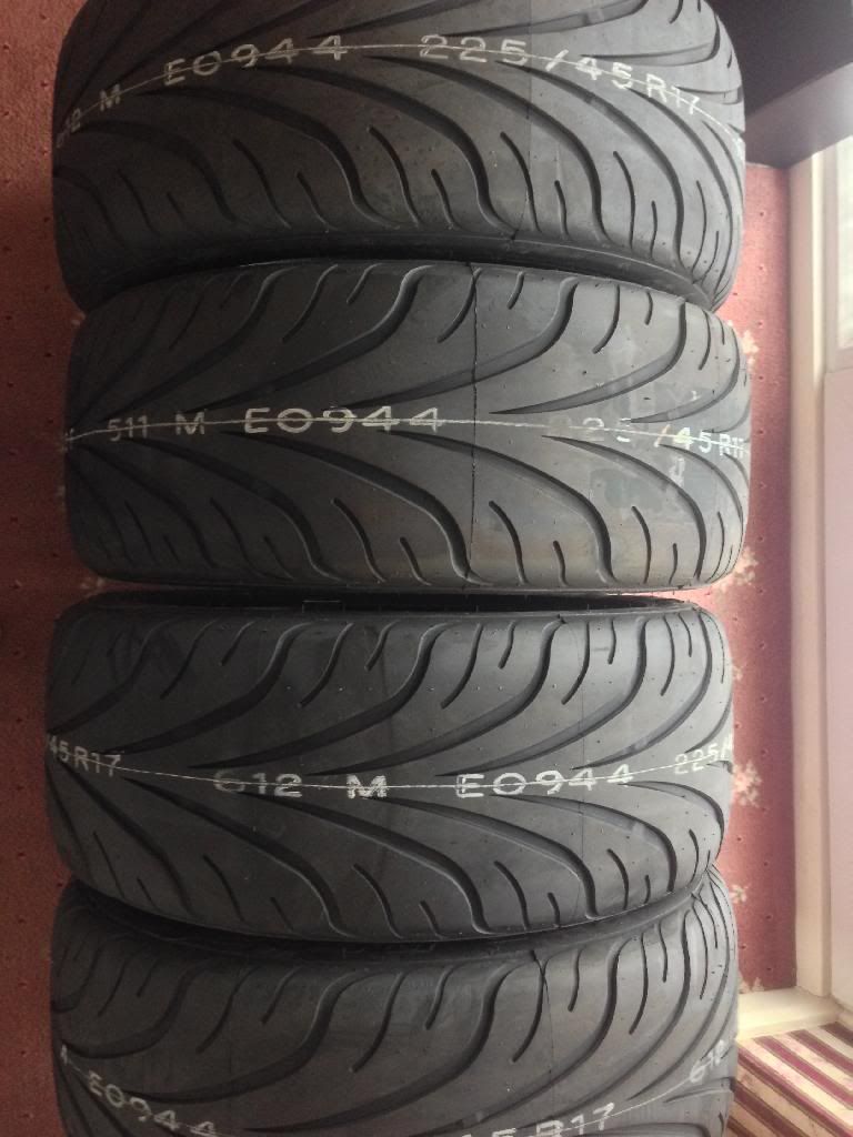

Also ordered 4 new tyres. Some Nice sticky RSRs (225/45/17)
Ordered a R32 bumper, so that should be here soon.
Then the tyres arrived on the 26th February.
Not bad for £296 for all 4!

Wheels should be here tomorrow finally.  Straight onto get the tyres on, then off to Dean @ DWR Detailing to get sealed to protect against the elements.
Got the R32 bumper fitted after messing around cutting old guides off, sticking them to new bumper in right place so it lined up ok.
Spent today cutting around the pipes for the intercooler so its a nice fit.

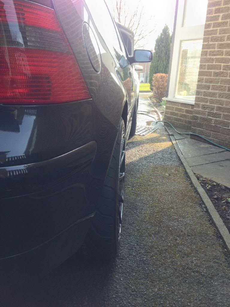

Wheels on

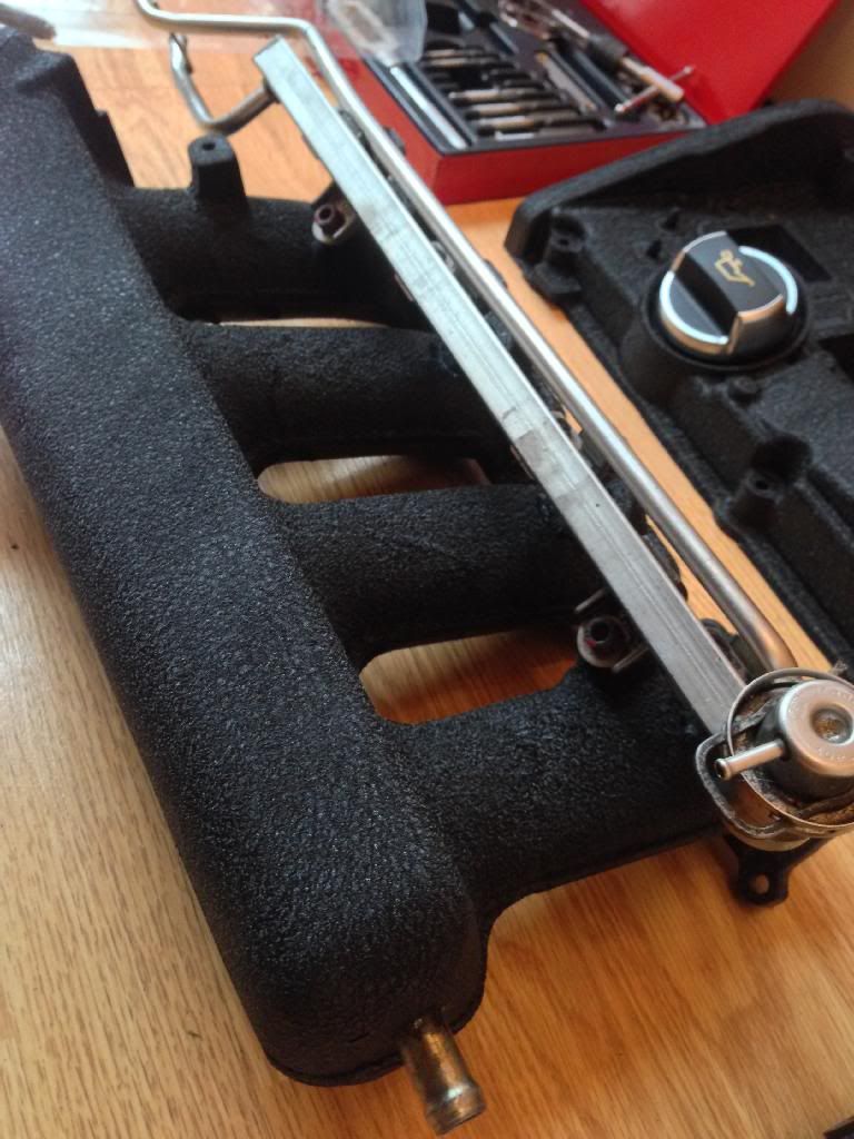

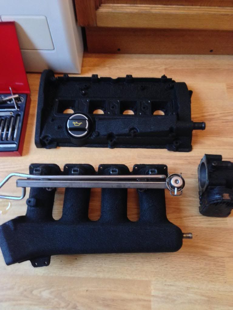

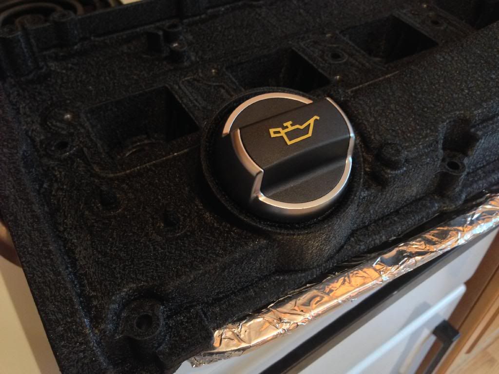

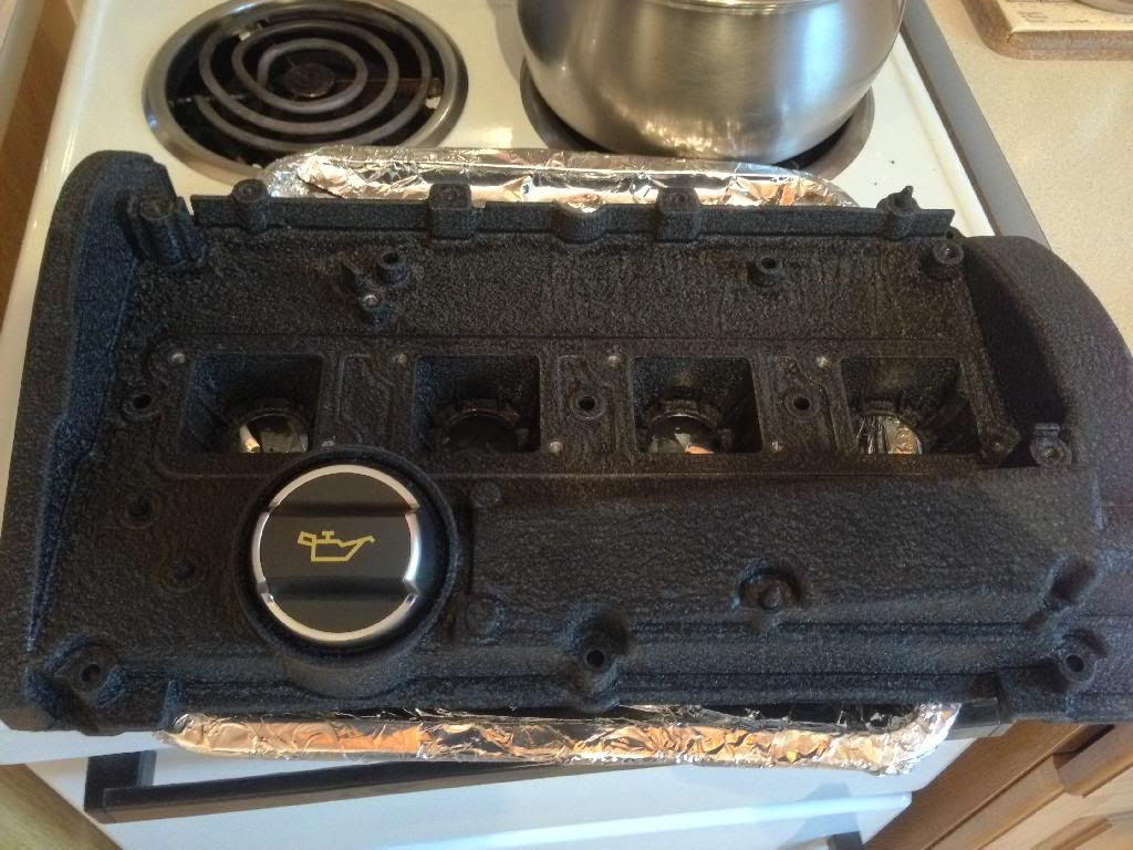

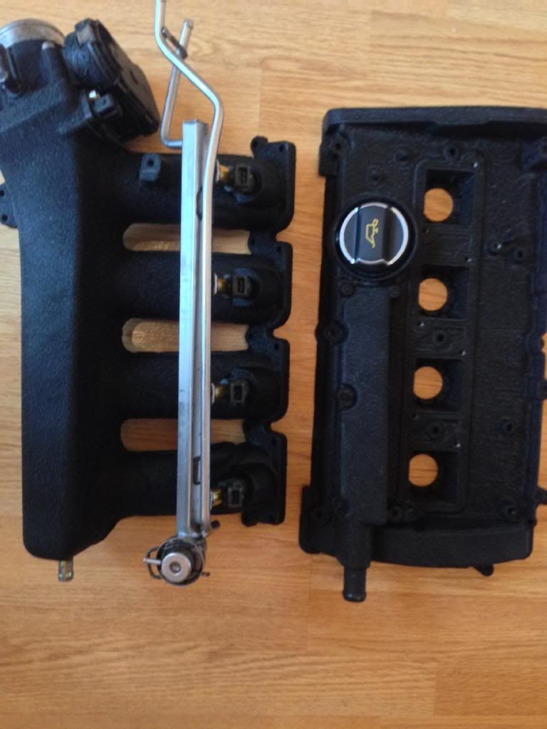

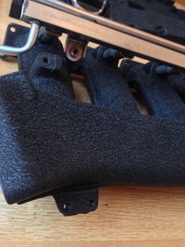

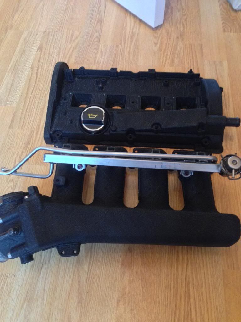

Ordered some VHT wrinkle black to do the rocker cover, inlet, throttle body and engine mounts so that should tidy them up neatly too :)

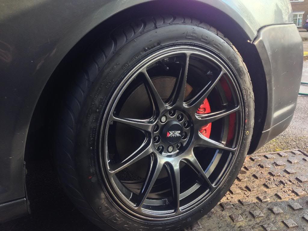

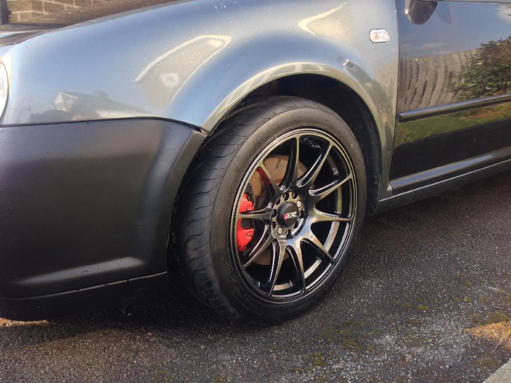

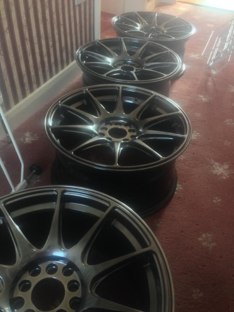

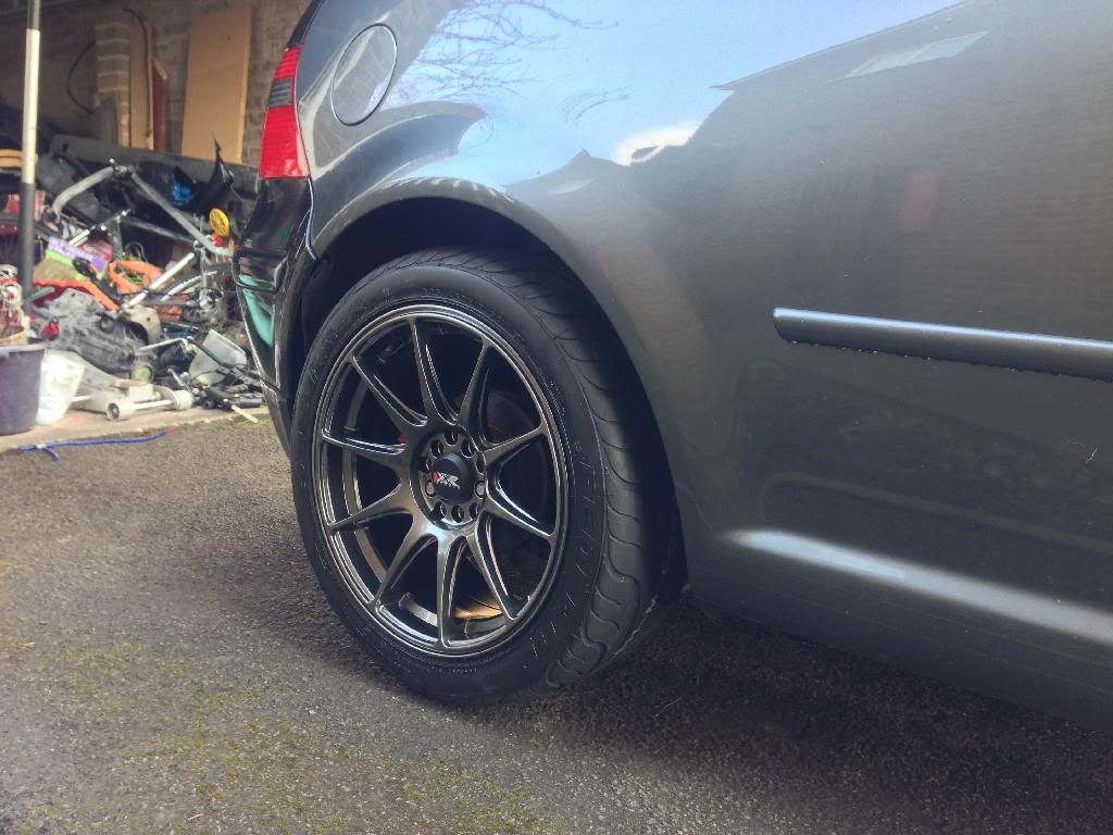

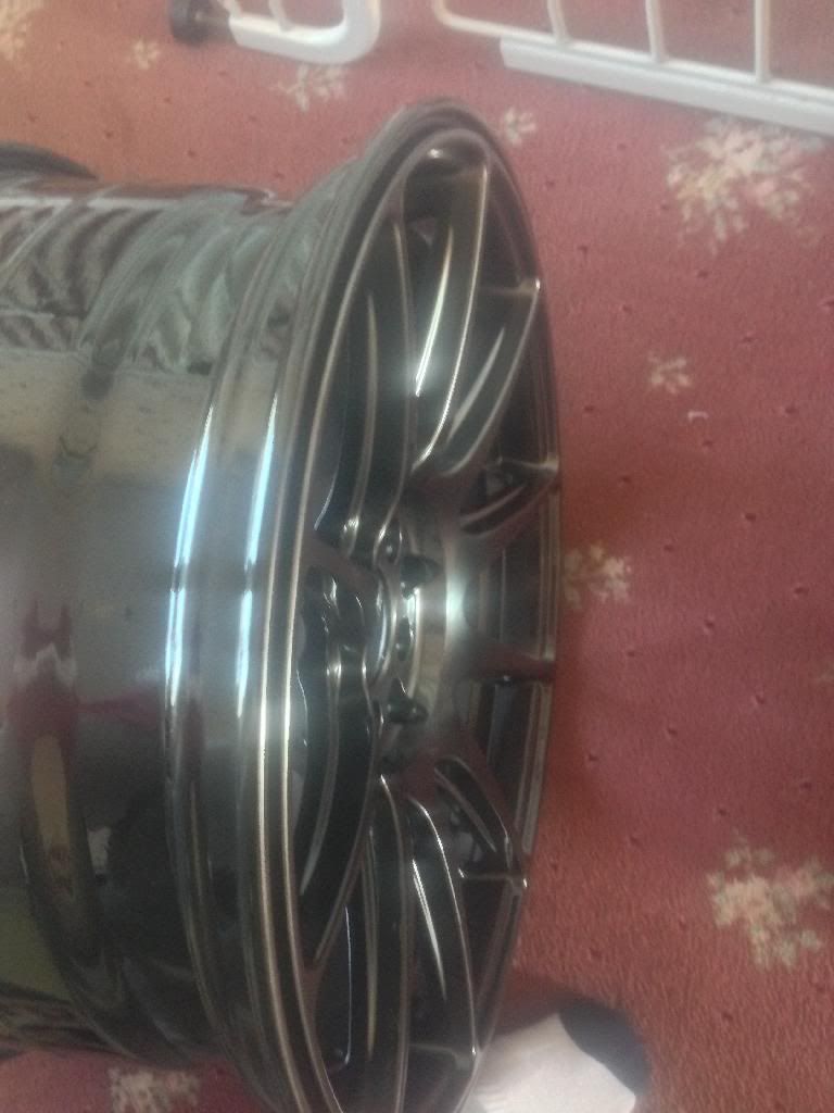

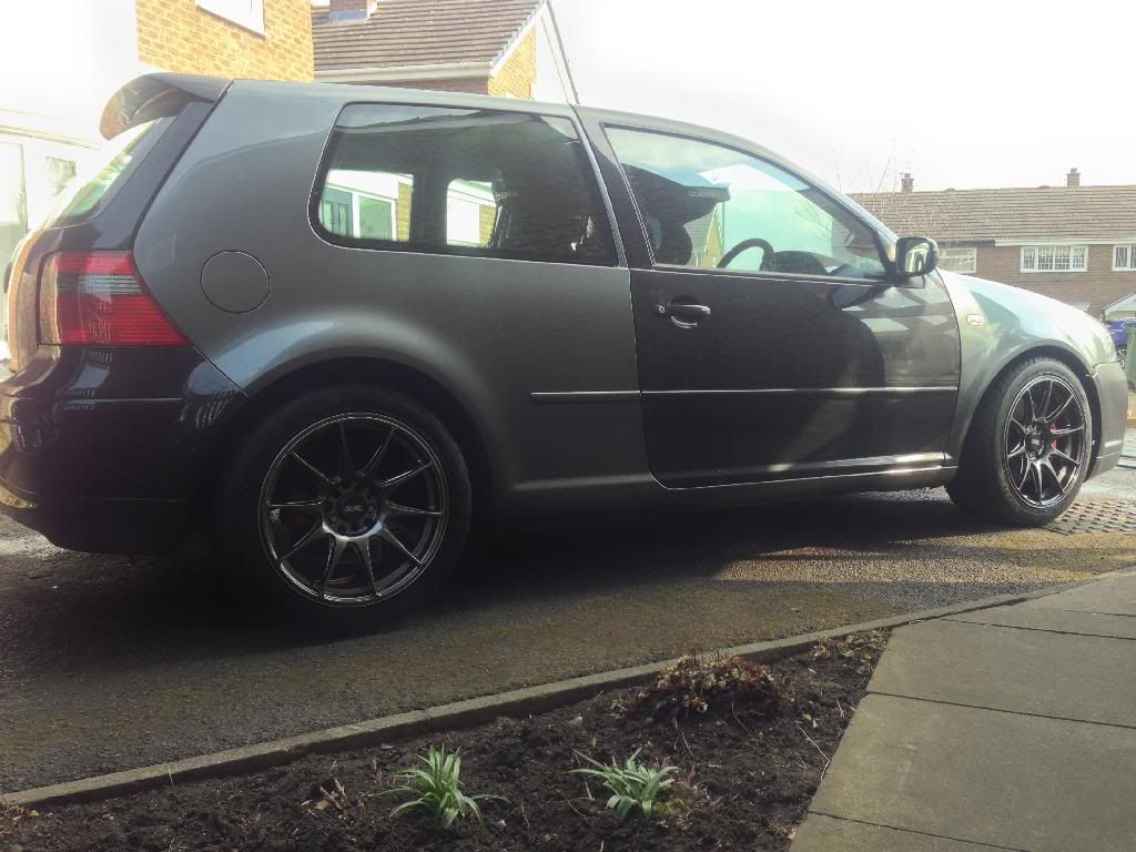

Wheels come monday 29th March,  straight over to mates to get the RSR 595s put on.  Got them back the next day and dropped over to my other mate who does detailing to protect and seal the wheels from the harsh UK elements.
Got them back wednesday afternoon and go to put them on the car...only to find the company had sent the wrong bolts,  they had sent a M12 instead of M14!  They were swiftly swapped over, but I managed to get a standard bolt to fit so got the wheels on!
Also, ordered some VHT Wrinkle black to paint my rocker cover, inlet and throttle body with.
Got that done Friday morning whilst people out the house all weekend so I could sneak the parts into the cooker to properly cure :P
Going to get the bumper bolted up today if the weather holds out,  get that bolted to the arch liners.   Got the coolant return to sort out too, which shouldnt take long, and assemble these painted parts back on the engine.

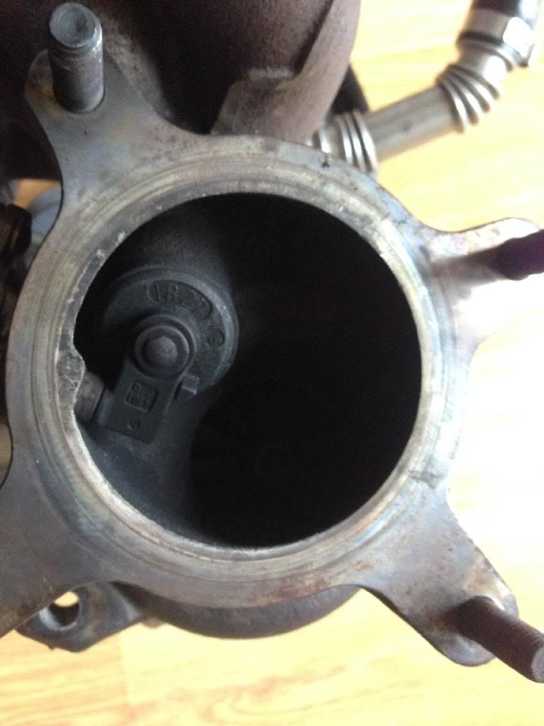

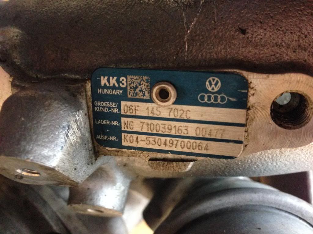

Also, new turbo turned up today whilst I was out at work :P
Need to get my supertech head built now, and the rest of the gear for the conversion :P
