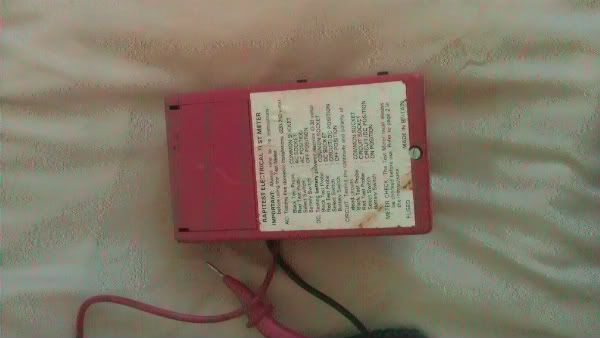

I found this in the shed, can I use this to fine the live and ignition live? how do I use it?
Cheers again guys  :smiley:

Put the red lead off your tester onto the wires in the Brown connector and the Black lead onto a good earthing point like the door hinge. When the needle moves up to the 10/12 volt mark then you have found your permanent live. Do the same again with the ignition on and a different wire should turn to 12 volt on the meter and this is the ignition live. You need both of these to keep a memory.
