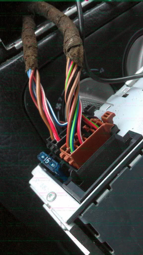

It would appear its not as simple as that! I have no yellow wires to swap and the stereo plugs straight into the original connectors :angry: any other ideas? It's a jvc head unit if that's any help.

grab the yellow wire and the red wire, it theres no point to disconnect them at, then just cut them, swap them, twist and tape em up.
I have no yellow wires buddy!

« Reply #6 on: 28 August 2011, 01:00 »
Guessing you've got an early mk2, basically they didn't have a switched live at the radio red was 12v+ constant and brown was earth but their was no switched. You'll have to either tap into the rear window heater switch which usually has a black or yellow wire (ignition feed) or take the black or yellow wire from the ignition switch harness.
A lot easier than it sounds ...

« Reply #9 on: 28 August 2011, 08:54 »
How would I go about 'tapping' into the wires? and where about's on the plugs (link is above) do I need to attach the wire? Cheers again!
