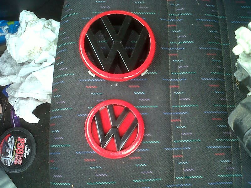

Looks to me like your spraying waaay too much paint onto your badges. Lots of very very thin coats are much better than a couple of thick ones, it's particularly bad on the rear badge :wink:

Thaanks guys, its not the best but it will do for now  :smiley:
As for the badges i have another idea that the misses suggested yesterday si might try thattomorrow after my DRIVING LESSON! come on! aha  :wink:

When spraying the rear badge take the backing plate off and colour code it, or remove altogether, other wise it looks like a black blog on the car  :wink:

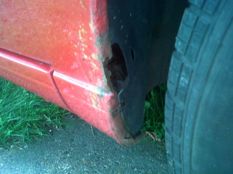

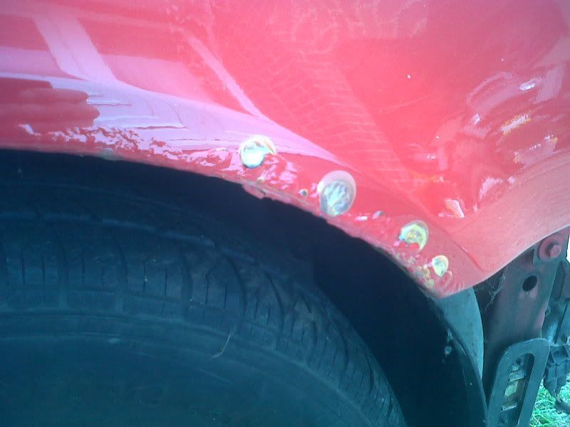

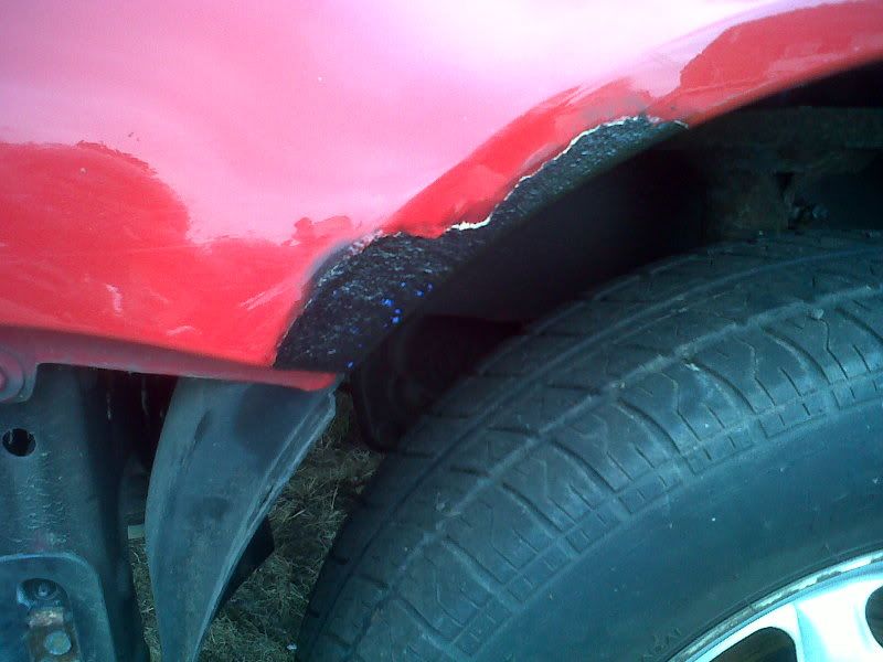

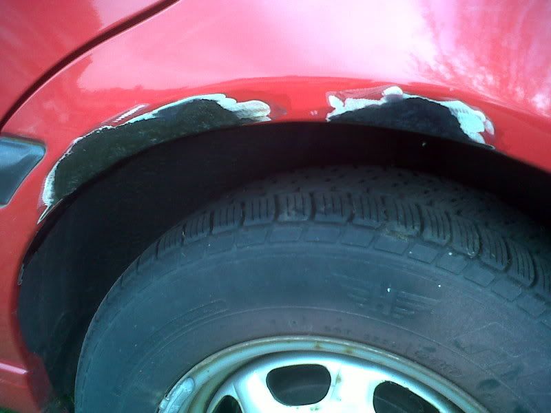

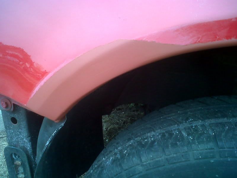

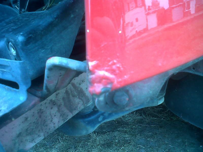

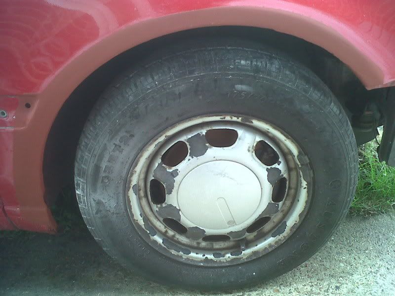

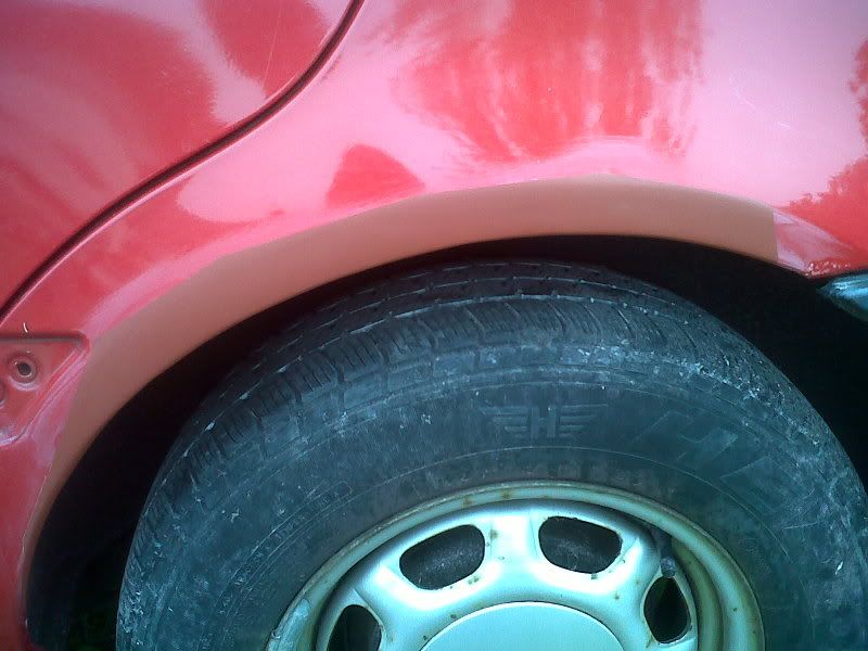

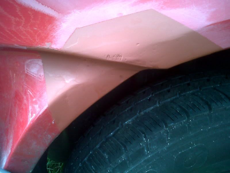

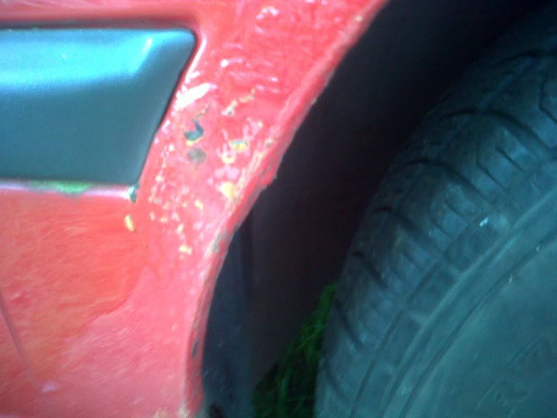

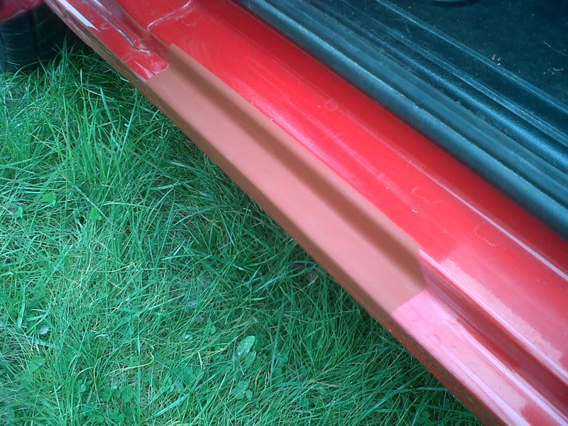

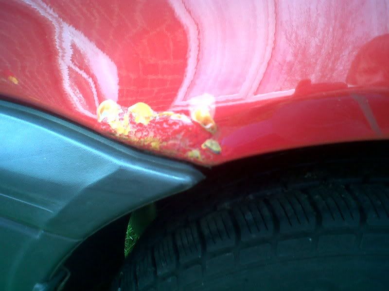

So i thought i would find all the rust on the car and make a start on getting rid of it, for looks mainly but i think some of the patches may have been questioned on the mot. So i began to grind the patches down until i got right down to the clean metal, i then applied some stuff called krust? my dad told me to coat it on it goes on blue and ends up turning black so i did this on all the patches then painted red oxide on, just to help protect them a little, after this i then got on with filling and sanding filling and sanding filling and sanding and so on...... most are now done and coated with red primer but there a couple more patches that need a little more filler but no biggy. so here are some before and afters and just general progress  :smiley:
So first front right wing before
Now it looks like this, nearly done just a little more filler  :smiley:
Rear right wing before
Now
Again not finished but pretty close
Front left wing when i had applied krust
Now
Im pretty happy with this one  :smiley:
Rear left wing
Now
And the worst one witch i did not get a photo of was passenger front door sill but it looks like this now, not done but again very close
I jhust found this litle bit of rust aswell so might do this at some point  :smiley:

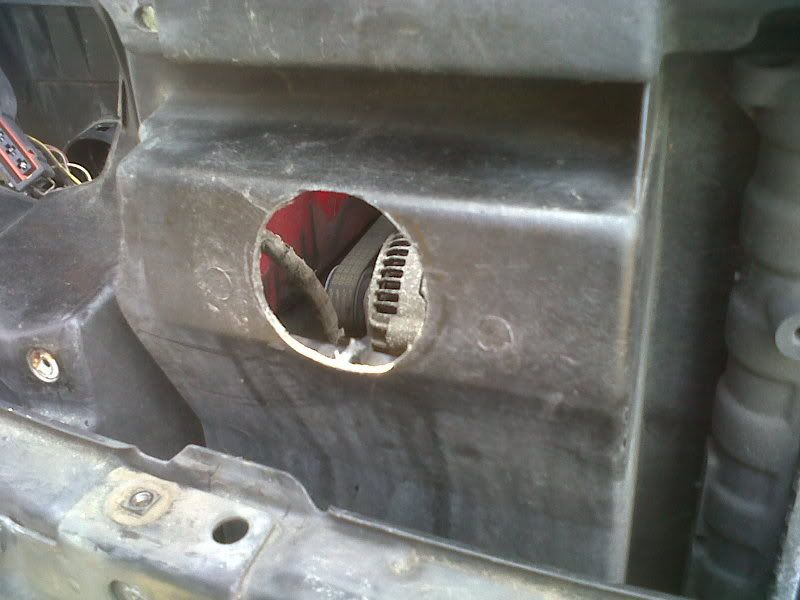

Aswell as all of that me and sam (rcsammy) Made a hole for my cold air feed pipe, not fitted yet but im going to get it through the mot first  :smiley:

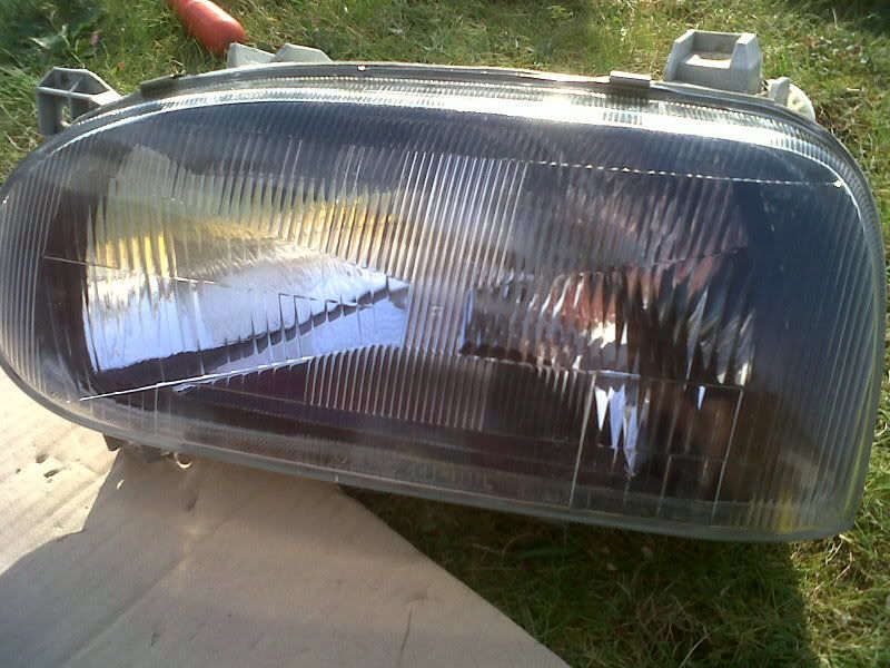

Whilst all of this was going on my girlfriend kindly offered to paint my badges and re do the paint on my headlights for me ( she enjoys art and painting)  :laugh:
Joey mod now done
And this is how my badges look now, i like them well chuffed  :smiley:

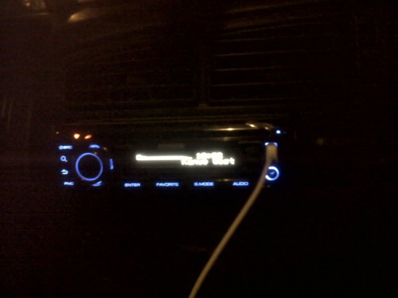

Have not done a lot to the car really, bought a few parts from the scrap yard like a radiator (have not fitted yet) New left headlight as i f**ked the other one up, gti rear lghts and a really nice headunit  :smiley:
Also done a little bit of work on the rust patches, 2 are now complete leaving me 3 left to do either tomorrow or thursday, will post photos when they are all done.
So here are a few photos  :smiley:
new head unit (£20  :cool: )
GTI rears
joey modded headlights done better and now complete.
