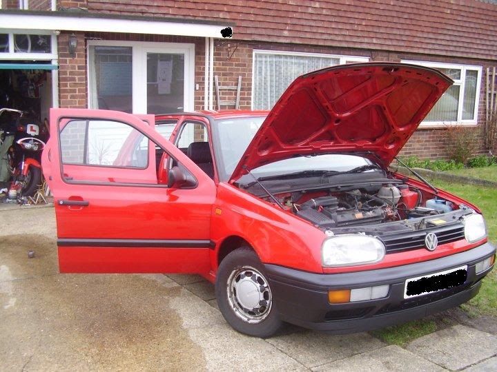

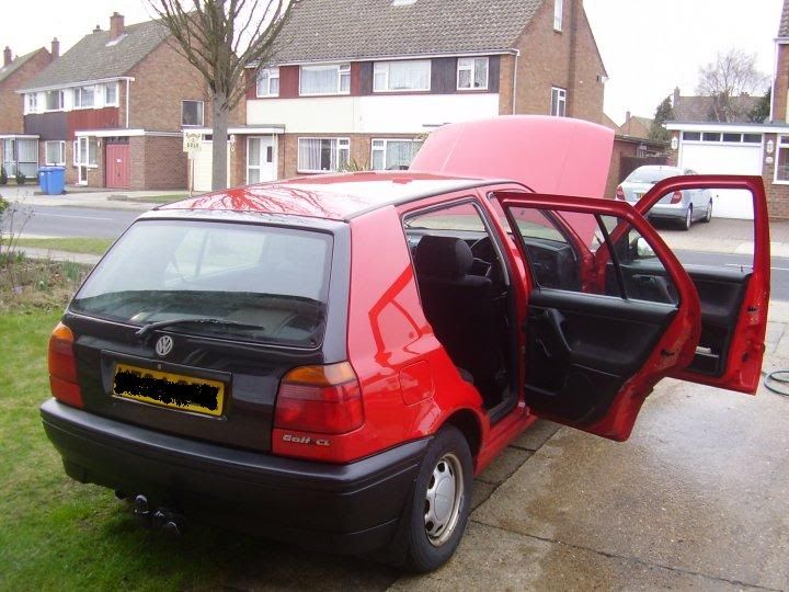

So here is a photo of it after a good clean
As you can see, i have done the bonnet mod and i had to change the rear tailgate as the old one was rather rusty, im planning on doing the swiss cheese mod, the joey mod and change the dash board lights within the next few weeks.

Welcome mate... Just posted my 10 pence worth in your problem thread... car looks pretty solid, can't complain for what you've paid for it!  :grin:

Shell looks really good!
Some nice wheels, bit of a drop and a red tailgate and that'll look excellent! :afro:

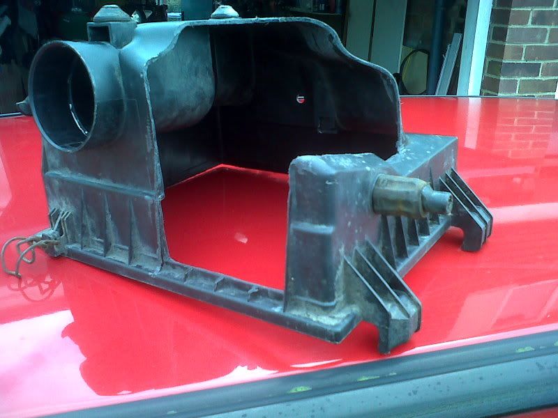

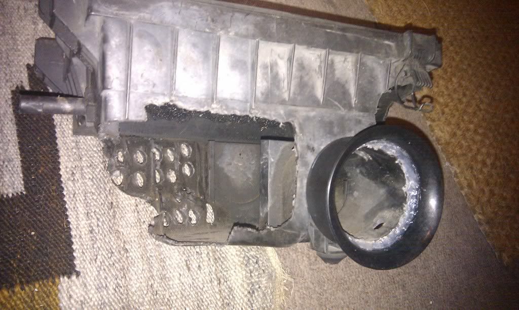

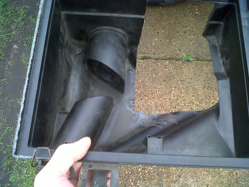

So first of i swiss cheesed my airbox, and found some piping to use as my cold air feed.
On the second photo as you can see i have left the pipes inside should i dremel them out? or will they not make much of a difference?

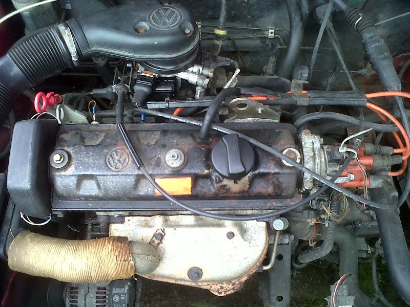

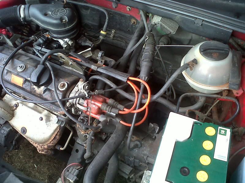

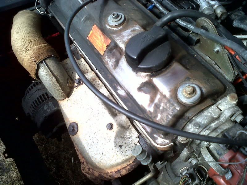

Well now it is running and the only issue i know of is a small leak in the exhaust i thought i would start cleaning up the engine bay  :smiley:
This is what it currently looks like
As you can see it has seen better days so im thinking i might take the cover of tomorrow rub it down and spray it matt black  :smiley:
Started it today but i ran out of time and im going to take it off tomorrow as it will make life so much easier.
Also going to attempt to find all the earth points to clean them up, as suggested by Khare.
Is there any other little jobs that dont cost money but could need regular attention? As im fairly new to cars  :tongue:

Good job on the airbox, looks great.
My advice however would have been to get the bottom of an 8v box (hasn't got the hot air pipe inlet) and do what you did to it. But as you've now done it already then close off the hot air inlet somehow and smooth the top half of the box.

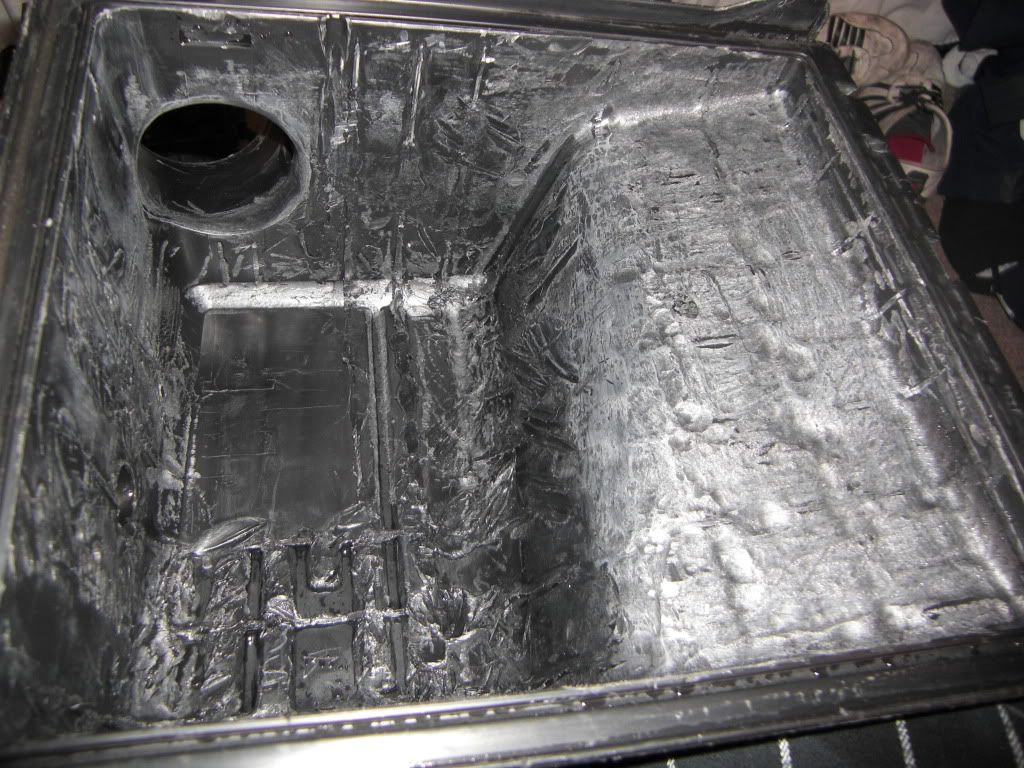

Here's inspiration for you
Looks messy, but it's effective and in real life it doesn't look as messy.
I'd get rid of the hot air pipe as well, does nothing apart from let hot air into the system.

Nice! i picked that bottom half of the airbox up from my local scrappy got it for £2 it was the only golf they had, so i thought just to mess about with id buy it :)
Khare........on the top photo you posted the inlet you have there is that where yur cold air feed goes in or just left open? dunno weather to put the cold feed into the pipe i have or just place it in the hole iv cut out?
Also doing this to my 1.4 will i have any tuning issues or what not? as i know more cold air increases power so do i need to re tune it?
Yeah i shall remove the hot air pipe when i fit the modded box in  :smiley:

No my cold air feed goes on the corner above the velocity stack, you can just about see the cut, below the clip that holds both halves together. You can put it in where the velocity stack is or were you've cut out the section.
No need to retune, ECU will adjust the mixture  :smiley:
