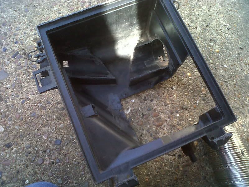

So firstly i took khares advice and did some work on my airbox, i dremeled the hot and cold feed pipes away inside the box, found some nice pipe for a cold air feed so now thats all ready to go in the car looks like this now  :smiley:
Just need to block of the old hot air feed and im sorted  :cool:

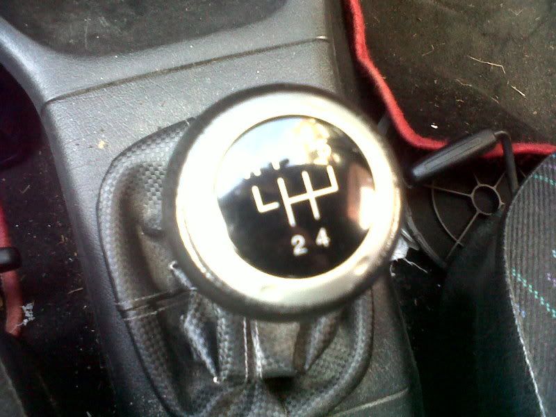

Next my mum comes home and offers to take me to my local scrappy to see if they had any mk3's typically the day we decide to go they have no vw's what so ever so ended up coming out of with only one item that looks like this........
I think it looks a bit better than the old one, just a little touch really  :smiley:

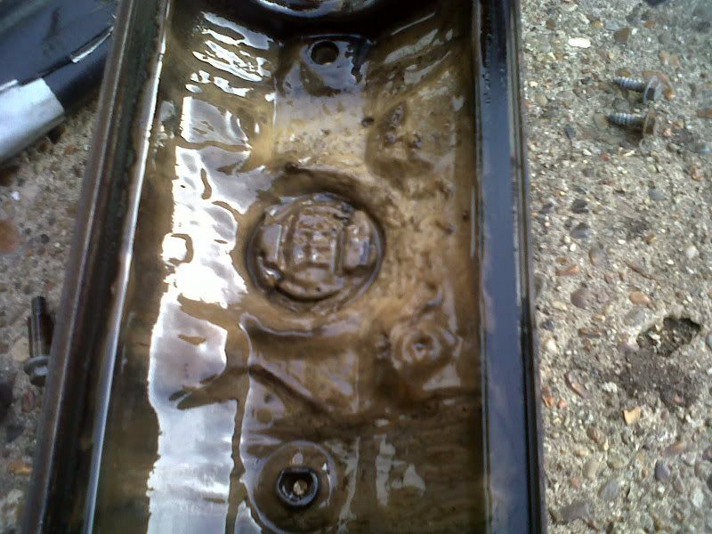

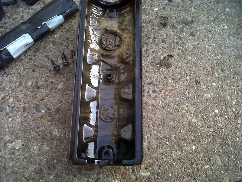

When i got back i decided to take the cam cover of so i could rub it down and spray it when i took it off got a bit of a shock when i turned it over...........
Spoke to my dad about it, he said it could be one of two things, the head gasket is shot allowing water into the oil or as the engine only ever gets started and runs on tick over as i cant goanywhere in it the damp may of just built up and the oil isnt getting hot enough to evaporate the moist so it forms like that, dunno what you guys might think it is any advice would be good?  :smiley:

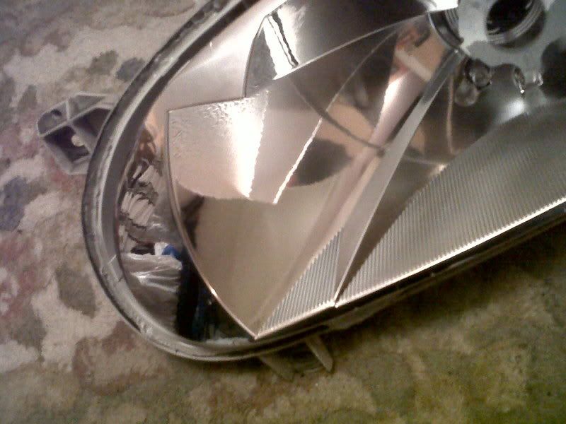

I then took the front grill of to remove the head lights to begin the joey mod, they came of nice and easy, got my mums nice hairdryer and began to warm it up whilst apply pressure with a screw driver and the fronts came of rather easy but then noticed i have a issue, the tutorial i found on the joey mod says paint the rough bits of the inside not the reflective bits (pretty obvious) but anyway everyone elses lights seem to be diffrent to mine because i have reflective bits all over the utside now can i paint them as they arnt angled towards the light or is it my unluckyness to have a set that cant be done i took some photos so you understand what i mean........
If anyone can tell me weather ill be ok to paint the outside or not it would be a great help?  :smiley:

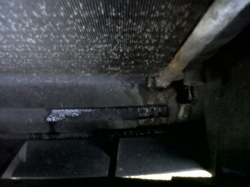

So the last thing i found today was when the grill was off i noticed i had a puddle on the ground and it seems like i have a leak in my radiator  :sad: so thats another job i must do tomorrow, its not bad but i am leaving little puddles where ever i go  :grin:

You would have to declare the engine change in the GTI as a mod, so I expect the insurance premium would be higher than a standard 1.4. Also it would be a major headache, everything is different! The slam panel, rads, gear linkage, loom etc for starters, I expect the driveshafts would need changing, the steering rack, wishbones, exhaust, fuelling system including pump, etc etc. It's just not really worth it to be honest. I considered going the other way putting a gti engine in my 1.4 but it turns out pretty much every part of the car bar the main shell is different (better) in some way on the gti than the CL, hence why I just bought a gti.
In terms of your headlights yours are standard CL ones, I'm not sure if you have noticed GTI ones are different (I didnt spot it for a month or so of ownership of my 1.4 so you may have missed it too). Check Bellends dub rides thread, I noticed he has done the mod you are doing to the CL lights on his, might be worth dropping him a message?
