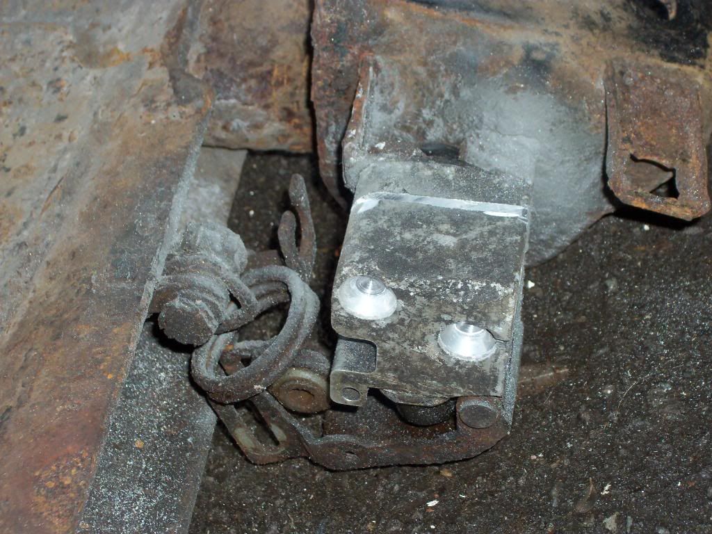

Am I right in thinking Potter is a non ABS model wit the servo and master cylinder on the right side of the 'bay as you look at it? I really want to either delete the ABS or hide it so I can move the master cylinder and servo to the right. that way I can clean up all the heat shielding and the brake lines that go from left to right across the bulkhead! I just don't know weather it would be better to hide or delete the ABS system........ and if I do keep it, where on earth to hide the god aweful, ugly POS lol!

As for the servo master cylinder.Unless it is a LHD it is ALWAYS on the right hand side,its just your abs pump on the left hand side.Me personally i would remove it as its not the best system in the world anyway and mine stops perfectly well up front with the brake upgrade up front.
I will be routing the brake lines in the scuttle panel along with a few other things.

I am inclined to agree with you on the ABS front, the amount of times I hear about the system not working, it might as well just be ripped out lol! As long as the car is still safe to drive by doing so obviously :) I have an inline filler neck to fit instead of fitting a top or side fill rad, I just want to cut out the fan housing and fit two slimline push fans to the front of a VR rad instead, then do a bit of plastic welding and smoothing on the inner face of the slam panel to tidy it up a bit, ie, where the loom goes across the top etc.

Yeah it stops perfectly fine without.Just remember to fit the brake compensator valve on the rear axle so the back end doesnt lock up,but dont forget to adjust the arm on it to take into account the lows or it will think you always have a ton of bricks in the back lol
Is that an aftermarket piece of kit I have to install? I guess the non GTI models don't have them because they have drums at the back?
Offline LowlifeDubber
  • Posts: 1,608
Re: 1993 MK3 Golf(VRT Engine build time!!)
« Reply #678 on: 02 November 2012, 09:30 »
No its an oe bit of kit that is fitted to non abs models regardless of trim level :)
http://i281.photobucket.com/albums/kk206/deliverance70/golf/100_0210.jpg
Theres some pics of mine and the fitment somewhere in this thread page ten and back i do believe :)

Ah cool. So will the fittings be there to convert my rear beam already?
