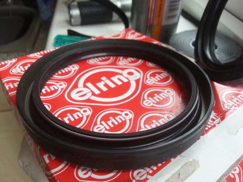

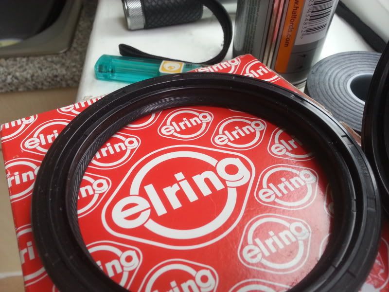

Offline leigh_harty
  • Posts: 1,462
  • Audi AGU
Re: 1993 MK3 Golf(VRT Engine build time!!)
« Reply #654 on: 27 September 2012, 17:29 »
these are them, sorry for the delay. still yours if you want them  :smiley:
Dont lose your dinosaur!
